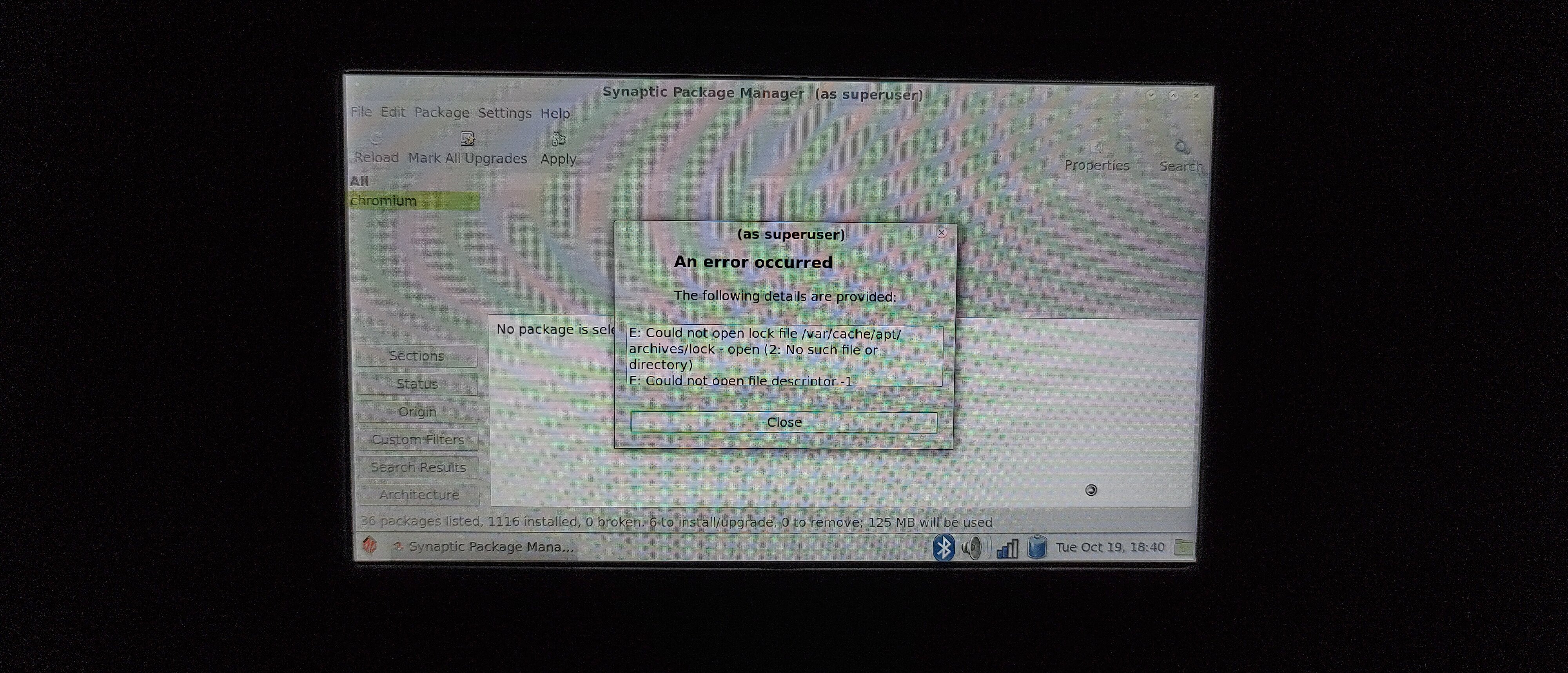

I try to install chromium i mark it and i apply dependencies. Here is the error why?
Hmm, that's weird. I'd suggest you check if what it claims about that file is true or not. I might personally expect the lock file not to exist when the repo is unlocked, and only appear when it is locked. Maybe the problem is it's unable to create the lock, and then it actually fails in trying to read it back.

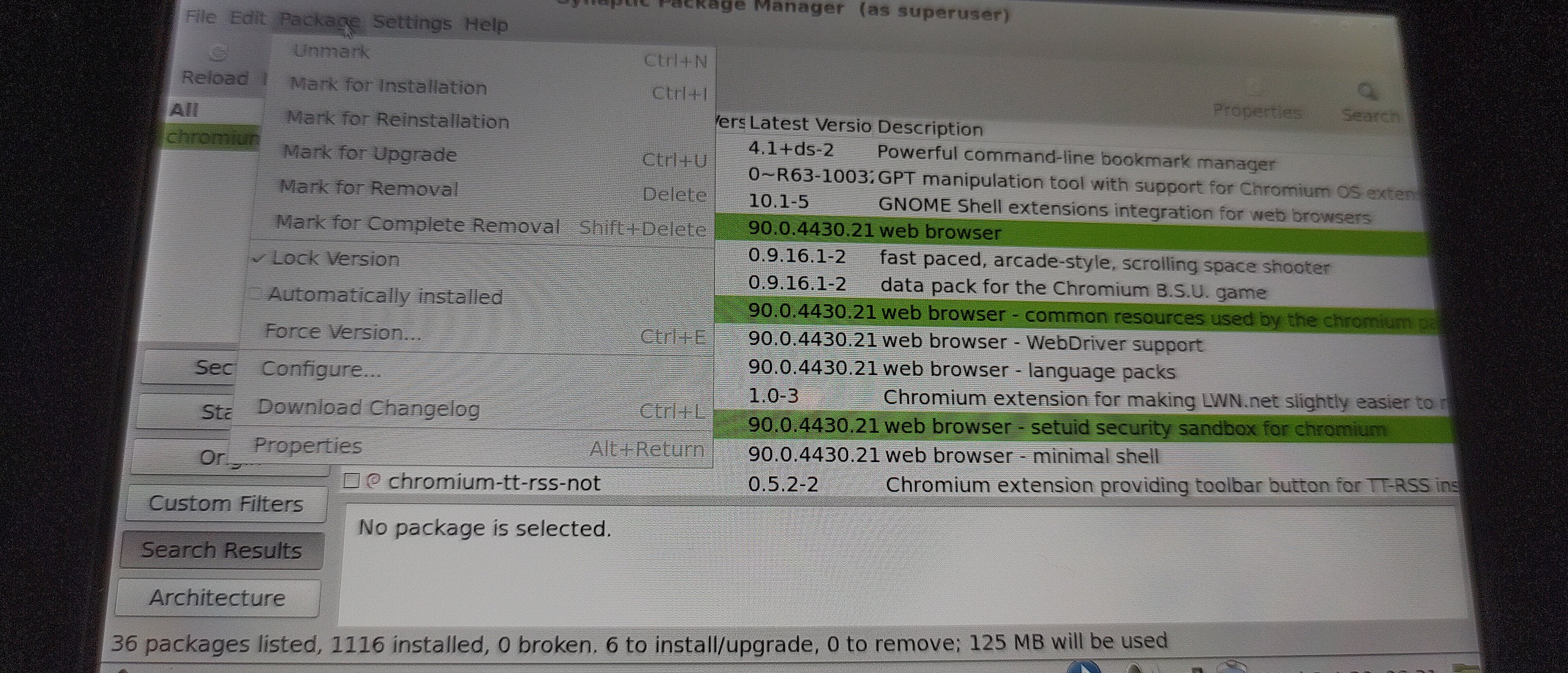

How to lock and unlock the repo?
Edit:
Package - Lock

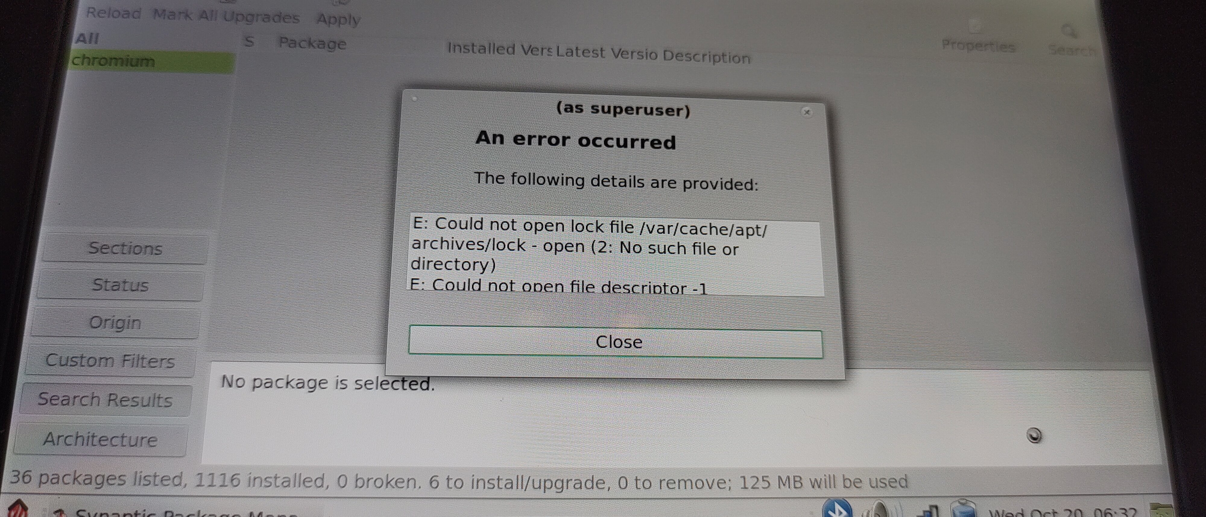

I try like on picture i try to install clicking on apply without luck same problem. How to resolve problem?

Maybe you should try this command line to make sure everything is up-to date so you can go on with Synaptic :
I'm not sure what dist-upgrade does if you're already on the latest stable debian, but I'd advise you to use plain apt upgrade in normal use and only use dist-upgrade when you mean to.
Try going to the console and become root, then:
Code:
D=/var/cache/apt/archives ; mkdir -p $D ; chmod 777 $D
maybe the directory to create a lock file does not exist? (or maybe it DOES exist but there is too few rights to create a lock file there? (That's what the chmod does)
It work now. Thank you. Chromium installed.

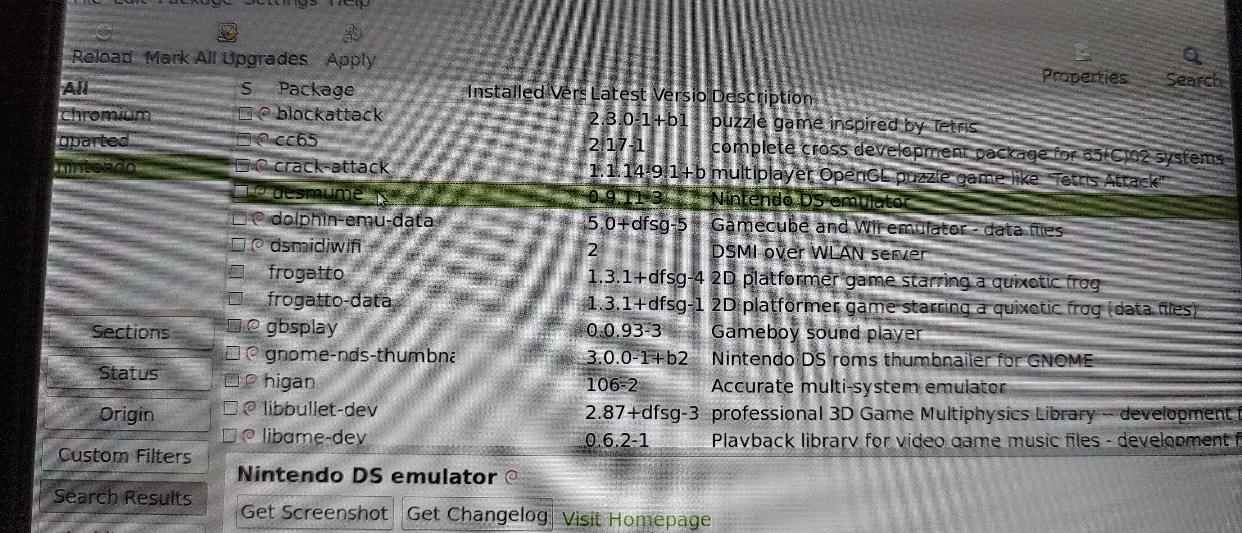

Anybody try desmume or dolphin emu on Pyra?
You think it will work at full speed?

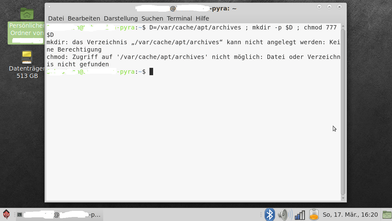

Sorry for asking the same question again. But I have the same problem as trevormarco. So I started the terminal (I tried "XTerm" and the MATE-Terminal) but I can not enter the USR password....(I type on the keyboard but nothing happens) What can I do?
I can type in the "sudo apt update && sudo apt dist-upgrade" then the terminal says (in German):
"Wir gehen davon aus, dass der lokale Systemadministrator Ihnen die Regeln erklärt hat. Normalerweise läuft es auf drei Regeln hinaus:
#1) Respektieren Sie die Privatsphäre anderer.
#2) Denken Sie nach, bevor Sie tippen.
#3) Mit großer Macht kommt große Verantwortung.
[sudo] Passwort für USR*: "
*instead of USR there is my real Username
If I try to enter "D=/var/cache/apt/archives ; mkdir -p $D ; chmod 777 $D"
It is not working because of USR rights (see attached picture).... How do I become root?
Sorry for the questions I am not used to linux.

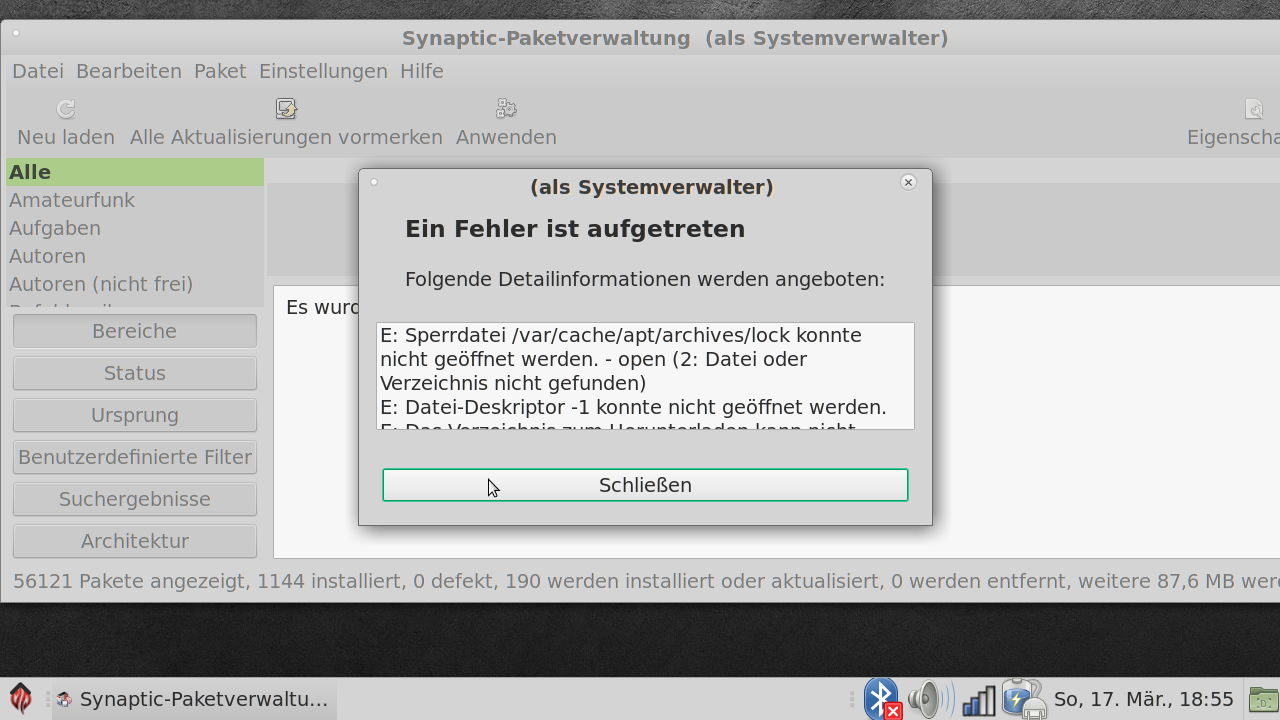

Also genau wie trevormacro kann ich im Paketmanager keine Programme installieren und bekomme so ne Aussagen wie (siehe Bilder - bei ihm war es auch so siehe das zweite Bild im Posting #6). Daher habe ich die Befehle in der Konsole ausprobiert. Aber bei meiner Pyra tut sich nix. Ich kann kein Update machen und keinen Browser installieren etc..
