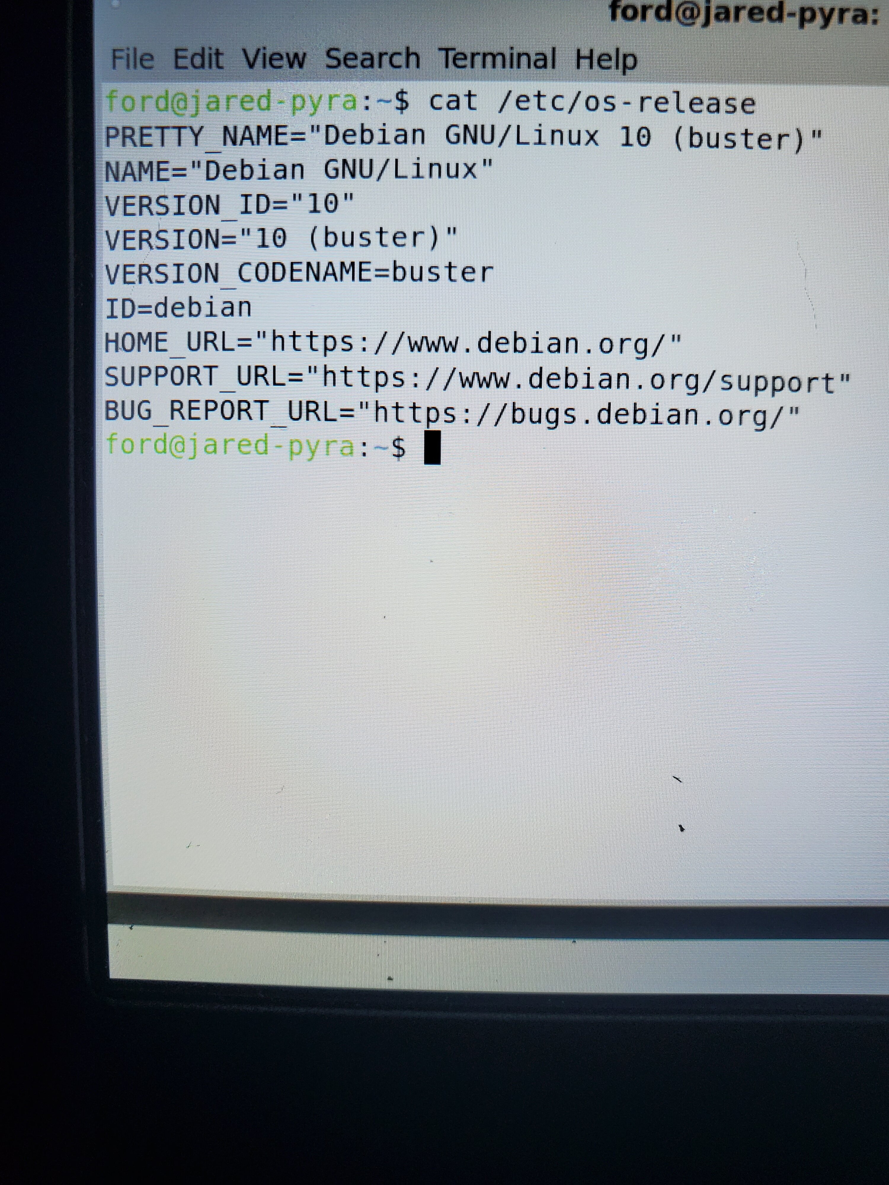

That got me the menu,thank you! I was able to add the network but now it says it isn't active. I'm using Buster, but I might reflash it with the latest 42 distribution, just to see if that makes things work better in general. I'm used to using raspberry pi OS, but the Pyra is really cool so far, just need to figure it out. The next step is figuring out the best Amiga emulator for it, FS-UAE, unless there's a Pyra specific build somewhere? I was mostly looking at debian 10 applications.

FS-UAE should be just available for armhf off the regular Debian repository, not sure on performance though. In the past the best arm based Amiga emulator was UAE4ALL, but it would likely have to be ported to the Pyra specifically.
