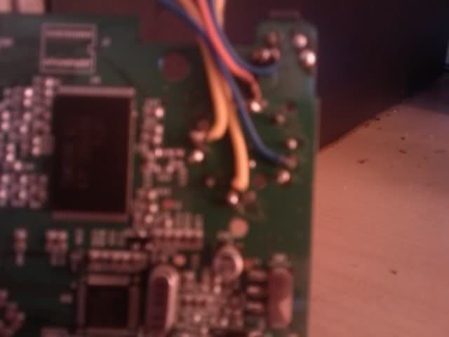

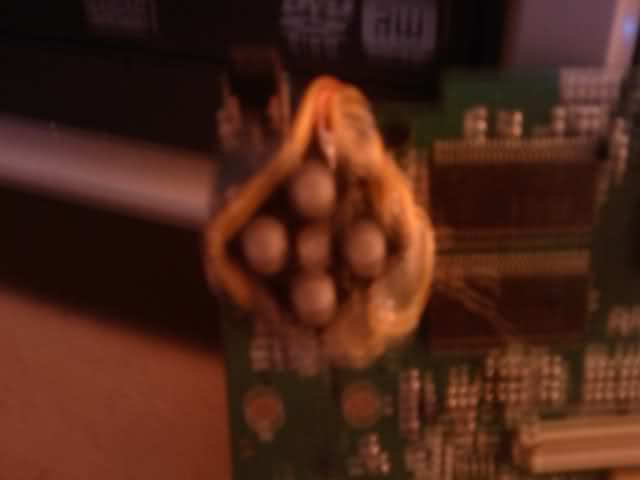

Opened up the GP2x - I believe I can fix in a second PSP battery in the recess, to double the amperage and make the GP2x last longer on its playtime.

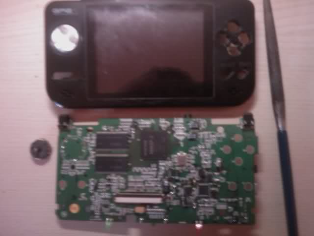

Also, fixed one small issue with the d-pad, you could press all four directions at the same time in error, not good in action/reflex games. Fixed it now so the d-pad works in the usual 4 directions and also diagonals, just as it should - you can't press 3 or 4 directions at the same time. This was achieved with a small bead behind the d-pad center, and some light dremelling of it, to work precisely. Aiming to hopefully rig the second battery up tomorrow morning.

Update - installed second PSP battery and wired it up. It is a really tight fit but the case will close, just. Decided to give the case backing another respray to make it look lovely. Also decided rather than the "bland" edges and shoulder buttons to use the silver ones from the other GP2x I have, to give a black and silver contrast - looks nice.
Realistically, going to give the case 2-3 days to dry properly and cure. Was going to make a video clip of the last part (ie two PSP cells) however not a great deal to show so won't. Also, secured the battery compartment in place permanently as made a hole for the recharge jack instead.

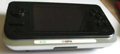

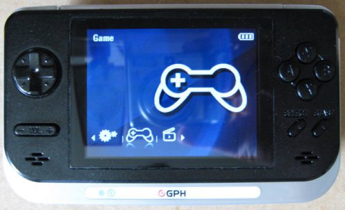

GP2x is dried, looking lovely in its two tone colour scheme (silver and black). Closed the case up, barely but did close ok; booted up, fine. Had a far better game on Gradius 3 on the SNES than before – the d-pad works great.
So, two pics – one of finished system, and the other the GP2x logo i’ll be putting onto the back of the cover.
Now I need to see how long it lasts with the two sets of PSP batteries installed. Whatever the result, is the best I can make it. Going to leave the GP2x on this afternoon on Gradius 3 on the SNES in demo mode (at 200mhz) and see how long it lasts.

Pic of system (silver and black finish):
D-pad modded; 4 hour 10 mins playtime on 200mhz game; 4 hours to recharge from flat.

I should have retained the one from the back of the d-pad, however as had filed it off, I hotglued a tiny plastic bead into place, and then very gently sanded down a bit here and a bit there with a sanding drum on a Dremel, until I had it "just right"; ie all 4 directions registered fine, and also the diagonals too; not too much, otherwise you could press for 3 or 4 at the same time. The result was a good pivot, which as you see in the Gradius 3 game demo, allowed all diagonals and the normal up, down, left, right easily.
One thing I did think of was having a circle for a d-pad instead of a cross - far easier to mount into a system and also easier to get diagonals of course, which is ideal, although there will be occasions where your finger strays a little off the 4 directions into the middle area and thereby can cause a diagonal as that will depress the d-pad in that way: just a small point - ie, keep your finger off the middle bit ideally. Larger d-pads don't have that issue.

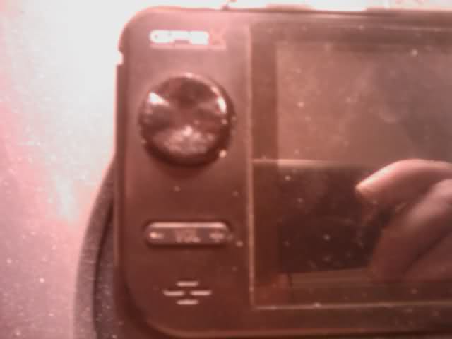

Used a file to make the hole for the N-Gage D pad
Followed Bacterias diagram
Got 4 rubber topped tact switches from E bay and used a blob of hot glue for the center pivot
Painted the D pad black put it all back together and it works perfect
Thanks Bacteria

My pleasure - I said it was a simple mod! :D I'm pleased someone is trying it out!
When you close the case up, experiment to gauge the tiny trimmings here and there you need to make to the shaft on the back of the d-pad so it pivots nicely on the rubber pads so you get diagonals and the directions too, easily. If you haven't got a pivot, hot glue a small plastic bead in place and Dremel it into the right shape, size and height for the job.

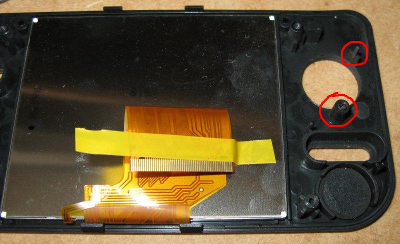

I have no dremel, and not really sure how to cut out the hole in the case. Also some of the plastic around the hole gets in the way for my d-pad. Hope you don't mind me borrowing your picture to show, can I safely remove these parts?
Rubber contacts for the d-pad. I have none except for the rubber mat (picture found from google, NOT mine!) from the game boy color circuit board. But I can't solder on that so.. What to do?
