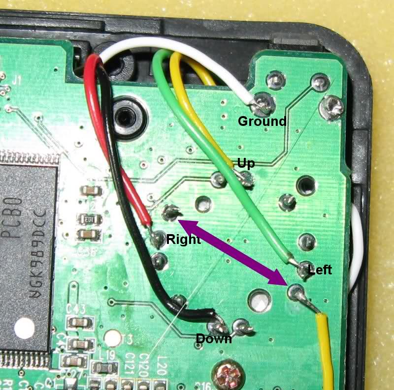

Ok guys - help needed please!

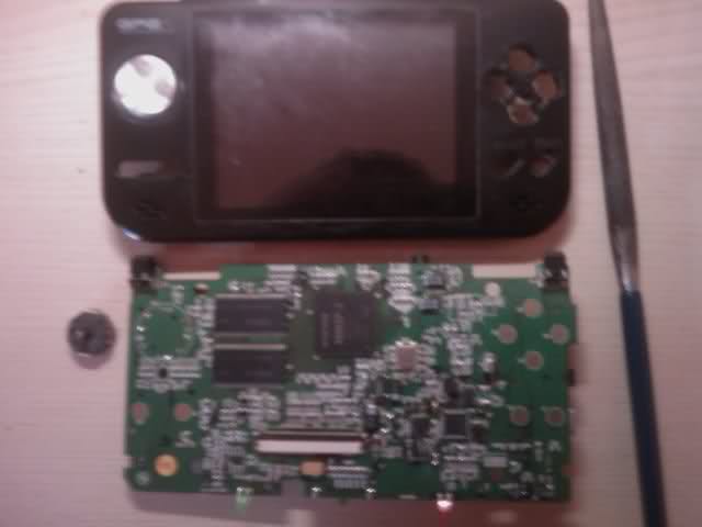

Got the d-pad working beautifully, tested in T-mode lovely!
The problem is that the center click doesn't work. I've got a GP2x-F100( B ) model, and have checked and double checked to confirm the two pins responsible for center click, as marked by the purple arrow in the pic below.
Problem is, as you can see, the top of those two connections (marked on the pic with the arrows) is connected to ground (you can see that if you look closely), which it isn't on the joystick. I have sanded down the reverse side of the board and confirmed that the only way the pin is connected to ground is on the back of the board.
This seems to indicate that this GP2x doesn't use the center click function, as whatever I press in T-mode doesn't give a center click result - the center click does not use grounding to work.
So guys, am I missing something, or did this version of GP2x not have a working center click? I tried pressing both volume buttons to get center click, in case it does that like on the F200, but made not difference.
Ideas? At the moment, looks like this GP2x can't run with a center click feature! (didn't check to see if it did before, not used the GP2x for ages). Also, and relevantly, do the GP2x emulators use or need to use the center button (older emulators did)? What if any restrictions are there with no center click?

Those wires look a bit thick will the shoulder button miss them i think i will use some ribbon cable ;)
I have a f100B and the stick click does work but i have never had to use it in any of the emulators.
Wires are just under 1mm thick, and flexible. Works fine.
If emulators don't need center click, there is no issue?
Can't work out why the function doesn't work though!
Looking on the Wiki HERE it doesn't look like the center button is used at all - is this right, what is it useful for?
Excellent, thanks for the confirmation. There was no reason on the board it wouldn't do the center push facility; as it is confirmed from the above, and the Wiki on emulators for the GP2x, that it isn't needed, I won't be concerned! (spent most of the afternoon trying to resolve the issue!).

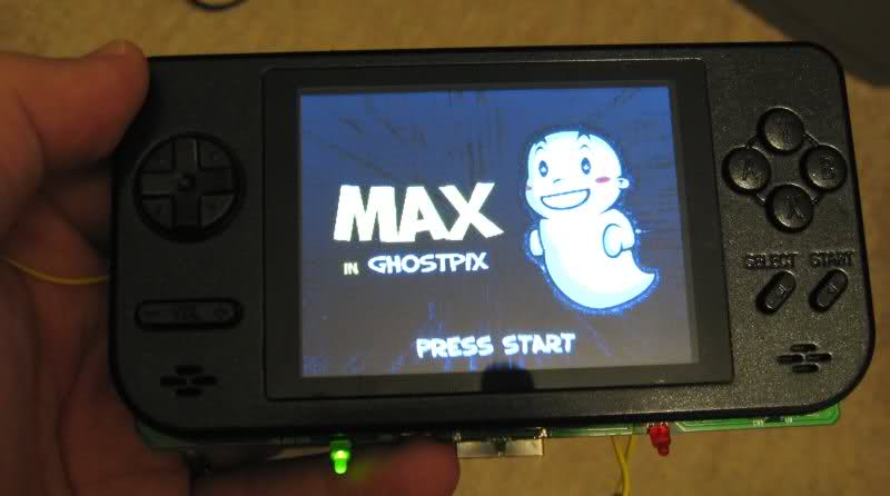

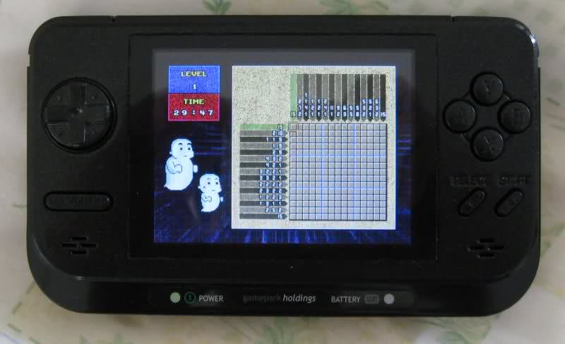

BTW - here's the pic so far of the front (finished):
Just need to put a PSP Li-ion battery in the back and do the case backing now.

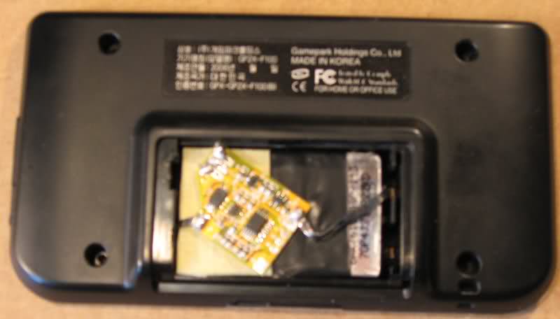

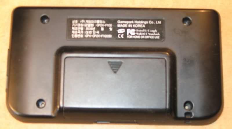

Made a great discovery - added this in a short video clip to the video i'm compiling, however showing this in pic form here too:
We all know the battery life from two AA NiMH cells sucks on the GP2x.
I bought a PSP battery for my PSP a while back and being a Chinese rip-off it didn't work; the battery is good but clearly Sony have built in some software to detect on their PSP3000 model that the battery is no a genuine Sony one, so won't work with it.
The battery is a 3.6 amp Li-ion battery at 3.7v, so lasts well on the GP2x, not sure how long, but I read somewhere someone was claiming about 10 hours between charges?
Anyway, open the battery up by removing the plastic casing, move the battery protection circuit board a bit so it doesn't overhang the battery, remove the metal battery tabs from inside the GP2x case backing; you will see, the battery sits in place of the two AA cells space: and the lid shuts! All that is needed therefore is a small female plug to connect to an external battery charger! No more modding needed!
Great discovery, yes?

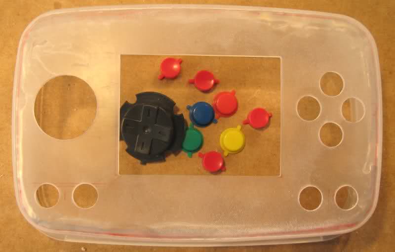

Made casing for project #2... will spray paint this and start to fill it with the other GP2x system (remember, I said I was doing two GP2x projects?). Going to leave the second one to the end though to reveal it fully...
1 litre tupperware boxes, bottom cut out, 2mm perspex cut and hot glued to replace it, sanded very smooth against the side of the case, bondo filler used, electrically sanded very smooth, buttons and screen cutout - took only two and a half hours of quick labour. The 1 litre case is just a little bigger than the GP2x case, and allows me to put in larger buttons and space them better...

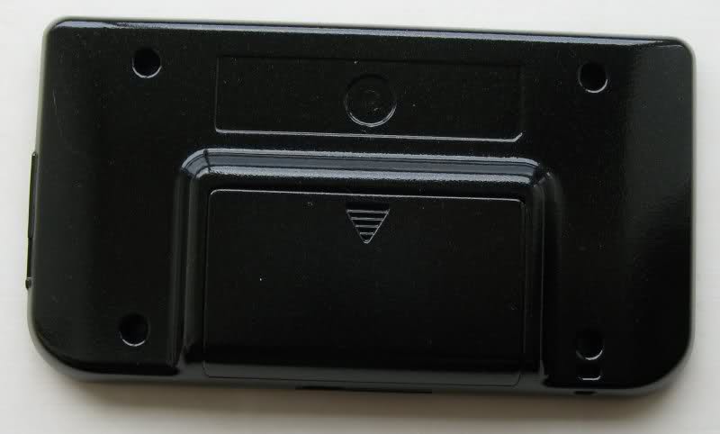

Case backing for #1 is dry and looks lovely. It is spray painted in metallic black.
I will mention one exclusive - the tupperware GP2x will not be done in just black or my normal red and black - going to use metallic purple for the case and metallic black for the buttons.
BTW - metallic spray paint is fantastic stuff - doesn't wear off things like buttons like it can with normal spray paint, and dries far quicker. You need to use a metallic spray paint sealer of course, which acts like a varnish.

Before you spray paint the multi-coloured buttons on #2, can you show us them as they are now in a built version? I like the idea of multi-coloured buttons in a GP2X. :)
The buttons and d-pad are as per the pic in previous post (post #29). I think having all those colours will make it look "kiddie toy", rather than the aim to make it look fairly professional.

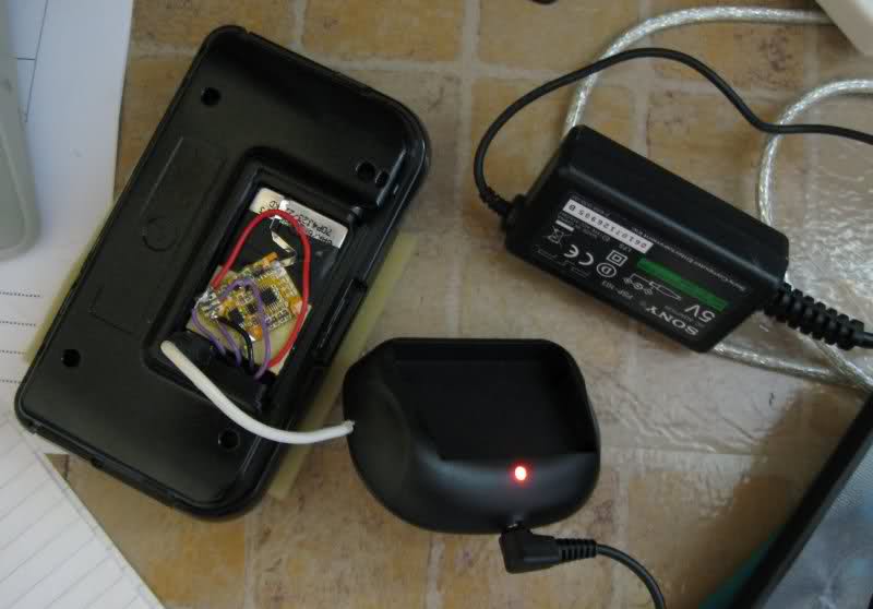

On a different note, FINISHED the GP2x project (project #1) it now has a proper d-pad and Li-ion cell. Had no-where to put a stereo jack (using one for the external charger, had to trim inside the battery compartmnent to make space - took the afternoon to do that. Anyway, got lots of pics and video clips, going to have to pick what I want, edit, etc. I want to see how long the battery will last, charged, so charging the cell at the moment (I also want to know how long it lasts for the last video clip too).
I'm making the build process and documentation all on the video, however having to use some stills with wording on, to explain the latter stages.
Yes, used a PSP charger (well is it a PSP battery), modded the charger a bit so the charger can still be used to charge a proper PSP battery too. The charger unit is designed to take power input from a PSP wall power adaptor (5v) so that is connected too. The reason I used a stereo jack for recharging a battery is that the battery has three contacts on it, one for positive, one for negative, and the middle one presumably for recharge status. A stereo jack has three connections too.
When the system is being used, the original battery cover is on, it has to be off though for the recharge jack to be used - although, I might make a hole in the backing piece and leave the backing closed...
Needs a bit of a dust, etc, but:
Intention will be to sell this unit as mentioned before; when the video is done, done games testing, etc.
