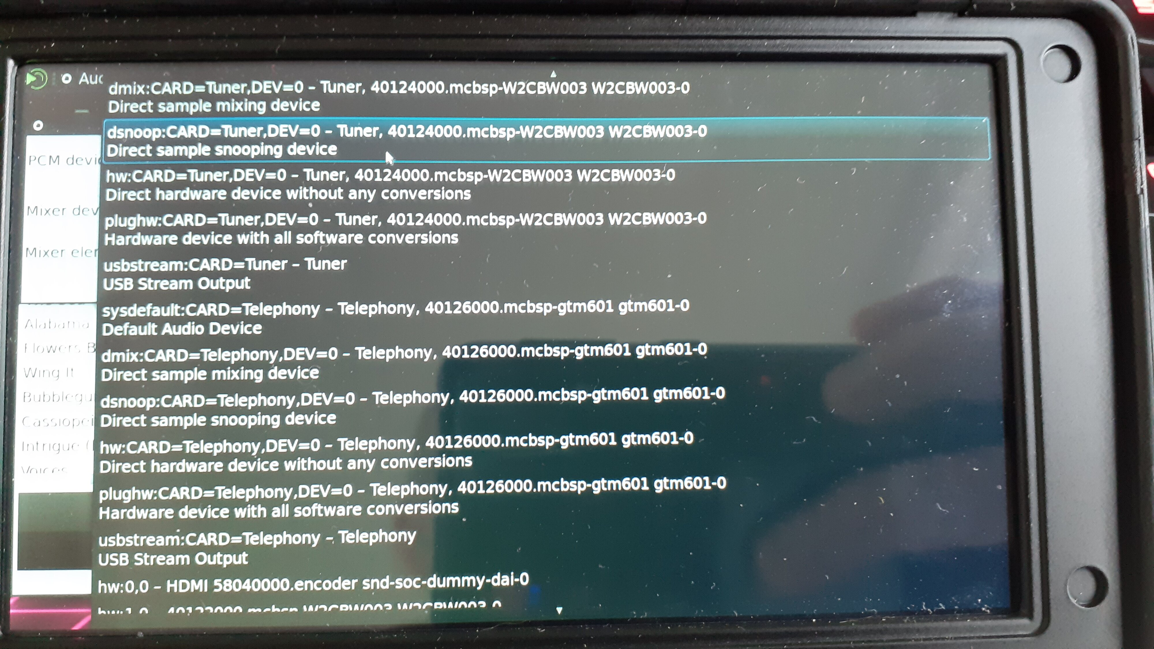

I think obsolete stuff like this should be broken out of the audio driver imo,also the amount of audio devices to choose from is just a bit too much. To me it's unclear what is/does what...
In the picture a small part of the whole list...
Presumably the telephony parts are modem voice coils, and the HDMI parts are for HDMI audio out. I'm not sure what the card parts are.
