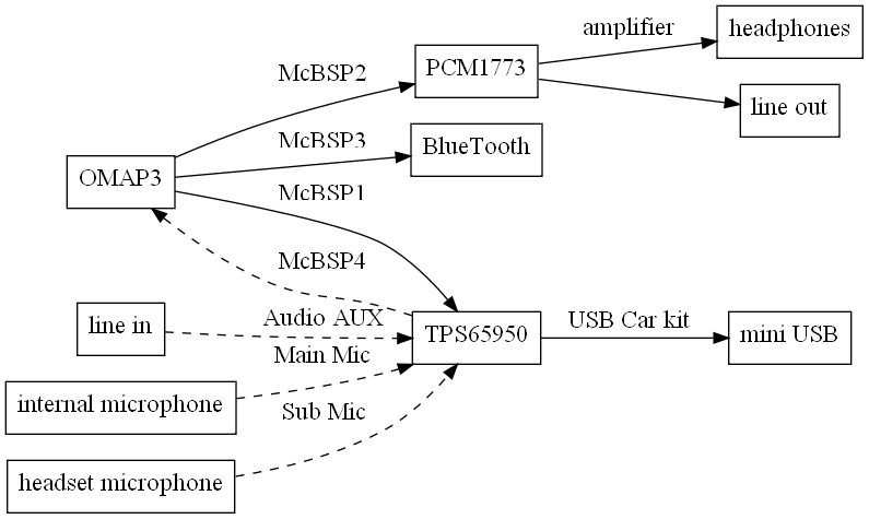

MWeston said:I'm not completely sure of the input specs through this chip. All the datasheets and the TRM has finally become public so you can have a look for yourself: <a href="http://focus.ti.com/docs/prod/folders/print/tps65950.html" target="_blank">http://focus.ti.com/docs/prod/folders/print/tps65950.html</a>
That is the catalog replacement for the TWL4030 (like the 3530 is the replacement for the 3430).
I had asked Squidge to investigate this setup many months ago, but I don't think anything ever came of that. I see 8 or 16KHz sample rates selectable for voice, but that is for the dedicated voice channel to Bluetooth which is not used on Pandora. Audio to the Bluetooth chip comes from the OMAP chip directly over I2S which has much better sound quality options. I don't feel these low sample rate options apply to Pandora (see page 684 of swcu050b.pdf).
I see that the microphones and line inputs can be muxed over to the internal ADCs that connect to the main I2S interface back to the OMAP chip. This supports 13-16 bit data (I can't find a specific reference to quantization anywhere except 16-bit listed on the website so that's what I will go with) and up to 48KHz sample rates (96KHz is the max when transmitting audio only so doesn't apply here). I am assuming that this path can be used to get the best audio back to the processor. In fact, I felt confident that this is how it works when I laid out the design. I just need someone to actually test it.![]()
MWeston said:Internal microphone - TPS65950, MAIN MICurjaman said:To MWeston - can you say what audio pin's on the TWL are used for pandora's audio IOs?
External microphone (on headphone connector) - TPS65950, SUB MIC
Line Inputs - TPS65950, AUX INPUTS (shared with mics inside TPS65950 so you can set muxes to use one line and one mic channel if you want)
Line Outputs - PCM1773, line level output shared between headphone amp and EXT connector, no volume control (2.15Vpp output, 10K load)
Audio inputs use McBSP4 and audio outputs use McBSP2 so they can run simultaneously with different audio on them. BT is on McBSP3 for reference.
The audio output of the TPS65950 is not connected on the PCB but I read in the TRM it might be possible to route it out of the USB OTG port for four channel audio (six channel if you stream over BT too). That might take some clever coding to hack into the kernel, but neat if it works some day. I could be wrong about it working like this, but I found information in that carkit section for USB.

Yep, that quite easy, why I don't this earlier !?mali said:It would be cool if you could make an English version of that diagram, so that we can put it in the photobucket![]()
