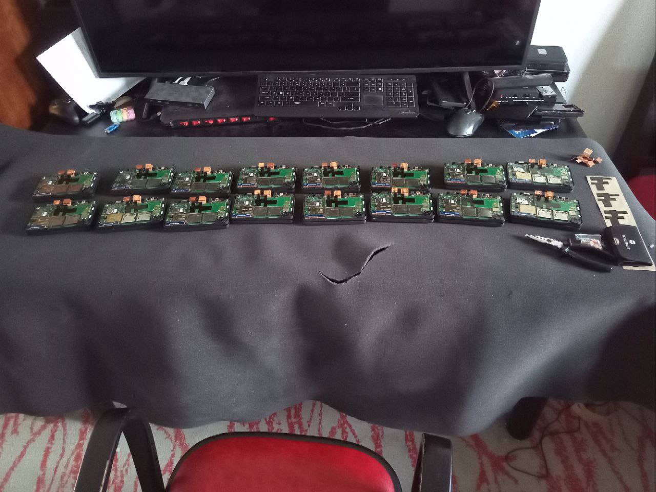

Today is hardware day once more. The plan is to put all the remaining EU LTE mainboards into black housings and build as many EU Pyras as I have mainboards for.
There are still a few open orders from several months ago caused by a shortage of black housings.
Some teaster
