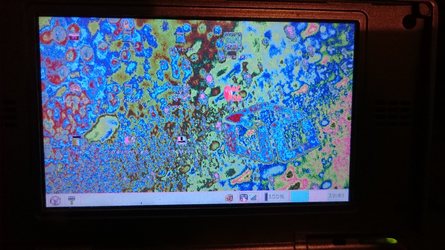

@notaz : sorry to bother you, but I do have an issue. When closing the lid, I have set my Pandora to just turn off the screen. Now with 1.75 (upgrade with OS upgrade, not flashing), I get a garbled screen (see attached screenshot). To go back to normal, I need to launch certain game that will, at exit, make the screen normal (like EasyRPGPlayer, the game launch garbled too, but everything goes back to normal once I exit). Maybe it's a left over of some previous experiment I have done (to have 32bits GLES output for example), but I don't want to flash.. Do you have so hint on where I should look?

Hmm haven't seen that so not really. Maybe your /etc/pandora/conf/dssgamma.state or /etc/pandora/conf/gamma.state is messed up? Or maybe bad timings in /usr/pandora/scripts/op_lcdrate.sh? You can get the roofs from http://openpandora.org/firmware/images to compare.

Had this happen to me today, cannot reproduce but next time it happens I'll take care to remember circumstances to be more help.

PCSX ReARMed (with Aludra) can trigger that reliable. Just close the lid ingame, open it and the colors are fascinating off. Screen reset is thankfully easy too, just open and then exit the menu.
Thanks to this easy reproducer I've found the bug - the new power saving thing (off mode) was losing the gamma table. This is perfectly normal as the off mode loses all the state, and the driver already handles it properly by restoring all the registers, but for gamma table it's a bit different, you have to ask the hardware to fetch it from RAM, and this is what the driver was missing. I've pushed a kernel update for this, not sure if I should rebuild the image again, maybe I'll wait again for something else to pop up...
