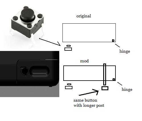

here is my idea for L2 and R2 it would work fine and only put a small hole in the case
sorry for the crude drawings done fast at work
edit: improved drawing
that's a great idea, i was thinking of something along those lines too, but i think it might be better if instead of drilling a small hole and having a very delicate post sticking through to act as an L2 and R2 button, i'd probably just saw each shoulder piece in half, that way when i put the two half's back on the post that they rotate on, they can rotate independently from each other, then i'd just mod in another button on the inside and wire it to the L2 R2 ports on the moboard.
Pimpin idea, only practical/possible one I see yet
I thought of something similar, moving the hinge to the middle, giving you a +/- volume like button.
