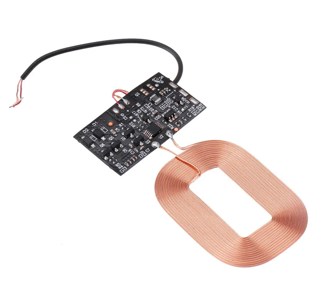

How bout to build a Wireless Charger Foil under the Battery and directly connect it to the Battery?
Then you can charge the Pyra wireless and the Ports are not so stressed over the Time.
And you can charge the Pyra Battery while she is realy off then :)..like an external Charger but internal.

I was thinking about throwing two wires from the battery contacts of Pyra and routing them to a barrel connector, installed somewhere on the Pyra case. But this will require either carrying a special charger with me, or integrating a separate charging circuit - and there is not that much space for it.
Wireless charging coil will also need a special circuit to be placed somewhere.

You need more Place for a Charging Controller for Wireless Charging?
Maybe i do have here a nice Idea for you.
You can get more place when you build in a Pandora Battery and she have 4000mah which is good too.
I got a Pyra Battery loong Time ago from EvilDragon and he said with little Case Modifications the 6000mah Pyra Battery should fit in a Pandora.
Its only the opposite Way to build a Pandora Battery inside the Pyra:)

By the way, that's one of the next tests I plan - hook up a 18650 battery and check, whether Pyra will charge it. I am still not sure about the possibility of the current battery to cause all these issues. But I need @ouzle assistance for this - most likely we need to trick the Pyra battery temperature sensor. In theory if it works we can have a holder for like eight fast swappable 18650 batteries underneath Pyra for ultimate autonomy.
I will also dig QI receiver circuits - maybe something will fit inside even in the current configuration.
