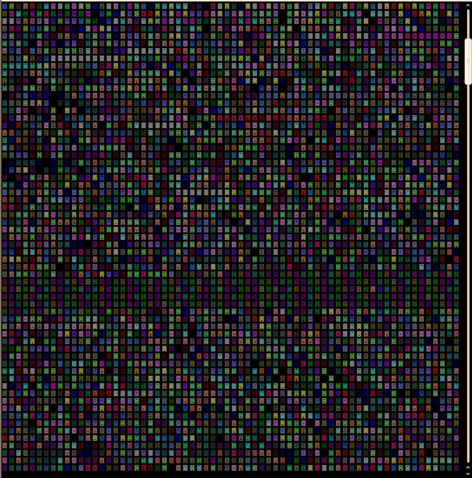

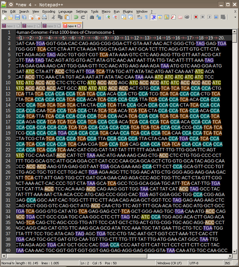

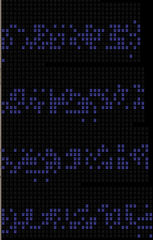

This is a weird one: ways to view DNA. So using my perl-fu, i converted a codon (3 letter DNA) into a single character.
While doing that I found out that it is contested that Iching is constructed bottom up, not top down and that, potentially, the UNICODE Table is wrong.
I also copied the homework of https://octomatics.org/ and made (deca)hexomatics, where each line downwards means it's a Purine (A/G) else it's a Pyrimidine (T, C, and U)
Code:
T C C   = 000101 [05] = ䷣ = ╶┴╯ Serine           36 Censorship
A A G   = 111110 [62] = ䷫ = ├┼╮ Lysine           44 Temptation
G A G   = 101110 [46] = ䷱ = ╭┼╮ Glutaminezuur    50 CosmicOrder
G G G   = 101010 [42] = ䷿ = ╭┬╮ Glycine          64 Before the End
T T T   = 000000 [00] = ䷁ = ╶─╴ Fenylalanine     02 Receptive
G C A   = 100111 [39] = ䷙ = ╭┴┤ Alanine          26 Potential Energy
C C T   = 010100 [20] = ䷦ = ╰┴╴ Proline          39 Obstacles
T A C   = 001101 [13] = ䷶ = ╶┼╯ Tyrosine         55 Zenith
These are the stop-codons, oor scissors, I was hoping that ╶┼┤would be used the most, but alas (still only the first 1000 letters)
Code:
T A A = 001111 [15]  = ䷡ = ╶┼┤ /Ochre  (254 times)
T A G = 001110 [14]  = ䷟ = ╶┼╮ /Amber  (174 times)
T G A = 001011 [11]  = ䷵ = ╶┬┤ /Opal   (387 times)
Long story short: Have you had those games on tapes that went piiiiii kshrfgasf piiiiii kfasfaasfvvaghgjkgkgk... well, it just like these anomalies in the first 1000 characters of the first gen (need to make a full picture of that, not included).
Long term I want to look into stenography inside DNA (the reason why 4 codons only code a single animoacid, and why the disparate frequencies). I'm a programmer, not a biologist, so my angle is different, as you can see.

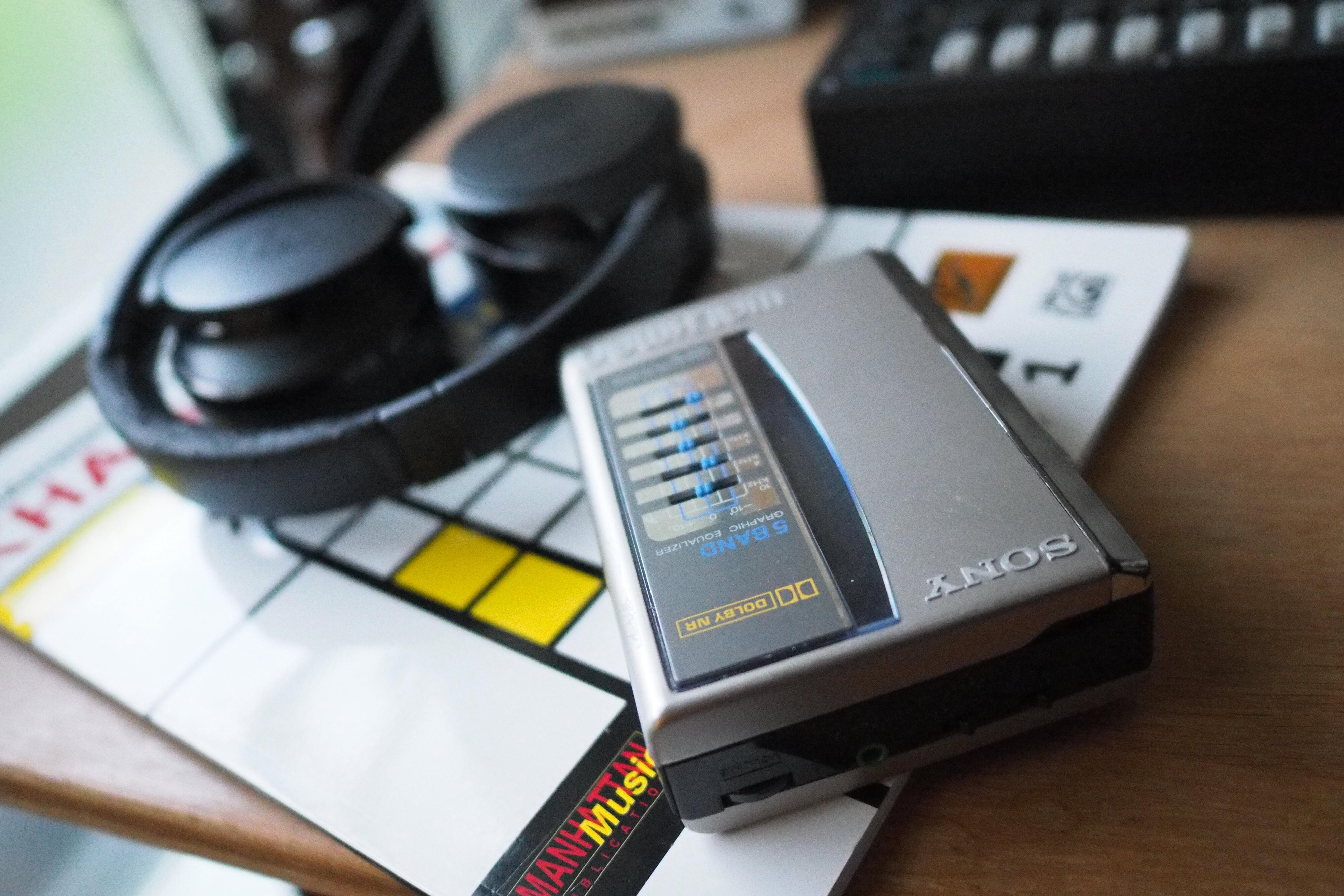

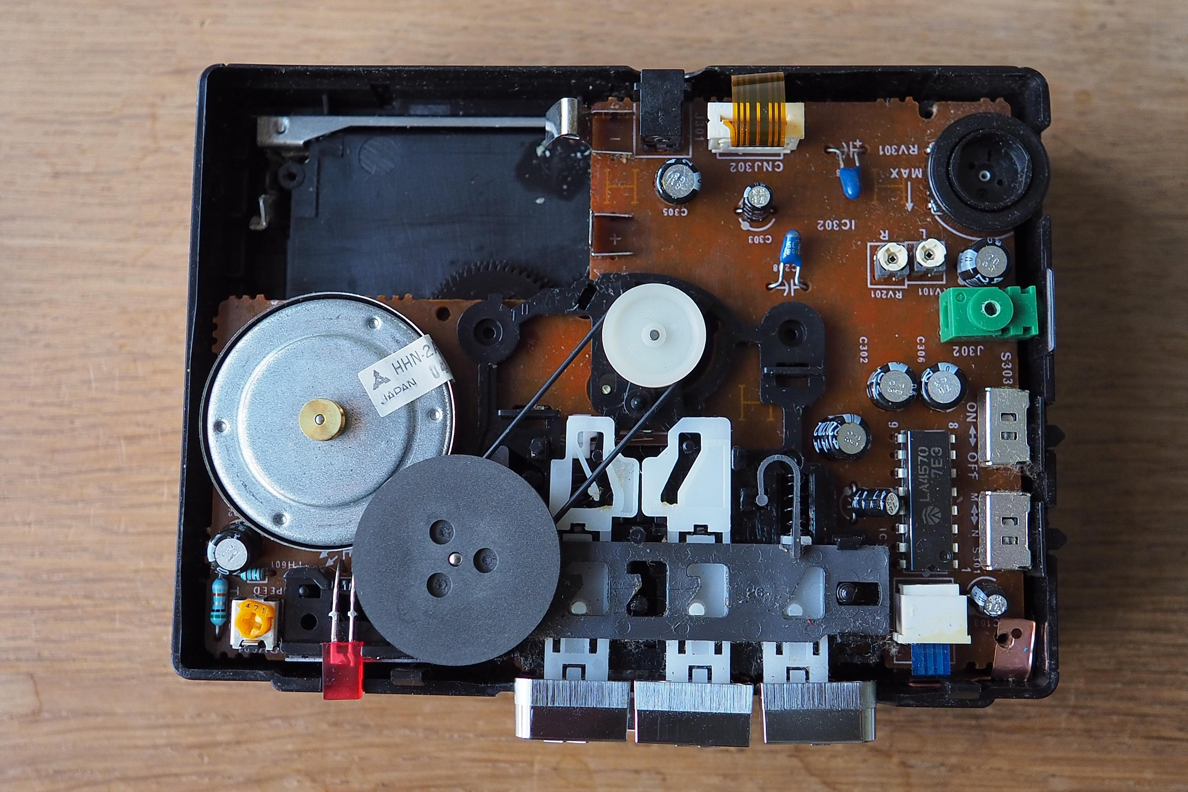

I fixed my walkman wm-36. Replaced two belts and now it's better than ever, the warble is gone and fast forward is faster! Amazed at how easy it was to repair. Dunno why.
It's the best walkman ever btw. because of the eq. i got mine for £29.

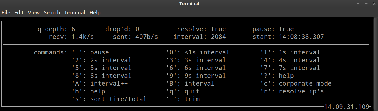

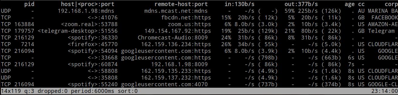

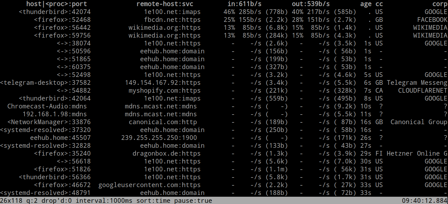

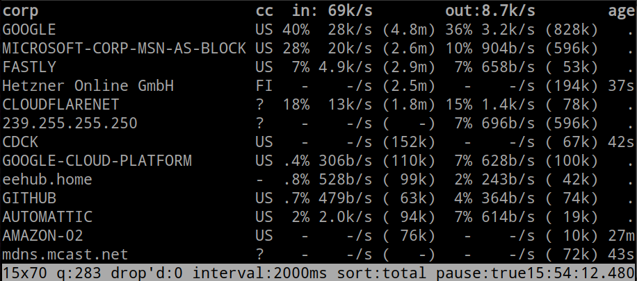

I rewrote my stream oriented network monitor pacmon in rust. It shows you which corporations and countries your processes are communicating with along with other stats. Check it out. Your data might be going to Pyongyang (like mine was)
The idea behind pacmon is to be like top, ordering streams by (a) recent activity (aka current speed) or (b) total bytes transferred. Then update periodically eg every 3 seconds so the stats are more stable. But if you set the refresh interval to something quick like 200ms you get an interesting realtime timeline of network activity trickling in. It's like human readable and digested tcpdump output. It's crazy how much my computer talks to google and facebook (which I don't use).
I'm surprised I have never heard of anyone else being interested in which corporations your devices are talking to. Pretty basic privacy ask. I think I'll add another mode that aggregates by "corp".
Now if you press 'c' you enter corporate mode which aggregates network stats by corporation.
You may know what Hertzner Online GmbH is pyra-handheld.com's hosting service and are wondering why it's allegedly located in Finland. I don't know if it's true but I double checked with ip geolocation and it says the same thing.
