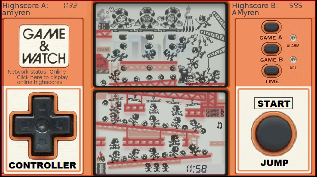

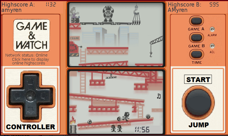

That is strange. It still never finish to build the pnd here.
I am using this cmd line:
/usr/pandora/scripts/pnd_make.sh -d /media/mmcblk0p1/Downloads/dkzip -p /tmp/dk.pnd -i /media/mmcblk0p1/Downloads/dkzip/icon.png -x
In the dkzip folder I have the following files:
DonkeyKong_Linux_x86
box86t
PMXL.xml (copied from the deltarune pnd and edited)
runscript.sh (copied from the deltarune pnd and edited)
setxkbmap (copied from the deltarune pnd)
And the lib folder containing two libs (libcrypto and libssl)
the xml and the runscript files are attached, as well as the png´s
