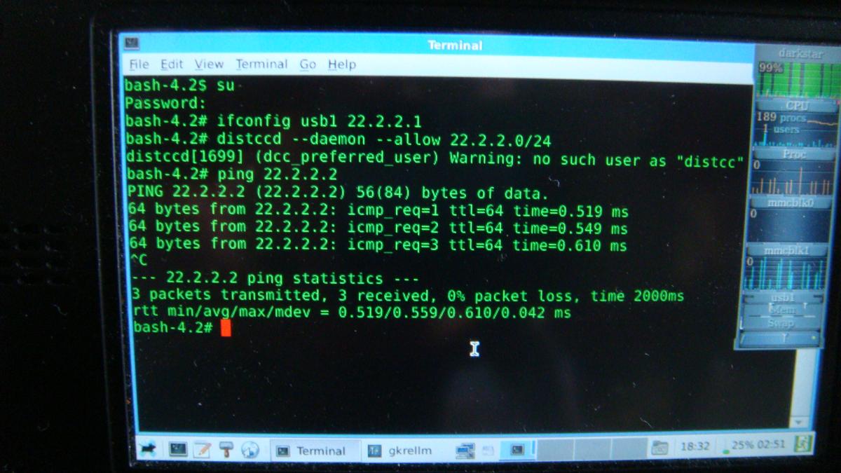

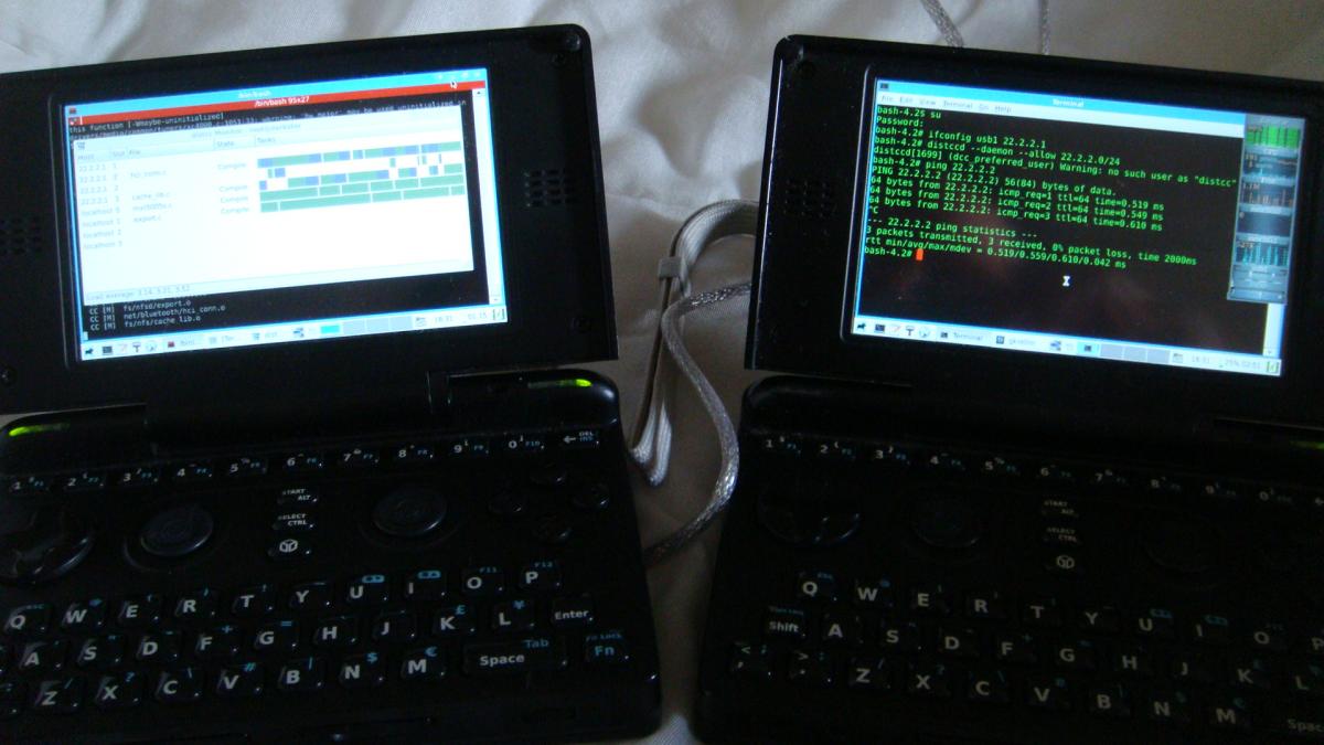

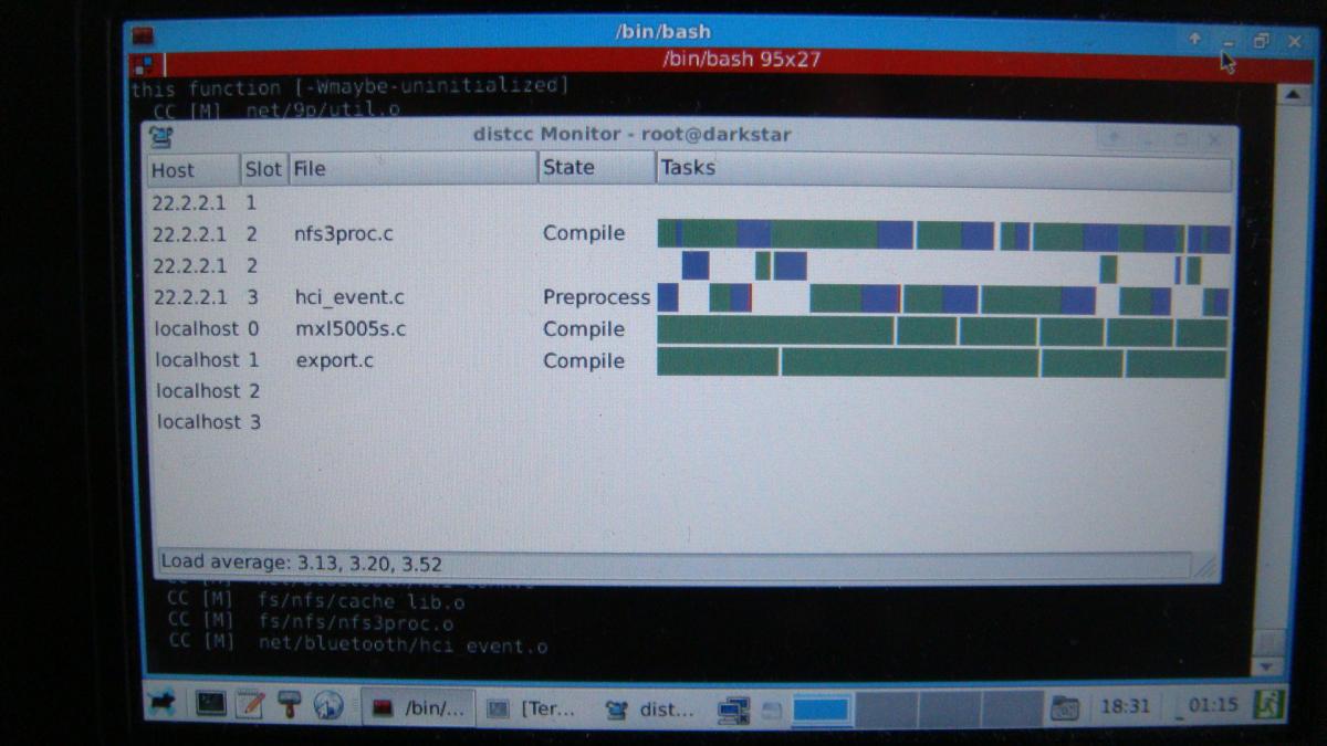

export DISTCC_HOSTS="localhost 22.2.2.1"
make -j4 CC=distcc uImage
make -j4 CC=distcc modules

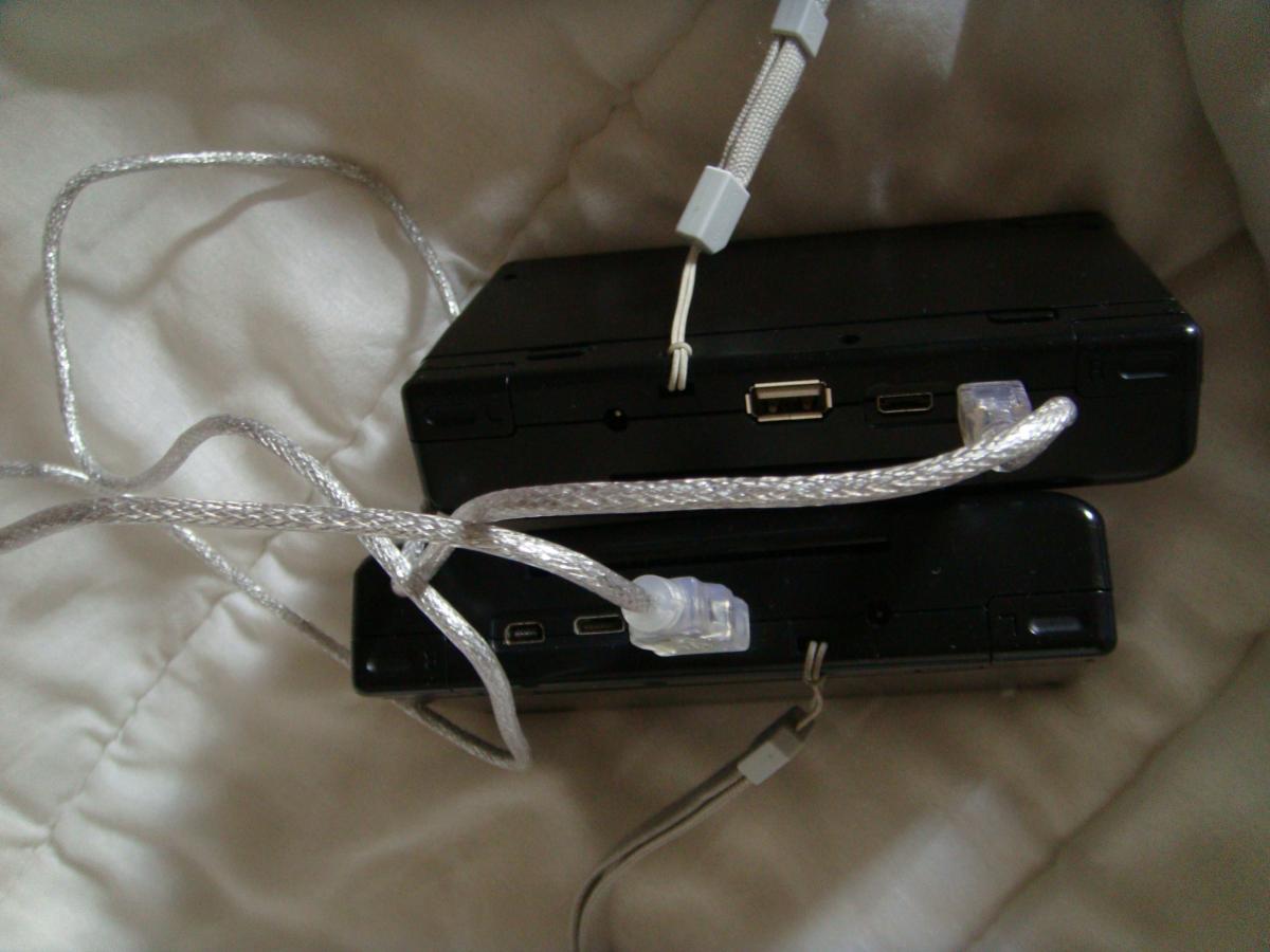

I'm sure there is a software way to change the current draw of the Pandora, but as a hackish way maybe try just cutting the 5 volt line? Maybe that will work.
Cutting the 5 volt line should work though, if you get rid of the 5 volt connection between the Pandora's it won't charge but the data lines will be intact.I'm sure there is a software way to change the current draw of the Pandora, but as a hackish way maybe try just cutting the 5 volt line? Maybe that will work.
I suggest removing the battery cover and shaking your Pandora a bit before use - works a treat*
*I take no responsibility for the state of your battery/anything else after this procedure
I prefer diplomatic solutions.
echo 0 > /sys/class/power_supply/twl4030_usb/enableAlso one OP charge the other. The current drain is huge. There's probably a way to manually stop this.
Ok, thanks for the tip.The later, there is no wait to turn off VBUS on host right now.
