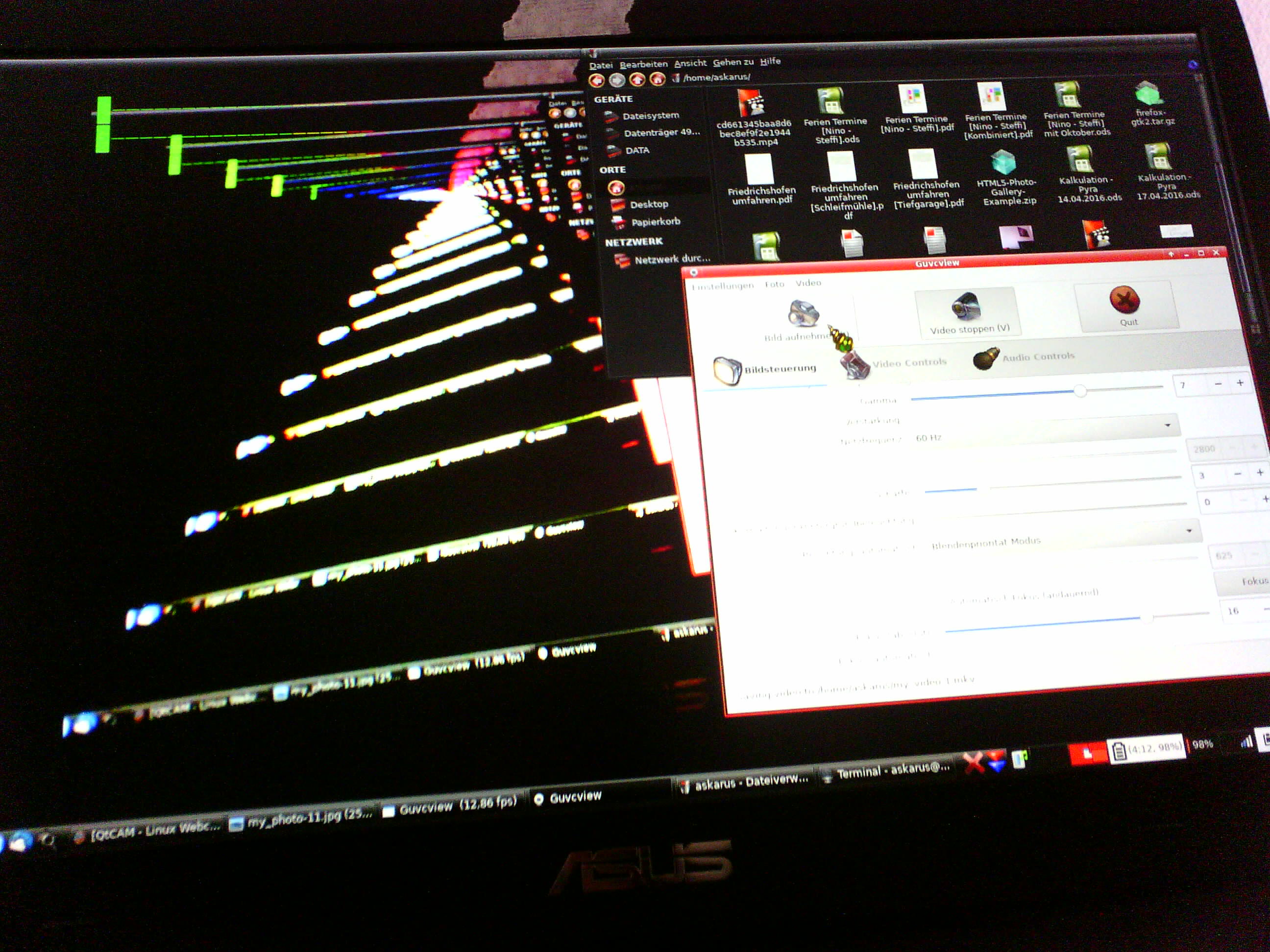

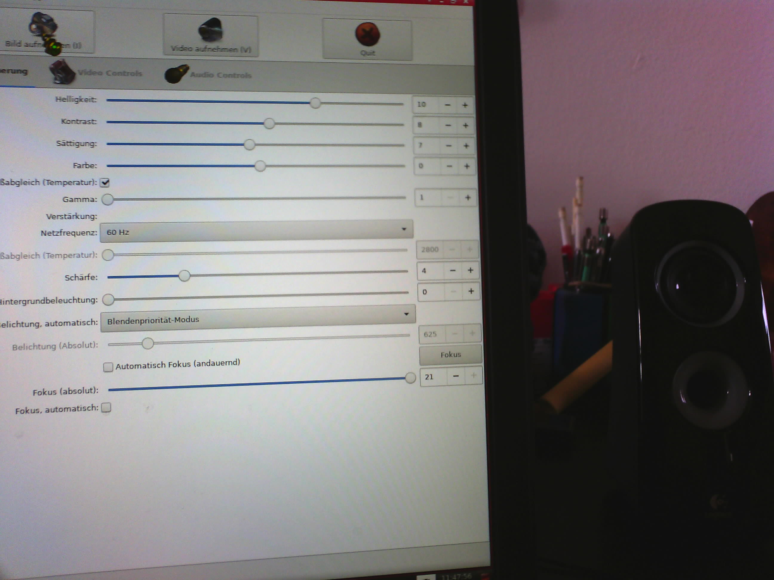

Can you share also some sample pictures taken with the webcam ?
Will do so tomorrow.

Here you have some Pictures taken in my house.
They are all made under bad conditions and from the static position where my Laptop is.
My Phone is not much better.
One image shows a photo of the screen with all the options available in GUVCview.
I can clearly read the text of the book. That's important for me.
I do not want it for great photos but for a quick picture if I need one.
It's pretty sufficient for that I think.

This quality is fine for scanning document or to use as a webcam, not really to take photos.
What's causing the magenta tint?
Looks like it could be a missing/bad IR filter.
CCD sensors also record parts of the near IR spectrum on the red channel. This creates unusually red images. To counter this, cameras have IR filters that block the frequencies the human eye can't see. Some people remove these filters intentionally for various reasons (see: "full spectrum camera").
Which can be entertaining with an IR light source - cheap night vision.
