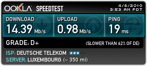

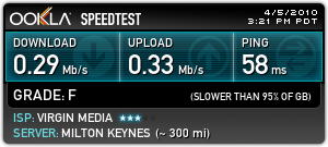

does this mean we wont have IE on pandora? oh and one last time from my trip in europe
TAKE THAT!

MWeston said:
The resistor was the series resistance in the oscillator driver. I did change it once on a previous revision but since there were no complaints back in the day, I kept it larger for lower current consumption. The wifi clock requires a very strict clock profile so I had to decrease this resistance to drive the crystal harder (larger voltage swing), increase the bandwidth and put the crystal into a tighter range around resonance. It probably means an extra mA or two of constant current drain so not a big issue in that respect.

EvilDragon said:

x68000 said:
TAKE THAT!
Dunny said:
Muahahahahaha!
Yeah, my upload is actually faster than my download. Take THAT.
D.

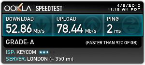

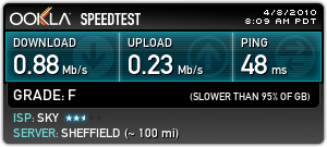

Dunny said:
x68000 said:
TAKE THAT!
Dunny said:
Muahahahahaha!
D.
My upload is also faster than my download :D
What's the competition regarding?
