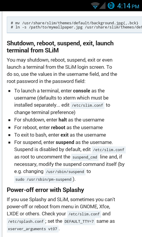

Might be to late to suggest, but it would be nice to be able to shut down at the log in screen

That requires patching slim (the login manages), not something I'd want to do.

Edit: wow, was looking up slim and found this. I tested and using halt and the password works. I had no idea.
Cool. Not as quick as clicking a button, but possibly good enough (I don't really shut my Pandora off unless I won't be able to charge it for a while). I will test it out later. Thanks a lot for sharing this.
Yeah, a button would be better but it's good enough for my purposes. I just disliked logging completely in simply to shutdown.
