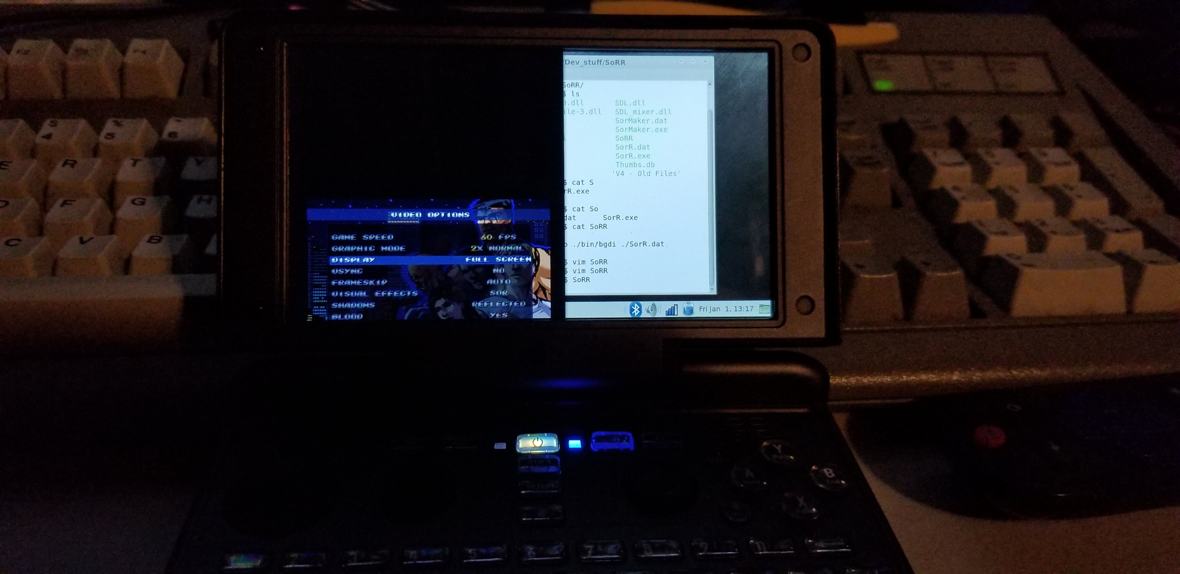

@jakko, well it's not that full screen isn't working, it's just not drawing on the screen properly, as it's not accounting for screen rotation.
I did try what you suggested but didn't change anything.
Hmm, in that photo the game art isn't rotated, from out point of view, which is what I'd expect to have happened given what you said. Looks more to me like the art is being drawn so that the width is the height of the screen, and the height is worked out proportionally from there. Probably the game does the latter automatically, but the initial mistake to me reads like it read the Y coordinate as the X coordinate. I'm slightly surprised the rest of the screen is still visible, and I don't know if it's still updating, but I've never seen the screen behind a fullscreen app before so I don't actually know what it's meant to look like. But it seems likely that some API needs to be tweaked to swap X and Y when giving the screen size, to account for the rotation in action. Which is kind of what you said, but using more words.
Forgive me if I’m barking up the wrong tree here but I thought @daveshah had already addressed this issue?
That's rotating the video data. There may be an API which is linked but rather orthogonal to that effort, namely an API to describe the dimensions of the screen, which is still giving the arguments in the wrong order.
