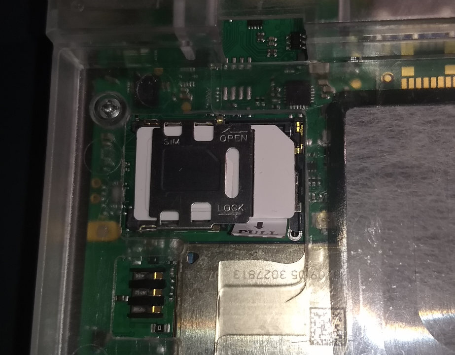

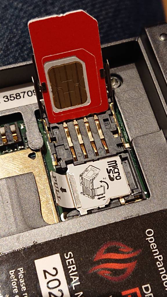

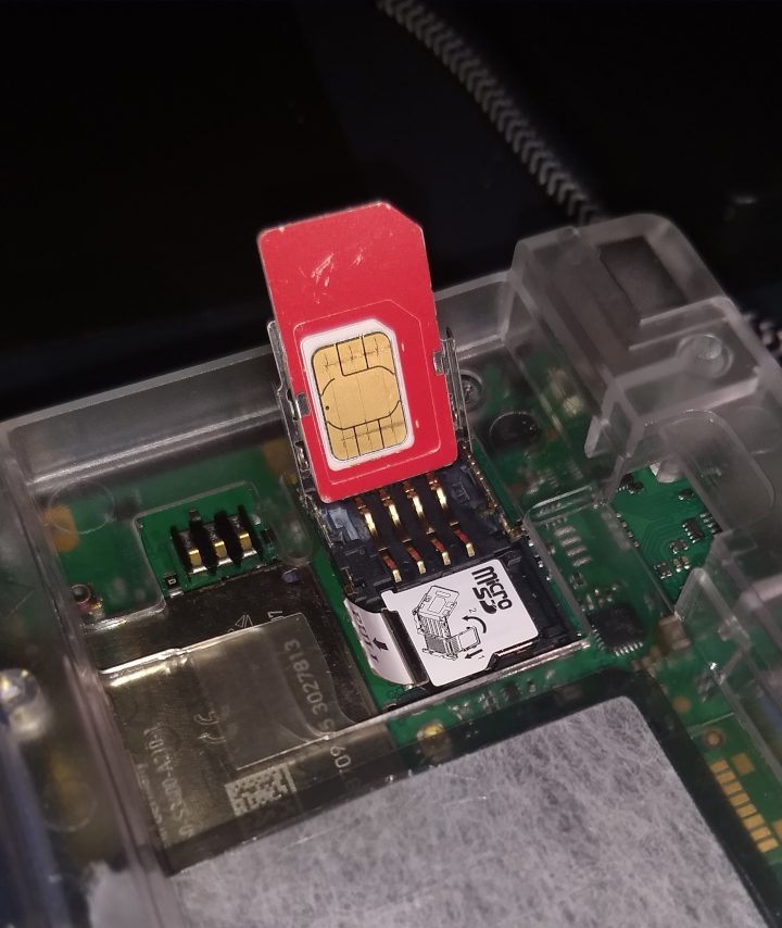

Also, there seems to be some confusion regarding the sim card. It needs the older larger sized sim.
other sized sims can be forced in there, but this is what it should look like :
