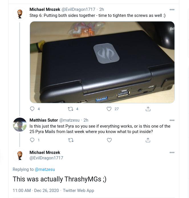

Looks like I get a view of mine already!
