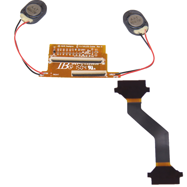

If enough people wanted to keep their Pandora running, it might make sense to add another connector on the existing cable where it has all of the components on it and where the speakers plug in, so that only the bit you curl and put inside the hinge can be replaced assuming the rest of it hasn't failed (and in my experience, it doesn't).
Well, that's how it's done in the Pyra ;) That's our display board.
It adds around 15 EUR to the overall costs, but it makes future repairs cheaper.
Isnt there a way to replace just the broken part of the cable with some extender or something? It's not necessary to replace all the components if those are still good... I noticed there are some connector boards but I don't know how easy it would be to strip a flex cable so that it can be inserted in one of those...
Now, the Pandora cables have so many pins, it's impossible to fix them.

OSH Park are doing flex PCB prototyping for $10 per square inch and you get three copies of your board. This is on 4mil polyimide core just like the Pandora cable.
Connector part is here (I believe?) https://www.digikey.co.uk/product-detail/en/0512966094/WM3352CT-ND/2405702
Everything else on the cable is passives. You'd need a mylar stencil and an oven to solder the compnents on- though- this isn't something you could easily do with an iron.

That was the part listed in the rev5 BOM - as "512966094 - Molex/Waldom Electronics Corp - 60 Pin connector, 0.5mm pitch" which I looked up in Octopart to find this list of suppliers - https://octopart.com/51296-6094-molex-7670409?r=ap&s=qItOWX7DSnqkgxJOGRryAg
They can also be had from Mouser - https://www.mouser.co.uk/ProductDet...i6zecJlRzWEhdNYGSk2Dspxs0rRLudqTeg1wE/Uf1NA==
I think it's feasible for someone to make these in small quantities, but I don't know how durable they might be.
I've not looked myself, but at you sure this isn't the connector on the PCB? The connector on the cable which joins the cable thru the hinge to the cable coming out of the LCD/touchscreen combo is lower pitch I suspect (since it looks to me to be wider yet is not carrying the audio signals which are split off and go to the speakers rather than go down that flat flex).
Earlier in the thread we were talking about that connector regarding splicing the cable thru the hinge with a new cable, but if you're talking about making your own you need the other one.
My information is only as good as the BOM itself, but the linked connector looks like the one on my old - marked Rev 1.3 - ribbon cable from a 1st Batch Pandora.
Looking at the traces, I wouldn't fancy trying to splice this but you *may* have luck using a hotplate to remove the connector (and even the passives) from an existing cable for transplant onto a new flex PCB.

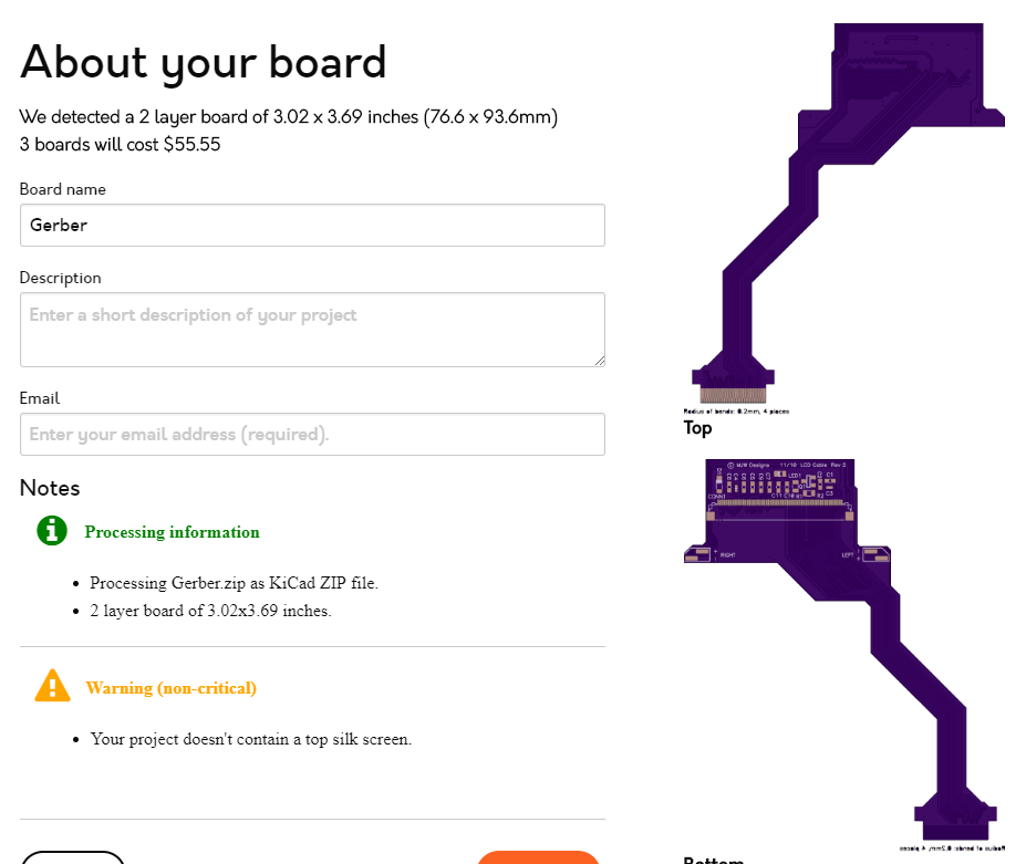

I think best is to re-do the design... maybe something like this?
All the components could maybe even go on a regular not flex print board, not too sure how much space there is but if need be the whole board could go on a small strip on the side or something as well...

I removed the one on my Pandora PCB after I shorted out the backlight power pins (I suspect) which stopped the unit powering up by mangling the installation of a new LCD cable. I didn't have a hotplate or hot air gun at the time, so I simply used my soldering iron to warm the whole thing up then try to lift up one edge of it and work my way along. It turned out to be very brittle and came away in pieces, and I lifted some traces when getting it out also (although presumably nothing that stops the machine booting and operating, as I was still able to use it via a TV out cable until that eventually spontaneously disassembled itself.
But if you have the right tools, and use some flux to clean the solder and make it melt more easily, you might have more success in getting one of them out in one piece, but I'd advise you to be very careful when you do.
Edit: @Eight Bit: I suggested that before, and ED noted that's the way they do it with the Pyra (the display PCB taking the space of the top of the cable). It might be a way to go if you're making your own replacement, although availability of both types of connector is likely to be lower than the availability of just one of them (though you could realistically use almost any flat flex connector with the right number of pins, and cope with the different shape in the bottom cable), and later availability of the bottom bit once that fails on you is on your own back. The cost of using two connectors and ordering two flat flex components would be more expensive for a one-off purchase, on top of the cost of redesigning the parts.
