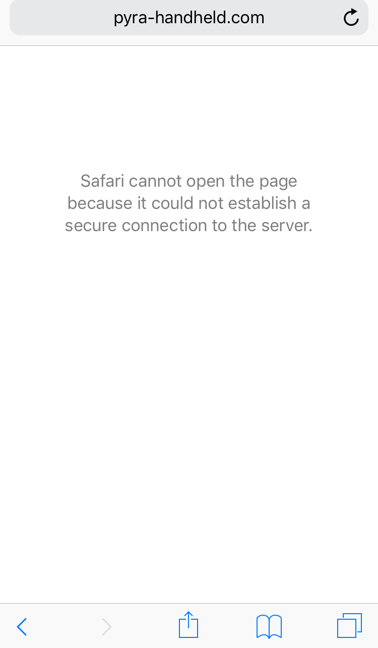

@hns So is there a separate mailing list for reading about PyraOS update work?
Thanks for the links! Unfortunately for both of them I get this:
:mad:
Yeah it resolves to a regular http site and throws a flag up, I know it works in chrome is you bypass the warning, I'm not sure how you would do that in Safari.
Ah. I’ll try again later on my laptop but d’you know whether it works alright in Firefox?
