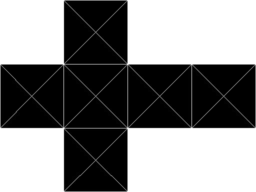

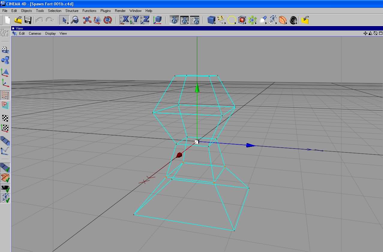

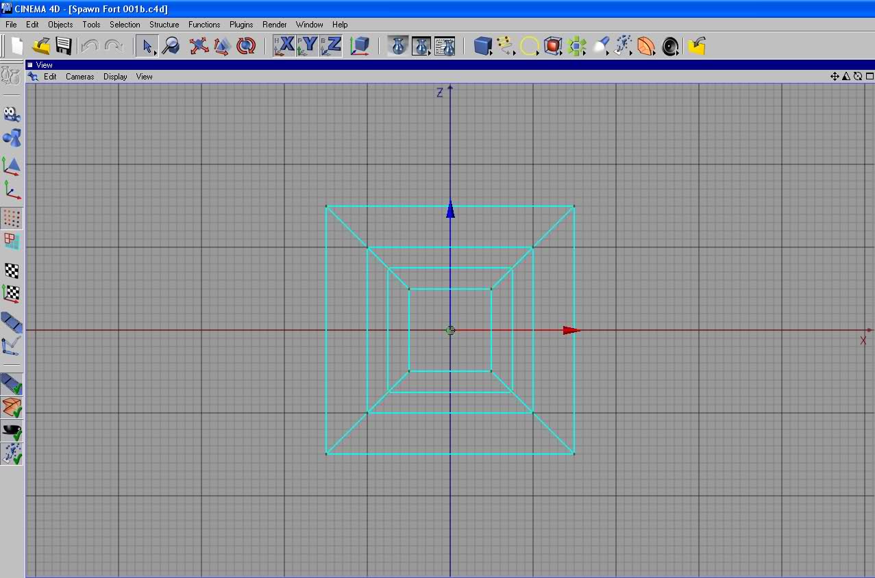

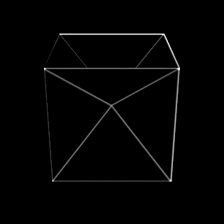

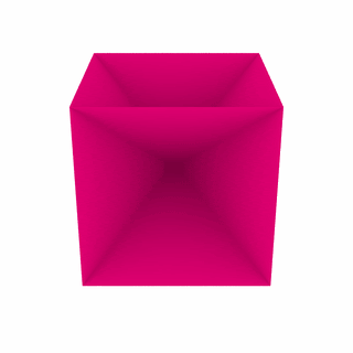

I may tinker with a few models that will be easier to make with Quads than tris on the basis that I quite enjoy making these simplistic models. Taking a 2D idea and re-imagining it is quite fun... for example, if we take the "concentric squares" image from GridWars - the graphic that spawns loads of "pnkpinwheels" - we could easily extend that to this:
which can, rather conveniently, be rotated to reveal this:
Making basic shapes like this isn't much hassle, if I stop before we get to triangulating or doing the Uv Mapping, and may cut down time on producing stuff later if you need it for this, or I use them for something else.

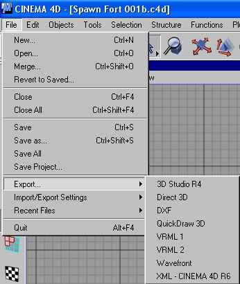

Which reminds me - it'd obviously be an extra step, but if another format is preferable I could export these models to something else... I've a dazzling array of conversion software somewhere, but just using my ancient copy of Cinema4D (which these were built in) I could export to:
.OBJ is just my preferred format because I'm more familiar with it/tend to use it more than any other (which also means if you want one of the other formats - you're pretty much on your own if you come across "issues" caused by the format/exporting).
Ta

It's a pity you haven't managed to get further yet
Well, I *did* get the engine ready for PandoraOS by porting it to Touchbook, and thus it does give us a real indicator of how much performance we can expect out of our lovely little OMAP. Maybe I need to do a demo video tonight, after I've had another chance to play with integrating your models into the engine ..
BTW, I'm really not sure what is the 'best' model format to use for this project, I will try to take what you've done already, but if you feel like exporting the whole model collection to DXF it would be useful for me since I can try to write a script to automate the conversion/code-generation process. Its something I have to dig deeper into, and I'll do that during tonights hacking session .. stay tuned.

Just a note. If you find yourself needing to export to a format your software can't, the sky's the limit between my home and work machines. Deep Exploration and Polytrans are just two of many packages I use on a daily basis.

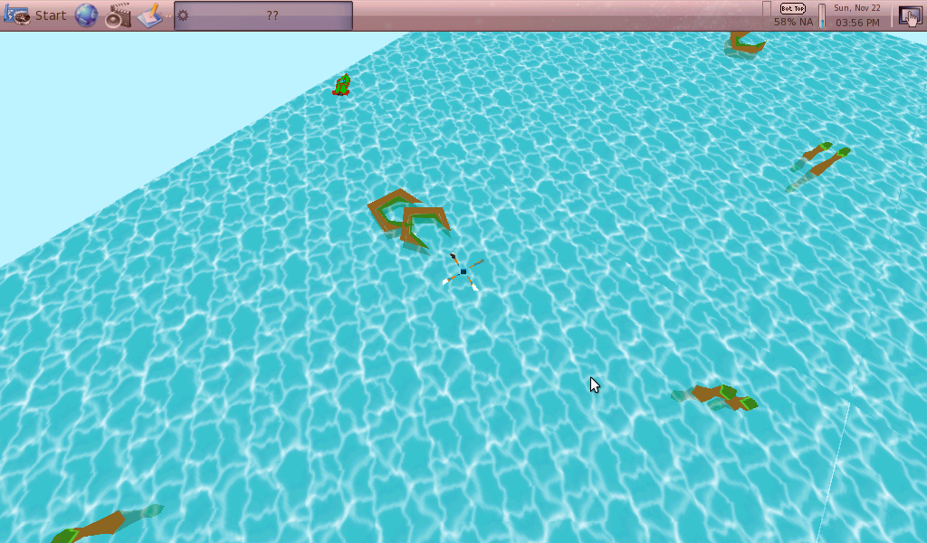

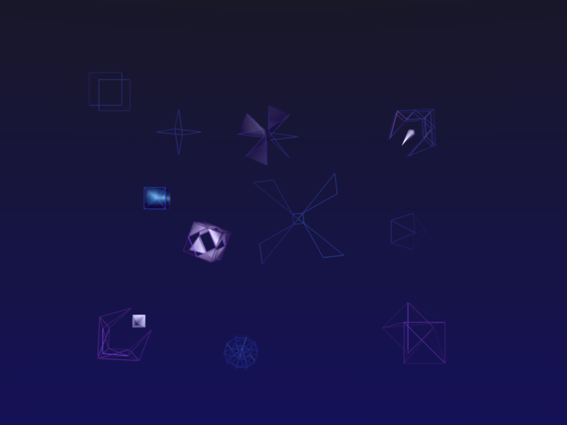

Okay, a *little* progress to report .. I haven't had much time for hacking this weekend, Dad duties and all that, but I took an hour to do something on this project at least tonight before I have to start the mad work week tomorrow ..
So .. I have gotten two of your models integrated into the engine, worked out how to use them, so at least the process of using the models and turning them into something the engine can use has been run through, twice now:
Some things to note:
1. The camera angle is not quite right, just wanted to get it 'up there' so I can see.
2. The texture maps are not integrated yet. Old textures in use.
3. There are three ship models and one rotor model in this picture.. all else is still WakeBreaker models.
4. The process to integrate the models started like this:
** Save the files you posted as .OBJ files
** Set up a Blender scene.
** Import each OBJ file into Blender
** Use the Blender "export to Objective-C" script to output a temporary header file, which after I hacked it up a bit with some dodgy glue code, looked like this (for the rotor model, for example):
Code:
#include <types.h>
#include <bfd.h>
#include <math.h>
#include <stdint.h>
#include <stdlib.h>
typedef int int32;
//float to fixed point
#define FTOX(x) ( (int32)((x) * 65536) )
struct TexturedVertexData3D rotor02vdata[] = {
	{/*v:*/{-0.222222, -0.111111, 0.011111}, /*n:*/{0.138707, -0.194189, 0.971099}, /*t:*/{0.025000, 0.737500}},
	{/*v:*/{-0.222222, -0.222222, -0.011111}, /*n:*/{0.138707, -0.194189, 0.971099}, /*t:*/{0.025000, 0.975000}},
	{/*v:*/{-0.027778, -0.027778, 0.000000}, /*n:*/{-0.179571, -0.302622, 0.936033}, /*t:*/{0.440624, 0.559376}},
	{/*v:*/{-0.222222, 0.222222, -0.011111}, /*n:*/{-0.194189, -0.138707, 0.971099}, /*t:*/{0.025000, 0.025000}},
	{/*v:*/{-0.027778, 0.027778, 0.000000}, /*n:*/{-0.302622, 0.179571, 0.936033}, /*t:*/{0.440624, 0.440624}},
	{/*v:*/{-0.111111, 0.222222, 0.011111}, /*n:*/{-0.194189, -0.138707, 0.971099}, /*t:*/{0.262500, 0.025000}},
	{/*v:*/{0.027778, 0.027778, 0.000000}, /*n:*/{0.179571, 0.302622, 0.936033}, /*t:*/{0.559376, 0.440624}},
	{/*v:*/{0.222222, 0.111111, 0.011111}, /*n:*/{-0.138707, 0.194189, 0.971099}, /*t:*/{0.975000, 0.262500}},
	{/*v:*/{0.222222, 0.222222, -0.011111}, /*n:*/{-0.138707, 0.194189, 0.971099}, /*t:*/{0.975000, 0.025000}},
	{/*v:*/{0.027778, -0.027778, 0.000000}, /*n:*/{0.302622, -0.179571, 0.936033}, /*t:*/{0.559376, 0.559376}},
	{/*v:*/{0.111111, -0.222222, 0.011111}, /*n:*/{0.194189, 0.138707, 0.971099}, /*t:*/{0.737500, 0.975000}},
	{/*v:*/{0.222222, -0.222222, -0.011111}, /*n:*/{0.194189, 0.138707, 0.971099}, /*t:*/{0.975000, 0.975000}},
	{/*v:*/{0.000000, -0.000000, 0.022222}, /*n:*/{0.000000, 0.000000, 1.000000}, /*t:*/{0.500000, 0.500000}},
#define rotor02numi 24
// Drawing Code:// glEnableClientState(GL_VERTEX_ARRAY);
// glEnableClientState(GL_TEXTURE_COORD_ARRAY);
// glEnableClientState(GL_NORMAL_ARRAY);
// glVertexPointer(3, GL_FLOAT, sizeof(TexturedVertexData3D), &rotor02vdata[0].vertex);
// glNormalPointer(GL_FLOAT, sizeof(TexturedVertexData3D), &rotor02vdata[0].normal);
// glTexCoordPointer(2, GL_FLOAT, sizeof(TexturedVertexData3D), &rotor02vdata[0].texCoord);
// glDrawArrays(GL_TRIANGLES, 0, kRotorblade001bUVNumberOfVertices);
// glDisableClientState(GL_VERTEX_ARRAY);
// glDisableClientState(GL_TEXTURE_COORD_ARRAY);
// glDisableClientState(GL_NORMAL_ARRAY);
void 	doRotor02()
	int i;
	printf("model->m_numVertices = %d;\n", rotor02numi);
	printf("model->m_numIndices = %d;\n", rotor02numi);
	printf("model->m_numColorData= %d;\n", 0);
	printf("model->m_numTexCoords = %d;\n", rotor02numi);
	for (i=0;i<rotor02numi;i++) {
		printf("\t//v.x: (%d) v.y: (%d) v.z: (%d)\tn.x: (%d) n.y: (%d) n.z: (%d)\tt.a: (%d) t.b: (%d)\n",
				FTOX(rotor02vdata[i].v.x),
				FTOX(rotor02vdata[i].v.y),
				FTOX(rotor02vdata[i].v.z),
				FTOX(rotor02vdata[i].n.x),
				FTOX(rotor02vdata[i].n.y),
				FTOX(rotor02vdata[i].n.z),
				FTOX(rotor02vdata[i].t.u),
				FTOX(rotor02vdata[i].t.v));
		printf("\tmodel->m_vertices[%d].x = (%d);\n\tmodel->m_vertices[%d].y = (%d);\n\tmodel->m_vertices[%d].z = (%d);\n",
				i,
				i,
				i,
				FTOX(rotor02vdata[i].v.z));
		printf("\tmodel->m_normals[%d].x = (%d);\n\tmodel->m_normals[%d].y = (%d);\n\tmodel->m_normals[%d].z = (%d);\n",
				i,
				i,
				i,
				FTOX(rotor02vdata[i].n.z));
		printf("\tmodel->m_indices[%d] = %d;\n", i, i);
		printf("\tmodel->m_texCoords[%d].u = (%d);\n\tmodel->m_texCoords[%d].v = (%d);\n",
				i,
				i,
This produced the following code that I could then easily plug into the existing sources:
Code:
model->m_numVertices = 24;
model->m_numIndices = 24;
model->m_numColorData= 0;
model->m_numTexCoords = 24;

.. so you can see, a bit of fudging around here, to get things sorted. BUT! I at least have two models integrated, tomorrow I will do the rest and we shall see how they all look on the playing field together. Then, once I've got them all integrated, I suppose we can re-wire the game engine of WakeBreaker to have ourselves a little shoot-'em-up .. :)
(BTW this screenshot is directly from the Touchbook running AIOS 2009.11a, which is the build machine as well as the test machine, so hopefully this project will be a very easy port to Pandora, too ..)
Excellent - Cinema4D has a horrible tendency to lose the UV mapping if you change the number of vertices (at least, the old version I am using does). A program dedicated to conversion might make a better job of it... so, sorry for the lack of speed in responding but thanks even more for the offer - there may well be a more convenient intermediary file format (I shudder at the idea of using DXF.... :shudder:)

Okay .. its been a week or two since we talked about this, so I thought I'd better give you an update, in case you're interested ..
This is what I've got worked out model-wise, so far:
This is a test render of the models in wireframe and some texture mode .. as I've been playing with these models I started to think of some rules for gameplay.
I thought a nice game twist would be that you can pick up the 'bones' of the models after you've blasted all the solid textures out of them .. so here we see a set of models that have been blasted, ready for collection, and one two are still in fighting shape ..
Anyway, nothing playable - yet - but I have pretty much twisted the WakeBreaker sources quite a bit to get these models in and rendering, and .. well .. its not WakeBreaker no more!
Will have another bash at it this weekend when I have time, and hopefully do a playable demo video some time next week. The code is all running on the Touchbook, which is sorta nice in the meantime ..

I believe you now have a .OBJ import routine so that the pipeline has been minimised if not effectively zeroed? Could you do me a couple of favours as I try to wrap my head around what I was doing all those weeks ago...
1. Let me know if the .OBJ importer will handle quads (I like quads).
2. See if you can knock up some "Pandora resolution" images showing game pieces in place, so I can see how much room there is for texturing/detail. I'm getting the idea that these things are going to look pretty teeny tiny, so I'd be better off NOT painting (say) a tiny cockpit and lots of "engineering detail" onto the ship if it's only ever going to be 8 pixels on the scren, max. If possible I'd like to see a few models, distant and far, at Pandora Res (what's that, 8 00 * 480?) in 3 different styles - something like:
"Solid"
"Textured"
This actually uses THIS texture:
which looks slightly like Hidden Line, but rubbish.
Proper "Hidden Line and Glowy" would be nice to see too! Or failing that, any kind of "geometric special-effecty" that you can manage for now. Here's my attempt at an "interesting glowy vectorish" style:
As I say, I hope that - in addition to being a boot up the posterior to get us actively cracking on with this project, I hope the results will help guide me on further models and any fixes the current models need, including (perhaps) some texturing.
Ta,
