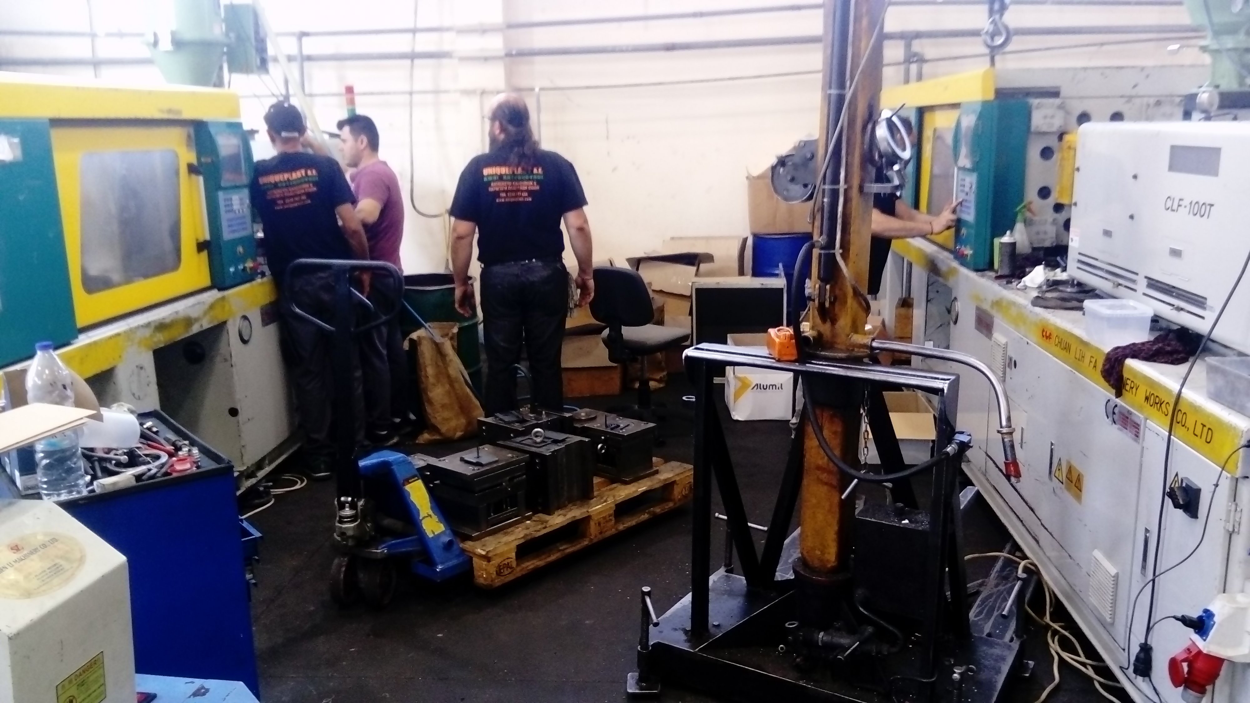

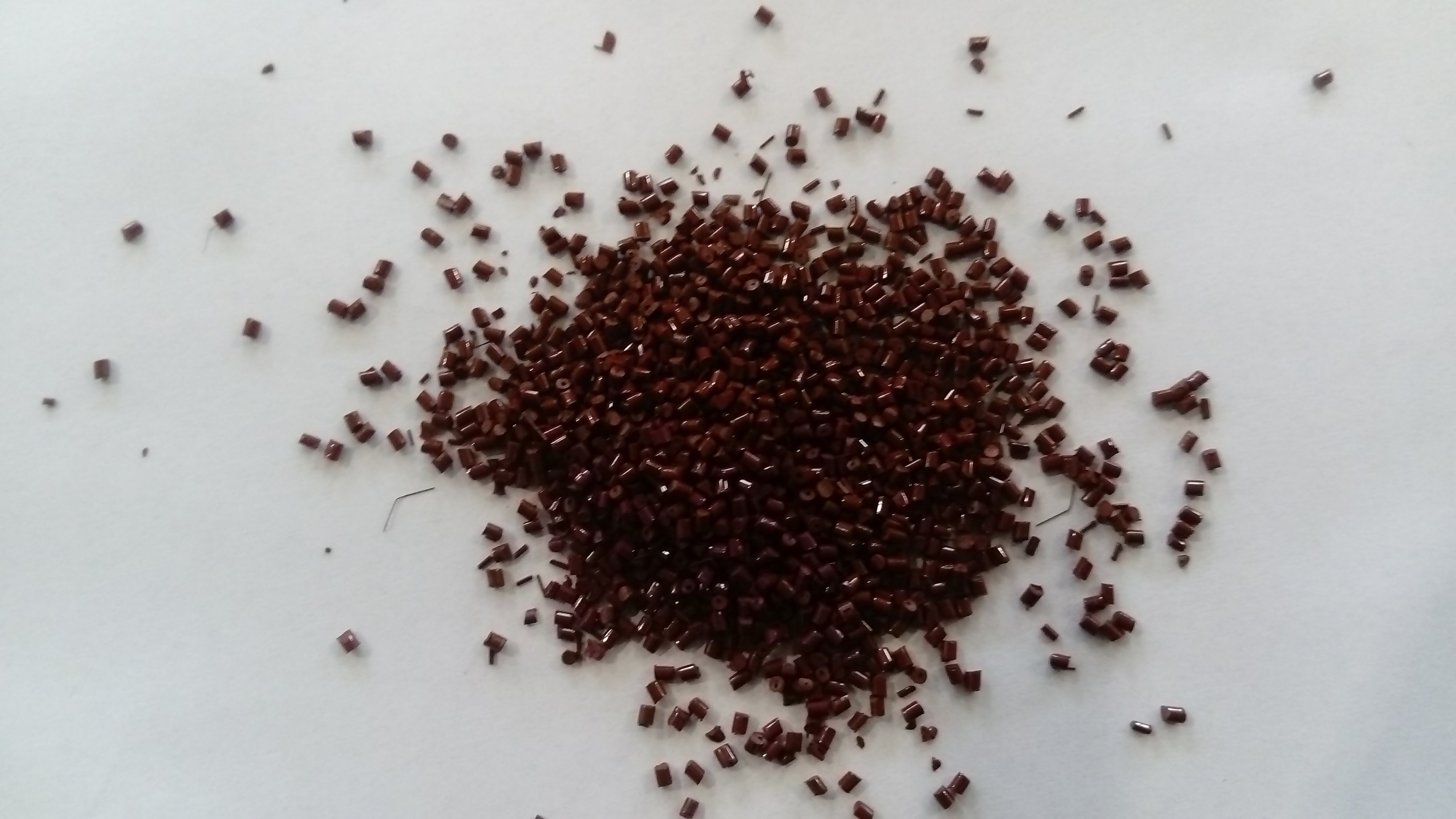

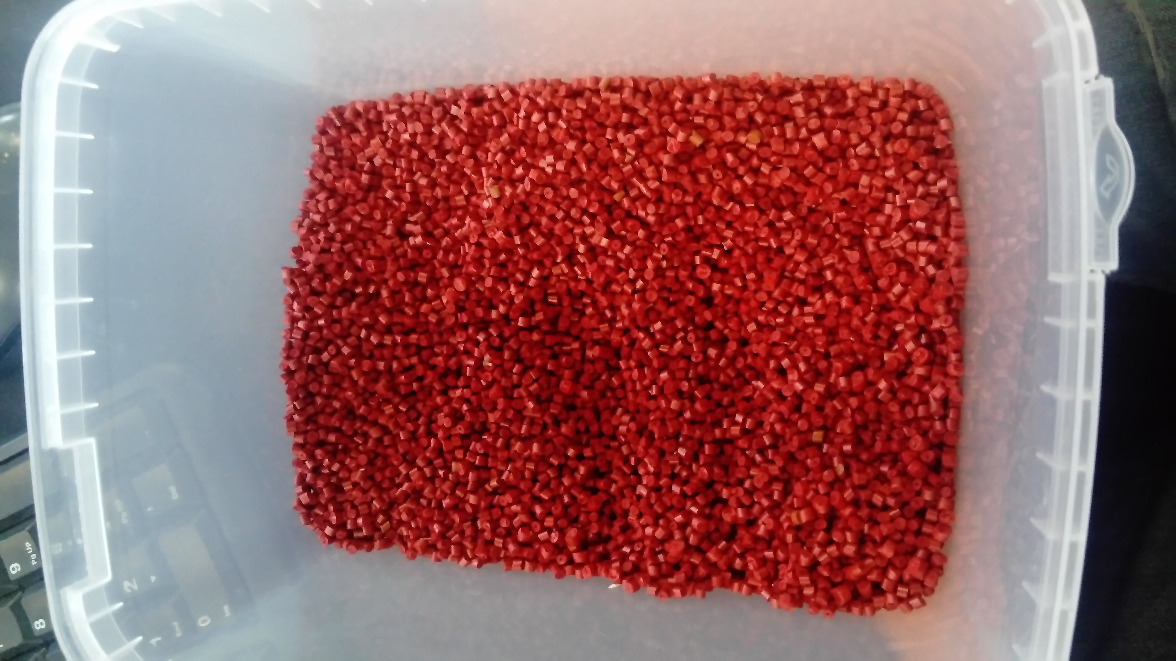

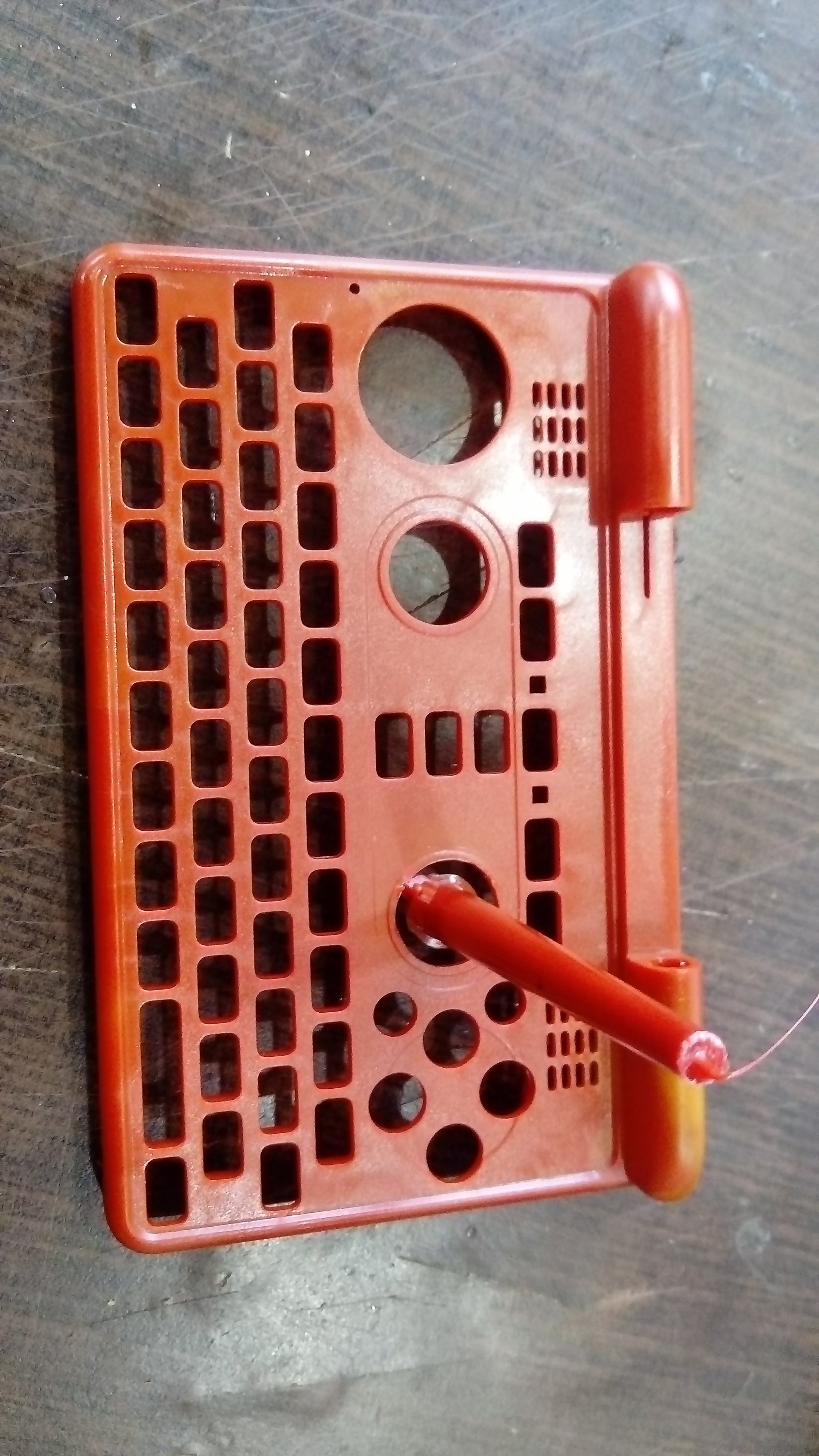

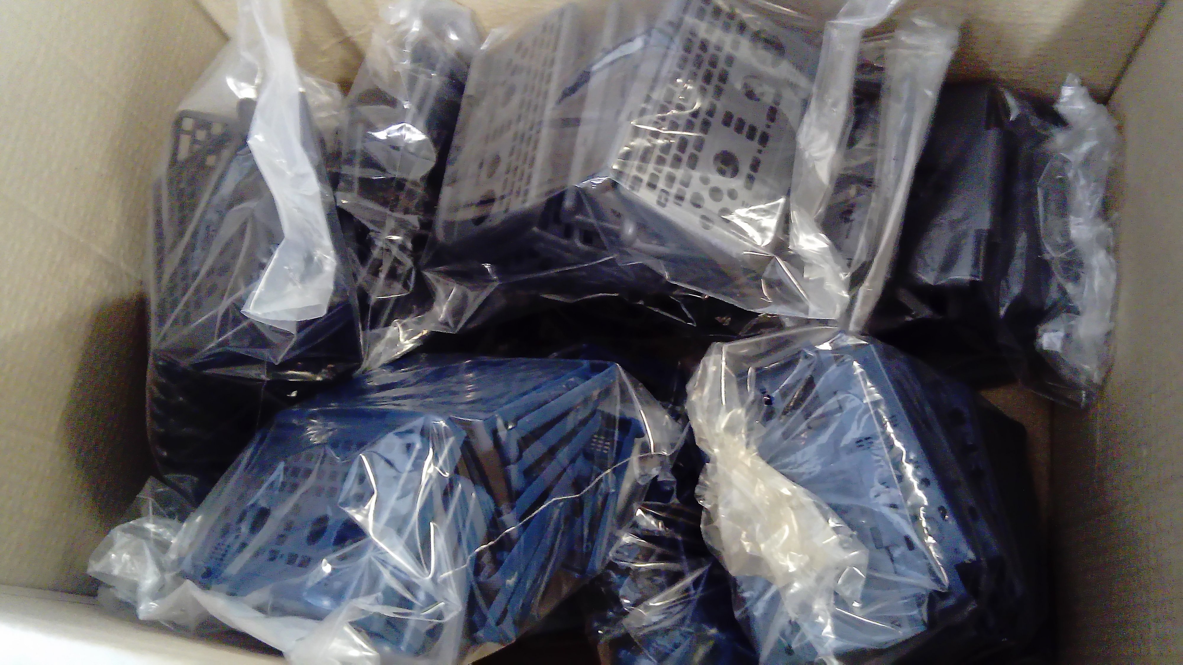

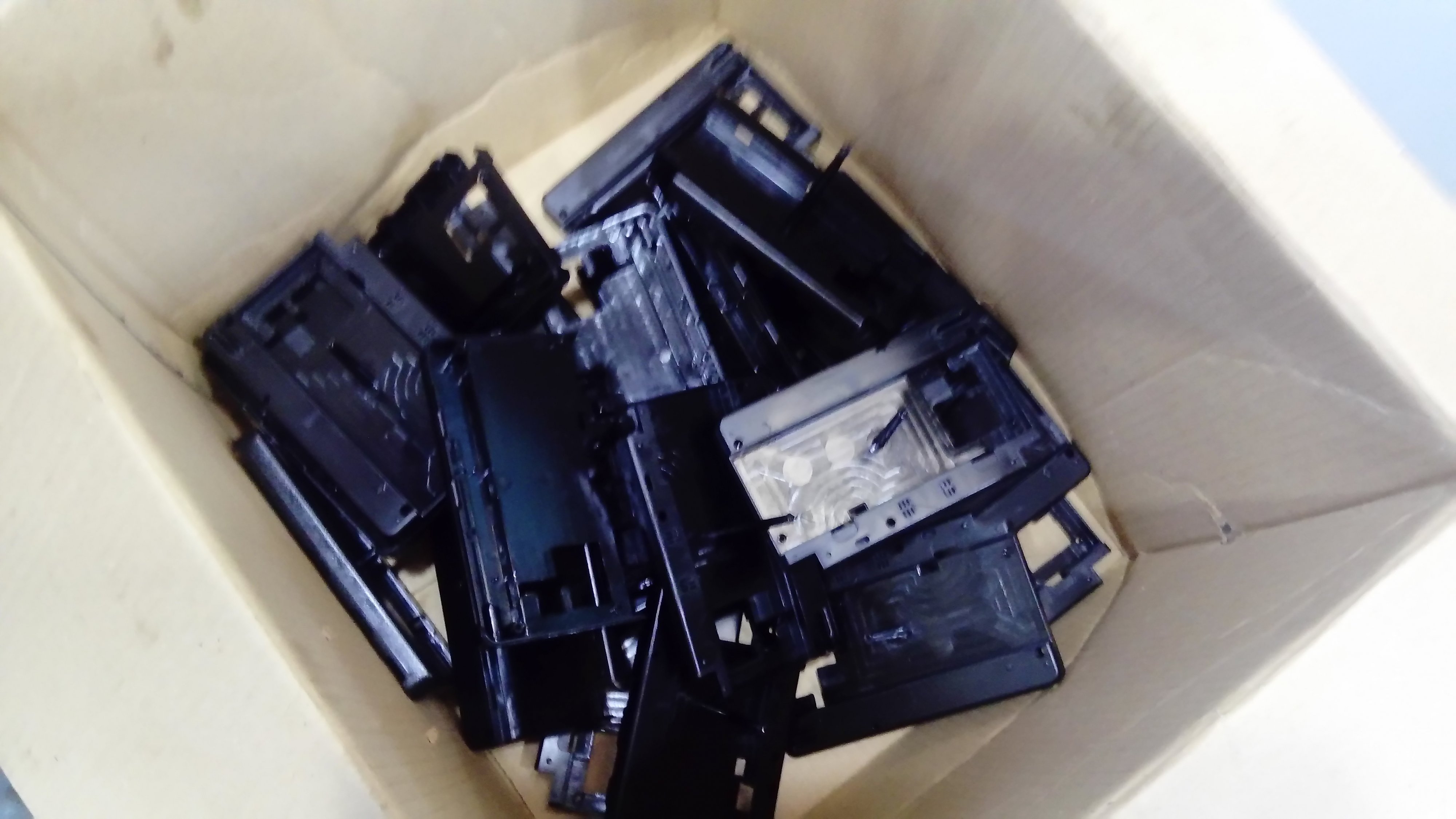

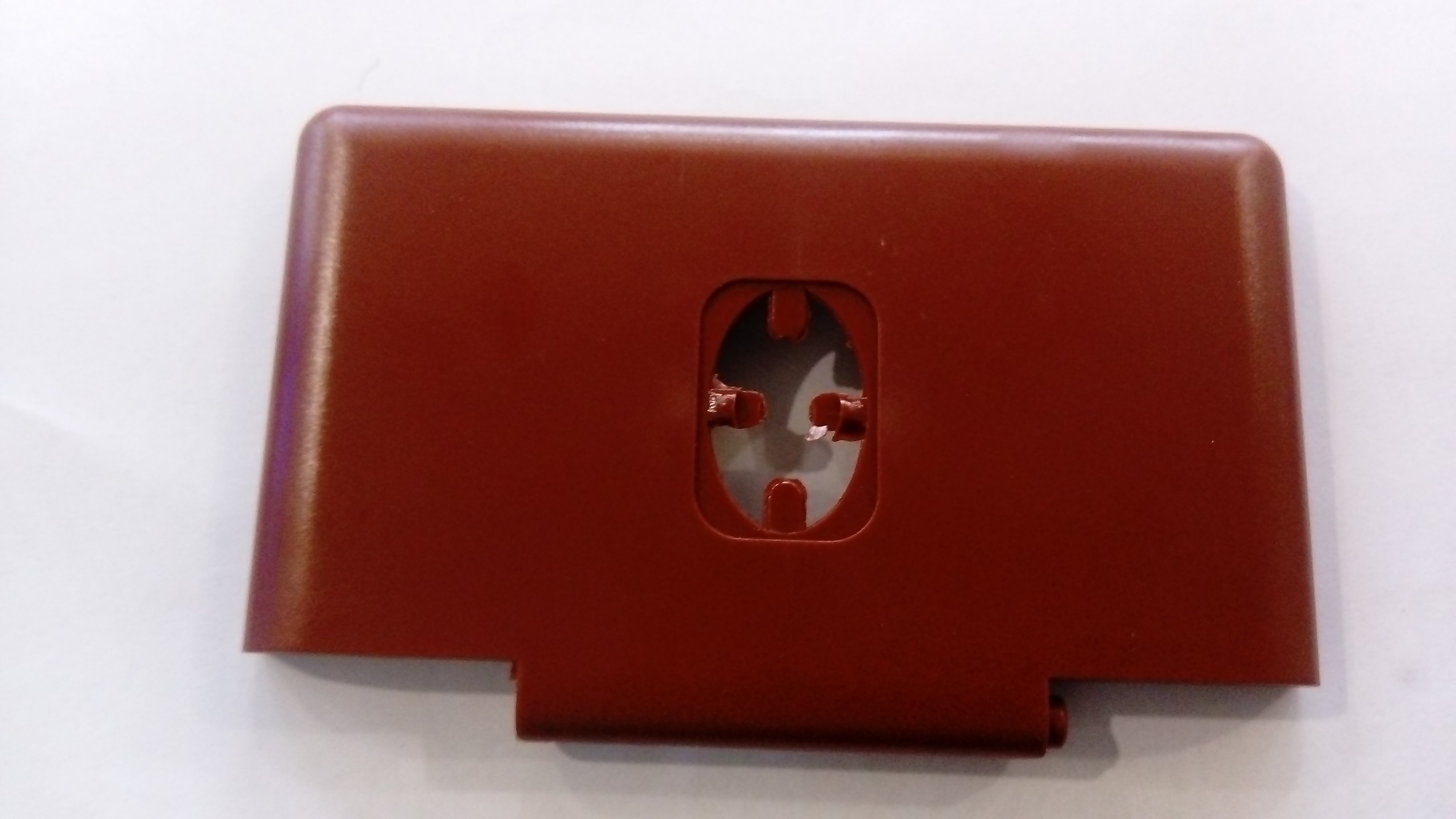

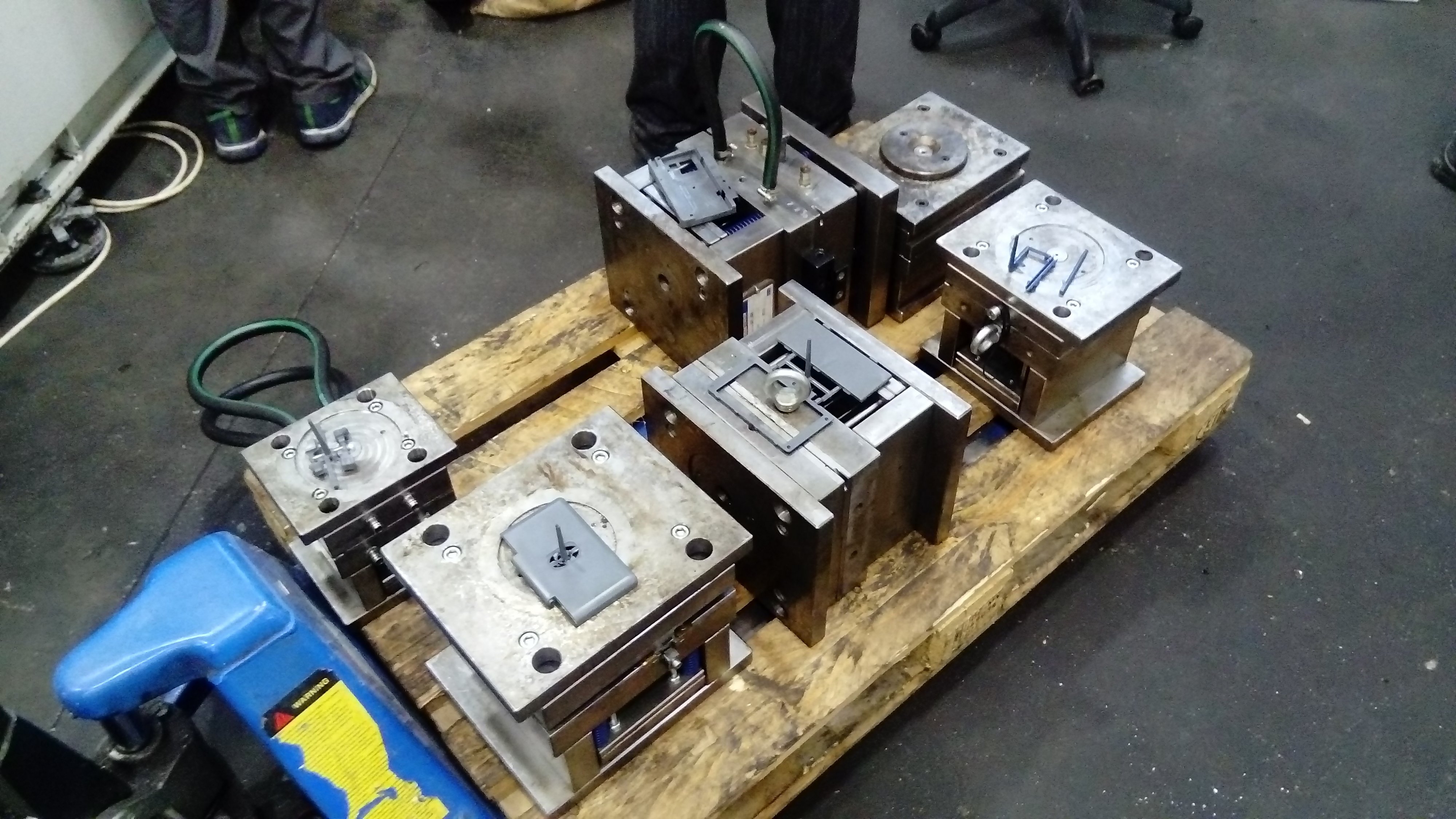

Good morning all . We are finishing with Black color in 3 hours. We had an issue with Dark red color. The First red color we took it looks more like brown so i dint like it and ordered an other RED color from Plastika Kritis but it will take 3 weeks to get it so i found an other Red color from a friendly companie but wasnt for PC so it burns the color and makes it more like orange.So we will move forward to finish the black ones and i will send to ED ,Blue Grey and Black Till we get a new Dark red color from Plastika Kritis. The Color and item that Says (1) its the First that looks more like brown, The color and item that says (2) its the red that burns and becomes orange.
It doesn't look too bad, that brown... Still no plans for cream/white though? I just read in the mailing list that the Pyra is a little furnace and will especially overheat in sun light etc. In which case a light colored case would be preferable. ;)
