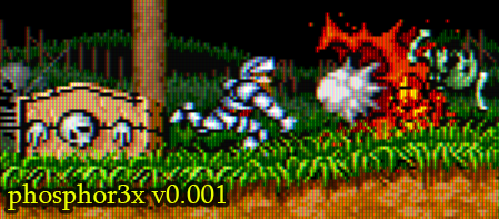

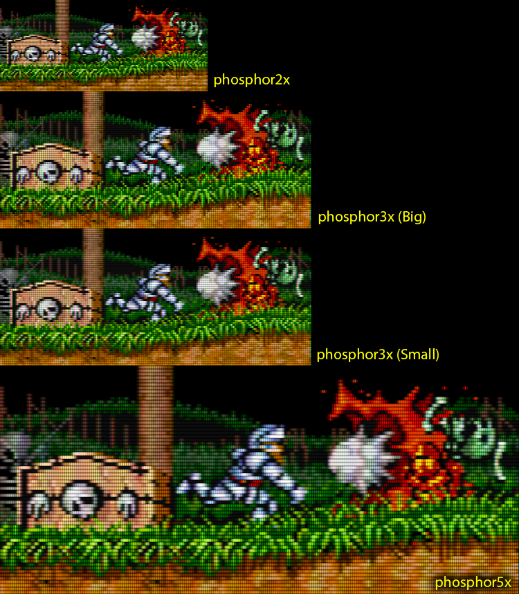

I like this one:
So much that I implemented it in my emulator. I've had a lot of positive feedback about it, too.
Edit: Here's a few more images of it at various scaling levels:
D.
I like it. Would there be a way to filter EVERYTHING that comes on the Panda screen like that?

The Phosphor filters do look nice. Much nicer than that bilinear fuzz filter that many emus on the PSP use. This filter looks very CRT-like to me with aperature screen look. Looks more arcade RGB monitor like actually but that would be great for anything. Many consoles like SNES could output RGB (I had mine connected to an RGB monitor) and in many countries SCART RGB was used and looked like that.
Since Temper will Be so easy to run on the Pandora due to its much faster speed than a Wiz or GP2X could an option like this be done? You could integer 2X vertically but maybe use this to get correct aspect horizontally maybe?
It would be nice if some of these modes could be done then passed around for all emu coders to implement.
