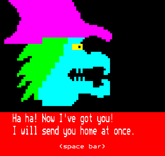

Prometheus said:
Yes! The original survival horror classic!
Beware, Pandorians, the witch will send you home at once!
Her mouth looks like a science fiction type blaster.
