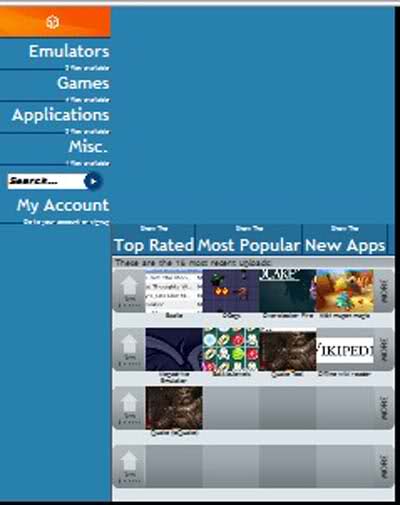

Interesting Firefox zoomout effect on the page: (I tried it to see it closer to the size it will be on a Pandora screen, I don't have any Iphones or Nokia N800's :P)
I'll put a 30 second timer on the comments in the morning.
