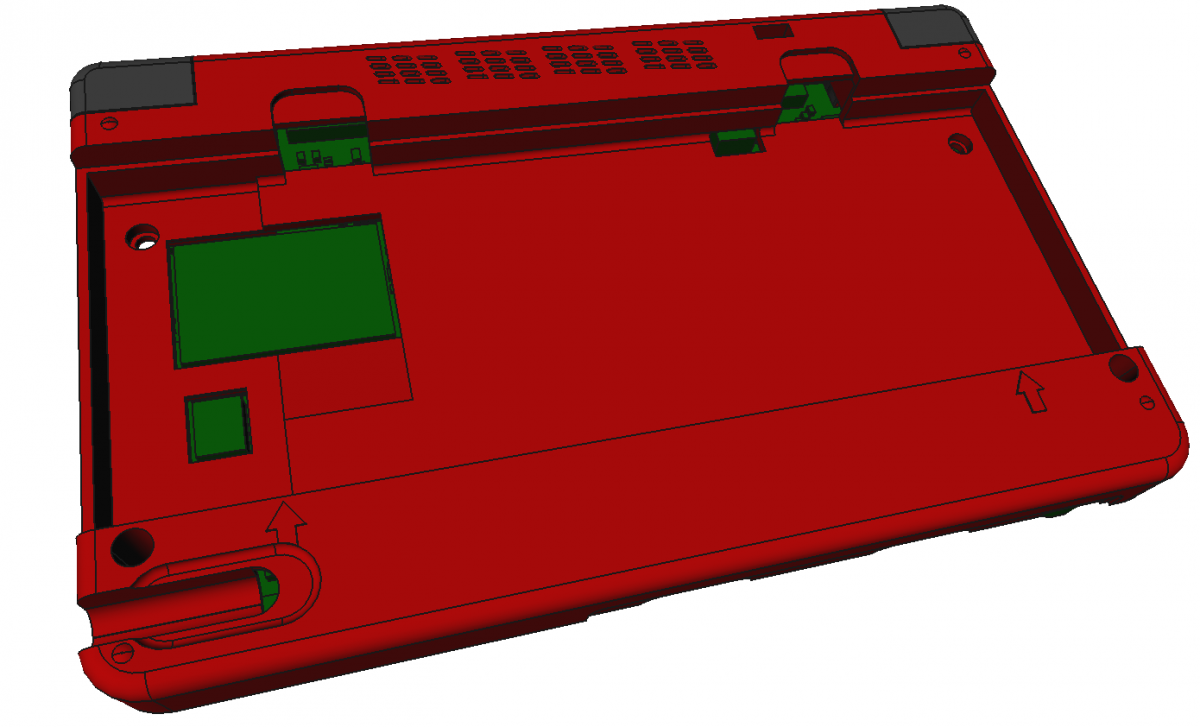

There are multiple problems with your idea:
  1. Changing the outside is going to make the Pyra a lot bigger and/or with a weird shape it's not going to fit anywhere
  2. The CPU is on the upper side of the SoC-board, so that the heat can get dissipated along the mainboard. By that, it's also a bit shielded to air by the two boards
  3. At the spot you'd put the square-shaped hole is already the battery
And most importantly:
Nobody knows exactly how much heat the CPU is going to produce. By the time the A15 and Krait were put into phones, the production companies didn't do a lot to dissipate heat - a huge PCB with a copper core just atop the SoC with some carbon in between there and 2 metallic SD card slots on the outside could already be enough. Just wait a few weeks and ED/hns will test that, and if it doesn't work at that time, then you can think of crazy solutions. But even if that should happen I think Nikolaus can handle it, it's by far not the first mobile device with passive cooling he's designed.
