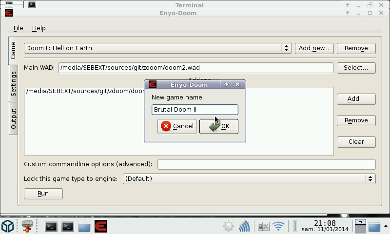

I have packed the enyo-doom launcher. With it, you can easily create Game profile for an easy launching.

Is there any way to get this to save which wad you want to run in which gametype?
I create a new ("Add New") and call it "Doom", add Doom.wad - but there's no way to save. If I select the main "Doom 2" from the dropdown, I still have the Doom.wad selected.
So in short, is there any way to quickly choose a game to play? Or do I have to navigate to the depths of my SD Card every time? It doesn't even seem to save the .wad file I chose as a default.
Edit: Scratch that, it's saving now that I've rebooted after installing from PNDManager.
