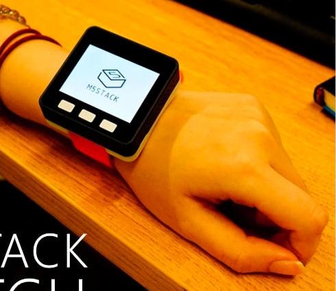

Aliexpress has a photo of someone wearing it - looks uncomfortable ;)
It was getting 5 star reviews so maybe it's better than it looks?
Anyway, as Binky pointed out, it's been out of stock for quite a while, and no sign it's coming back.
