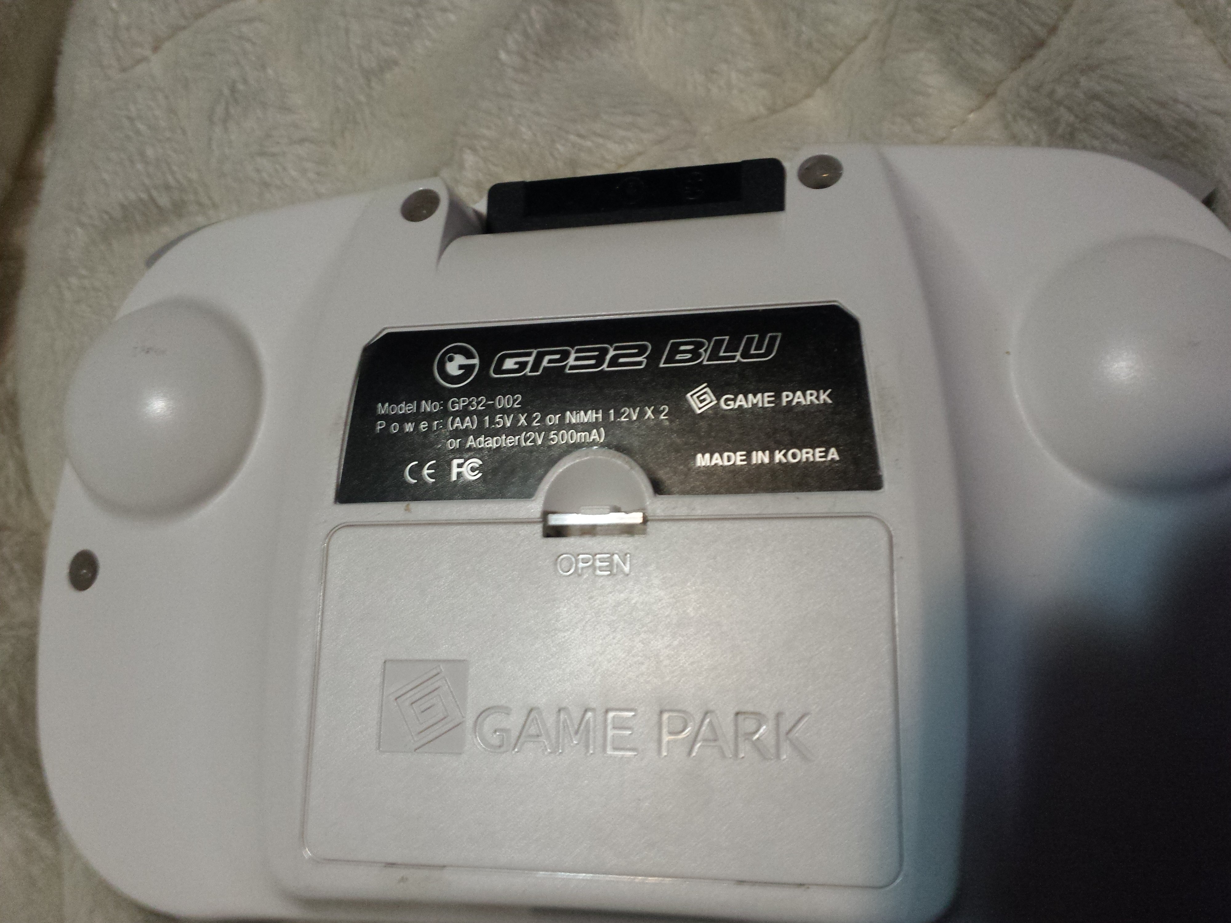

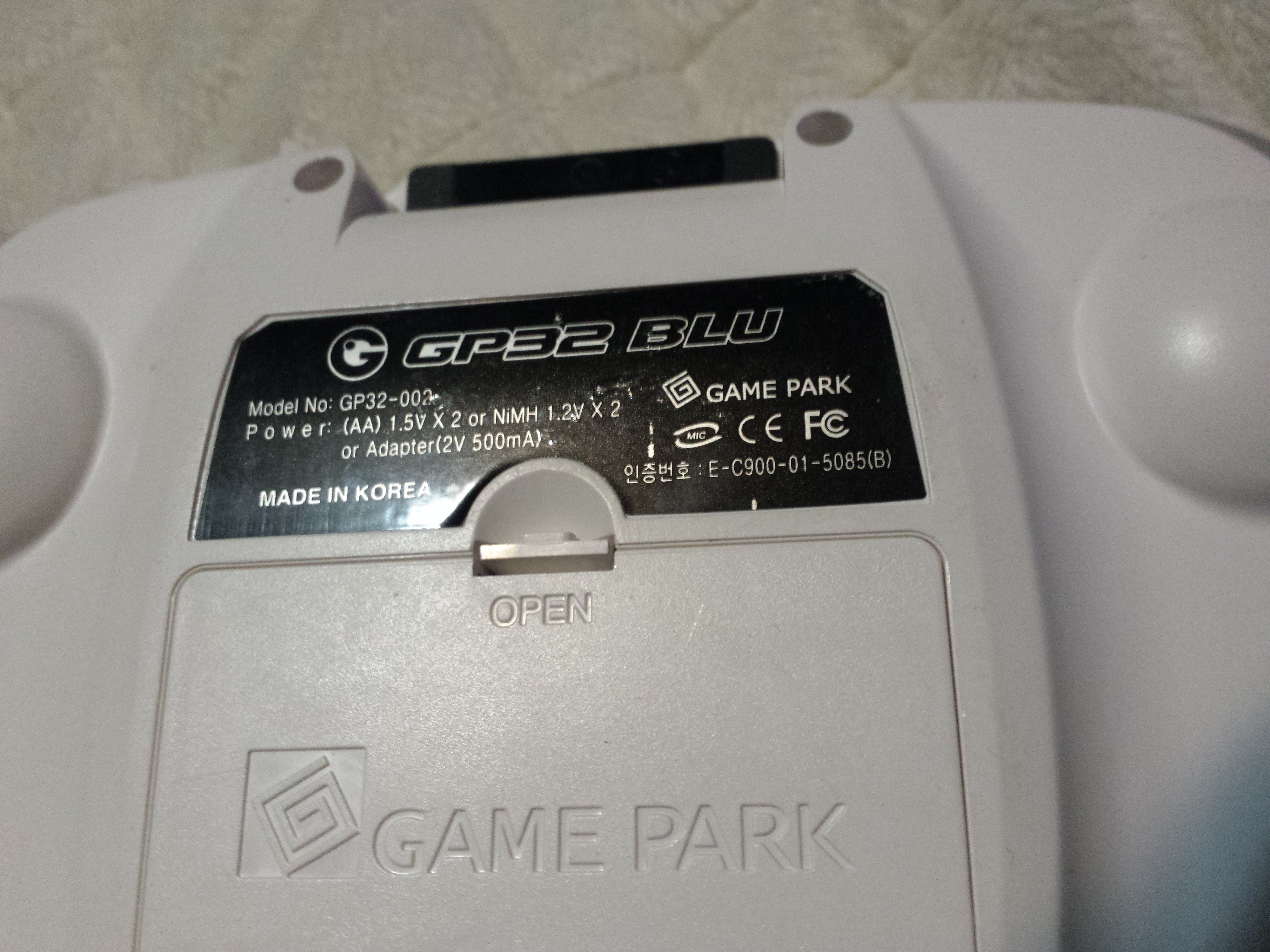

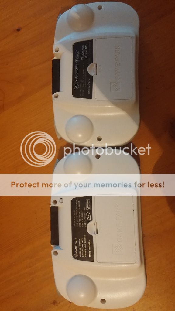

Optimus: Yeah, BLU and BLU+ just use select to control backlight, FLU is the only one with a switch. AFAIK: BLU+ has the made in korea written on the right side of the sticker on the back, whereas normal BLU has it written on the left and some korean and E-C900-01-5085(b) written on the right (number might vary). I'll upload some pics in a sec.... (this is for my BLU and BLU+ which are both GP32-002)
[doublepost=1452288362,1452287647][/doublepost]Here are the ever so slight differences on the back label.

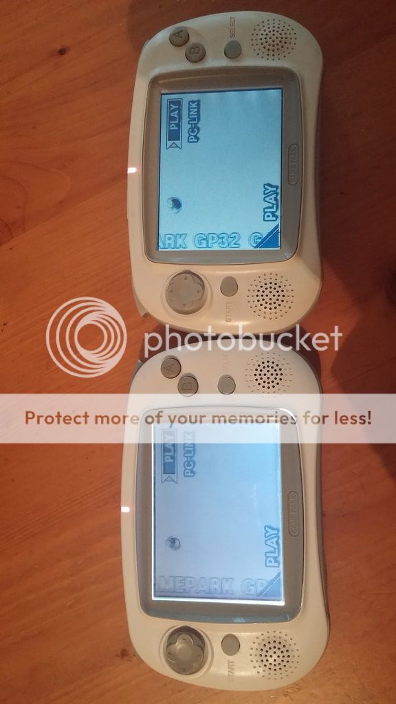

[doublepost=1452342415,1452339866][/doublepost]FLU on the left, BLU on the right.

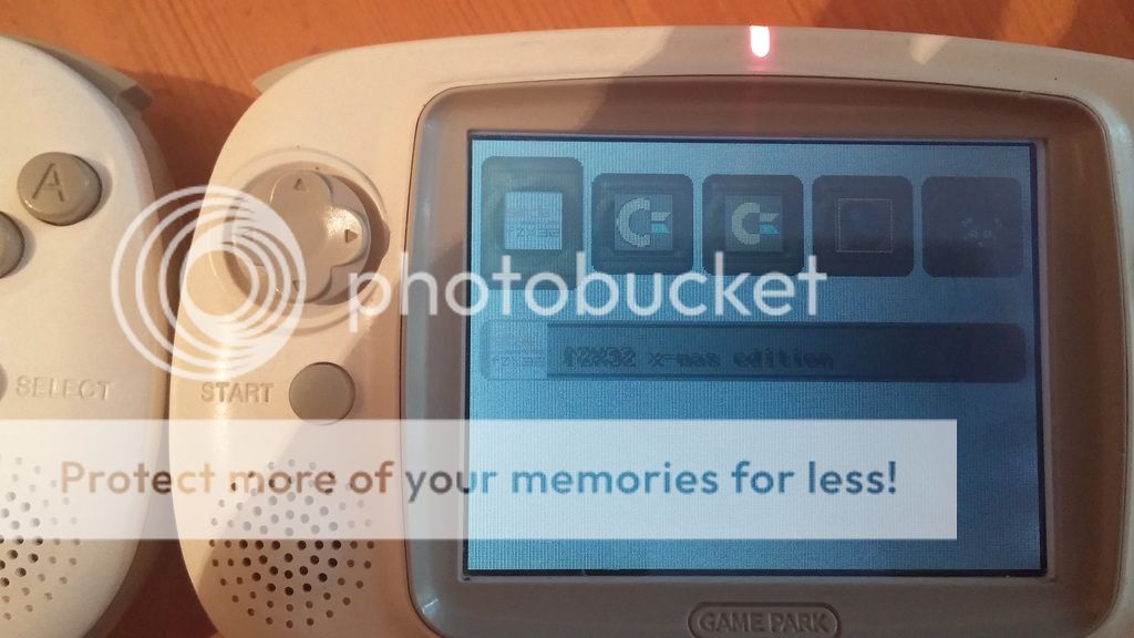

And the fail that just happened right now. What is it? Could I just open and fix it?
Inverted colours like that might be a quick on/off power cycle wound the LCD driver in a weird state (BLU have a ridiculously long power down). Maybe try removing the batteries and letting it sit a day, might drain the capacitors and allow LCD to get reset to proper settings... Worse case scenario BIOS corruption or wrong firmware flashed (BLU+ fw on BLU or vice versa can be bad...)
