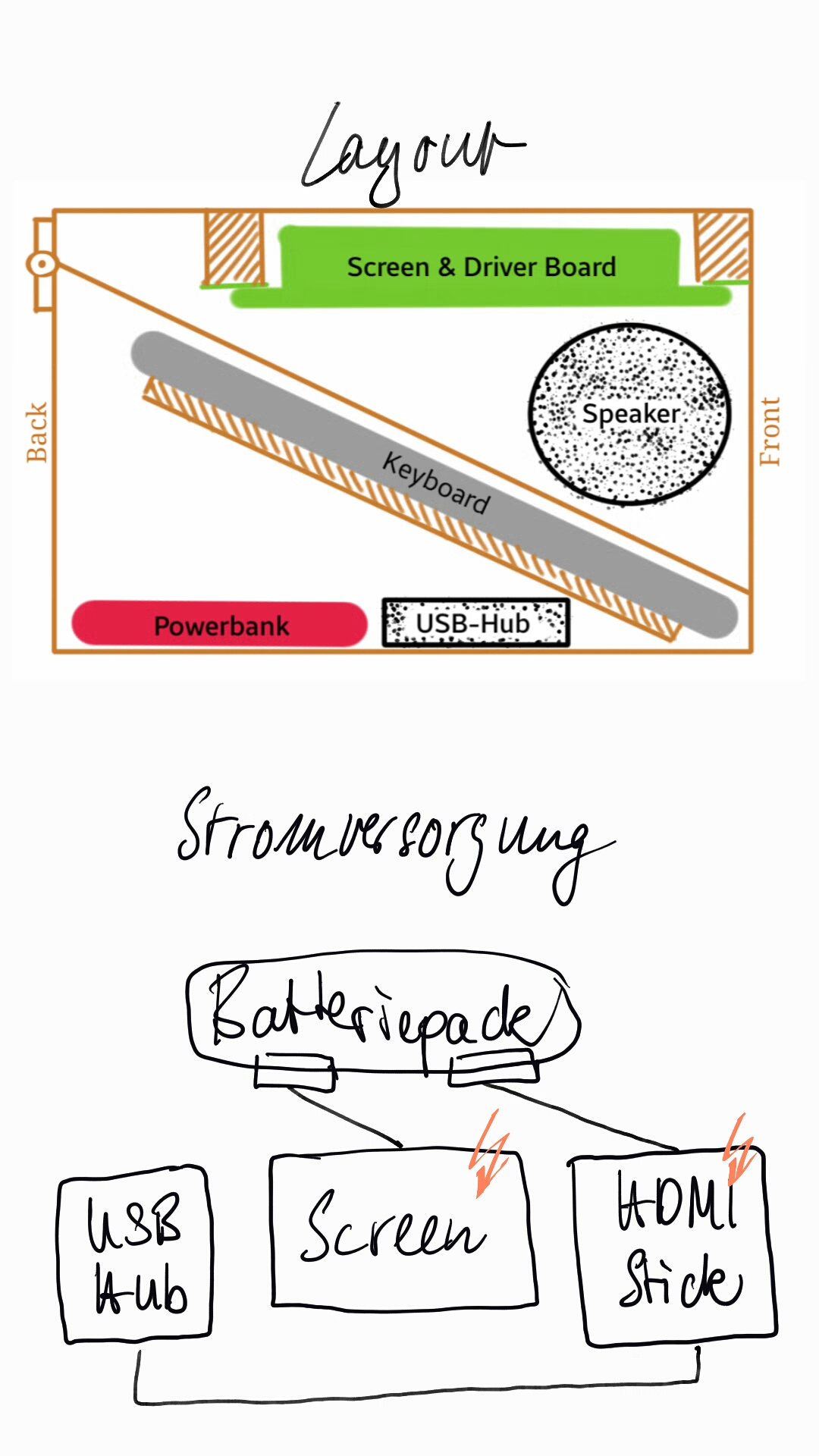

There's an HDMI stick PC I'd like to run off a powered USB hub.
USB 2.0 hubs deliver a maximum current of 500mA. To reliably run the stick PC I'd need about 800mA, which I'd get as per USB 3.0 spec - up to 900mA.
Q: Will a USB 3.0 hub expect some sort of identification signal from the PC's micro USB power jack and thus fall back to 500mA?

Maybe I'm just terrible at planning this. There must be a smarter way to do things.
I wanted to run the HDMI stick and the screen off a two-port portable powerbank AND connect a USB hub to the stick for peripherals. The stick's USB jack though delivers so little current that I need a powered hub, there's no way around.
I could get two of those powerbanks, that won't break the bank (heh). Still buy four Li-Ion 18650s, but two battery holders and split them up. Then I'd have four ports available internally. The power banks would have less load, produce less heat etc. Then I can just use any old powered USB 2.0 hub and be done.
Edit: Attachment below is old plan. Goshdarnit I love doodling things on the Note : D
