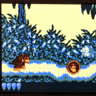

i have the whole suite of .emu emulators on my pandora and they all work fantastically EXCEPT GBC.emu, which has a weird screen tearing issue. I've tweaked every setting but it still does it. The tear is vertical and in the right half of the screen consistently.
I tried gambatte as well and it did the same thing which I found REALLY weird.
Gngb (I think it's called) is the most recently updated GBC emulator and it DIDN'T do it, but it's also nowhere near as polished to use (I really prefer the .emu ones). It's so weird that this doesn't happen on SNES or GBA, which are significantly more demanding.
Help? :(

Right, understood. I guess I was more surprised that I wasn't seeing anyone else reporting these issues, and so I thought it might be a system unique issue.
Is there a vsync option I could explore in a config file? It seems the config file is in the PND for the .emu release?
As a reference, I've tried to upload a gif off my iPhone (let's see if this works!)

Dude, great reco. I hadn't seen this one before and can confirm it doesn't exhibit that issue. I do wish I could control where its save files go, but with the OpenGL renderer, it seems pretty flawless.

Happy to help! :) I use a lot of .emu emulators too. Most are fine, but the GBC one does have a very prominent tear in it. I went through all the options like you did and couldn't solve it either! 8Blitter has been working well for me though.
Well, the GameBoy runs at an especially weird refresh rate (59,7Hz) which no LCD does support... so it's not easy getting it tearing free (Well, running at 60Hz would be an easy way, but then it would run a tiny bit too fast)
Ah. Thanks ED, I didn't know that. I'm even more impressed how anyone can get it working tear-free! :)
Us PAL gamers are well used to running games 6% too slowly on our weird TVs, and I guess we're now getting used to playing our childhood games 6% faster than we remember them. So playing our handheld games 0.5% faster should be a no brainer, I'd have thought!
Actually, I think 60Hz NTSC is 29.97 frames per second, aka 59.94 fields per second, so I expect 60Hz LCDs are actually that rate.
Edit: Though I misread your 59.7 rate as 59.97 so there's still a fair difference if you're right.
Edit2: Wikipedia confirms your number, but reckons a SuperGameboy displays games at over 61Hz field rate. No idea how it does that on an NTSC analogue TV. I guess it was always possible to overclock a TV to a certain degree. On the original PAL TV I used with my Dreamcast, the display would simply get shorter in '60Hz' mode, i.e. there'd be a black border at the bottom, and all circles would be slightly fat.

Ok, so, I'm a bit embarrassed to admit this, but during my pre-sleep web browsing ritual, I just saw that 72 is NOT the newest Pandora firmware; that we're up to 75, and that more importantly, that 74 introduced some major vsync stuff. Will update tomorrow and figure out if maybe this was user stupidity all along. If so, in my sheepish defense, it's beyond belief that this system is still seeing so much support years after its launch. I'm honored to have one of these.
