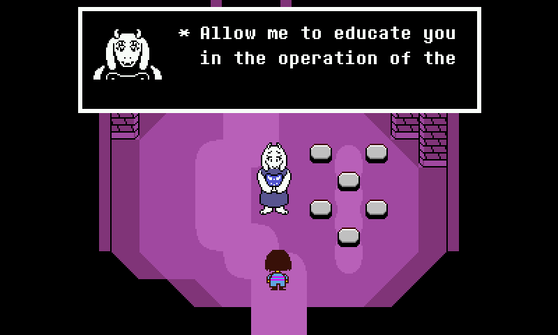

Here is a Launcher for Undertale, the RPG not like the other
This PND is a Launcher, so you'll need to copy the Full game data to be able to play. It will be abble to extract the data from Humble Bundle binary. Just launch the PND 1 time to get instructions.
The launcher use box86 and gl4es. Like with other GameMaker2 game (Locomalito ones for example), this game use GLES2, so may need to use latest SGX driver, and use a Swapfile on CC model.
Also, the game start windowed, no mater what, so press "F4" to go fullscreen.
