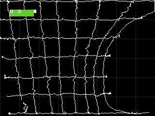

Hi everyone.
I am having a lot of trouble with my touchscreen, so i made a test program which shows how far off the calibration is. You draw along a grid shown on screen to get the actual touch screen result. Press any key to quit. Upon quitting, a screenshot is saved in the current folder. This is my result. So i was wondering, does anyone else having such a defective touchscreen?
Here is the download: http://dl.openhandhelds.org/cgi-bin/wiz.cgi?0,0,0,0,116,342
/Uni

Mine is getting worse. If a game has a button that is on the edge of the screen, no matter what I do calibration wise, I cannot click the button. This makes a couple games unplayable. =[

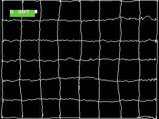

Here's mine
Most of the shakiness is probably down to my stylus use while holding the Wiz (rather than it being on a flat stable work surface), but overall it's not too bad at all.

That looks great. You can probably imagine, i'm jealous now ;) Seriously though, thanks for the image. It confirms my touchscreen is... quite broken!

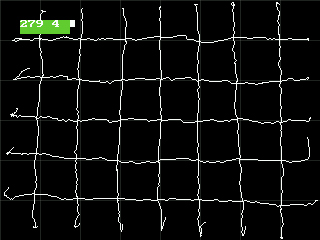

Here is mine.
A lot of (vertical) jittery on the horizontal lines.

I dunno about my Wiz but the touchscreen on my Nintendo DS has gone totally non-linear too and is therefore pretty useless. Wiz, on the other hand, should be capable of calibrating against this because the touchscreen should be abstracted in system software. Although this is non-linear it should still be correctable with a higher order polynomial. You'll get an uneven precision distribution though. And the calibration process will need way points. It's probably worth coming up with a proof of concept that recalibrates in the program against a better model.
