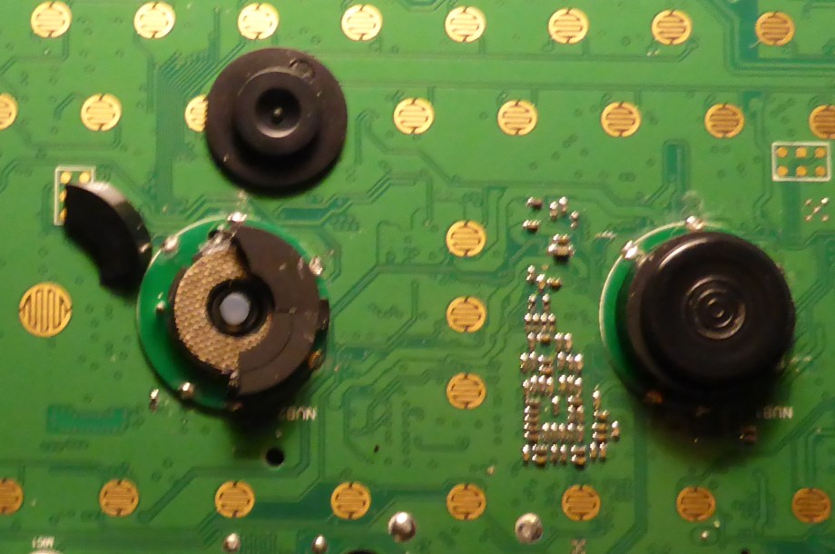

As for the nub, you can repair it if you are willing to disassemble it. Depends on how broken it is, but once opened you can lift the plastic frisbee, and get a small pole and round base;If you carefully remove the black round cilinder case around it (which is so brittle, putting it back is very hard). once you lift that thing, you have a look at the inners of the nub, those, clean, windspray, and the nub should work again for a while.

To get into the nub is actually hard if it is not broken. You need to desolder it, then in the hidden back there are these 4 black screws to keep the outer ring in place (mine is cracked at these 4 points and I have a very hard time keeping it together while I put it back in the case). Then remove the ring together with the black nub. You are left with a pointy white plastic mini joystick that can move. It is this thing that can be "cleaned" with air (by moving it around). So far, it works again for me, but pushing left is still erratic (so I use the stylus). copy/paste (up/down) is very hard. So if the black nub is still in place, blowing air is not that effective, you really need to nubdance while holding the air spraycan.
@levi: Read about nub disassembly at : http://pandorawiki.org/Nubs
