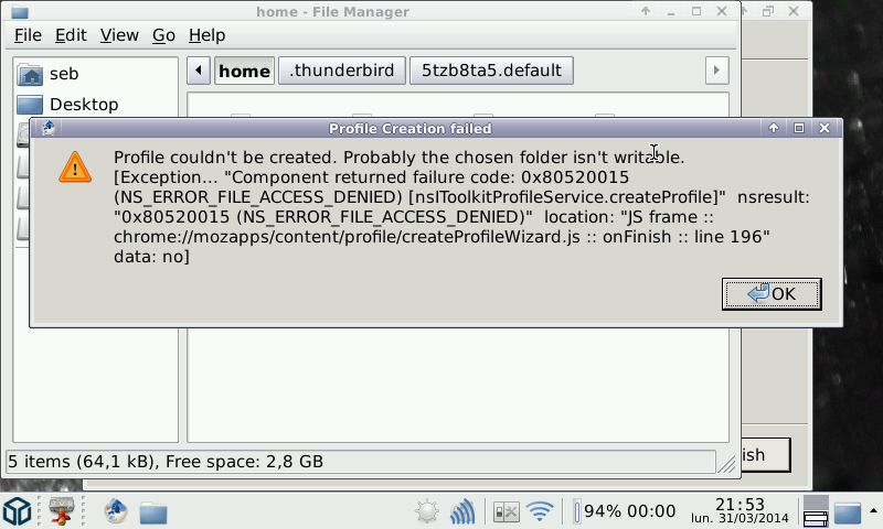

On first start, if you are on a Fat32 SDCard, you may have an error message at the creation of the profile (thunderbird_error.png). Just validate and ignore the error, the profile is created just fine.

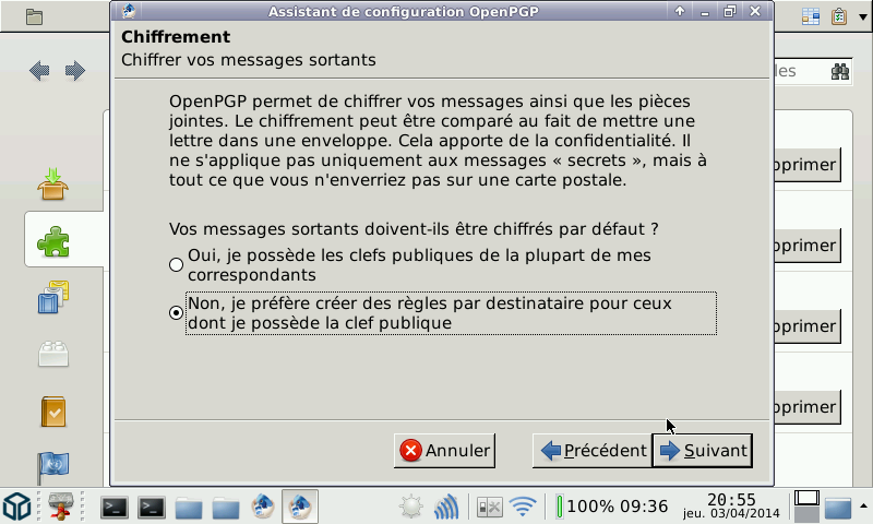

Enigmail for the Pandora is here: enigmail-1.6-linux-arm-gcc3.xpi.zip, it's a little hacked version to make it instalable on Pandora.
Seems to launch, but no idea if it really works (I haven't setup anything to do a real test).
I will publish an updated Thunderbird PND (with gnugp inside) and a hacked experimental enigmail.xpi soon...
Woohoo! Encrypted Thunderbirds are go!
So, I update the Thunderbird PND to add gnupg to the PND.
After updating to build 02, you can try enigmail. But you have to grab the hacked version I have posted in 1st post (the normal version won't install on anything else then x86).
I have no idea if it really run, I just now it launch, so please report sucess/ failure.

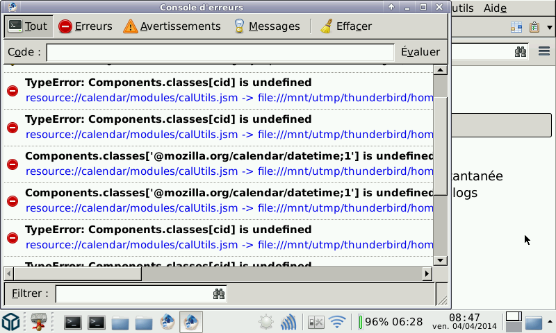

Oh YES! Mail works pretty good. But unfortunately Lightning plugin does not work for me :(
I can load the calendar-tab, but it is kind of broken (it shows the calendar toolbar twice and everything is greyed out). After switching back and forth (to inbox and back to the calendar tab) there is only one calendar toolbar, but still everything is greyed out. Also I can't change to week, multiweek or month view, or create or view any events ... I also tried the seperate UI plugin for lightning, same problem ...

Yes, I see that. It seems there are some undefined classes(lightning_error.png). Some things missing in my compilation? :( That doesn't look easy to fix.

About Lightning, I have no idea what I am talking about, but ... ;) ... it sais something about .js files, could it be a missing Java-support? Also Firefox can't run Java apps because there is no plugin for it?

JS should be present. It is compiled in. And don't mix Java and JavaScript. For Java, you will most probably need the Java PND installed and running. JavaScript should run out of the box.

That add on for enigmail *seems* to be working. It's not recognising my private key so I've not yet encrypted/decrypted any emails and I won't attempt so until Saturday when my fiancee is back just in case I bugger my key up and then I can't read her emails :P
But I will test Saturday when she's back and therefore if I screw up the keys I can just remake them :P
