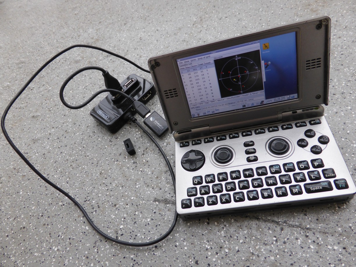

D'oh... I bought an USB1.1 GPS device... so I needed a hub that could throttle down to usb1.1, but still talk usb2.x to the Pandy...
Hardware bought:
GlobalSat ND-105C Micro USB GPS Receiver (comes with cable to connect to normal USB port)
extra hardware required: USB hub (mine is Sitecom)
Energy consumption
305 idle
321 usb turned on + hub connected (takes a few seconds of full power while initializing)
740 GPS dongle connected to hub
gpsd and modrana work like a charm. Unfortunately, modrana, when choosing bike and choosing a spot got me a 5 km route for a 1 km trip. In the Netherlands, most streets are bike ready, and it seems these bike lanes have to be explicitely defined to be traversable by bike... I see that, as it is openstreetmaps, I need to chip in to make them better.

* Setting up takes a while. You need to drop to commandline, do a dmesg, from there, pick up which port it connect to "now attached to ttyUSB0", because that is what you need to select in gpsd frontend. Start up is ok, but there seems to be a bug that when you come out of hibernation, the GPS selects ttyUSB1, however, even selecting that from the gpsd menu will still make gpsd use ttyUSB0... so you need to reboot to get it working again... bummer.

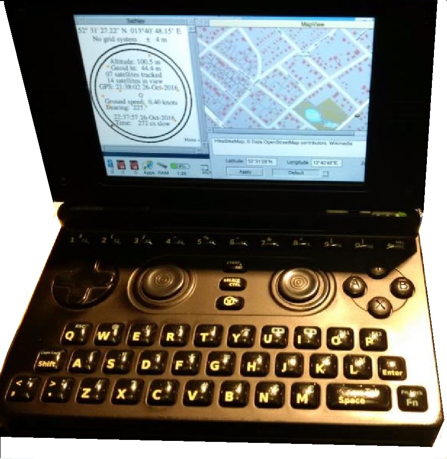

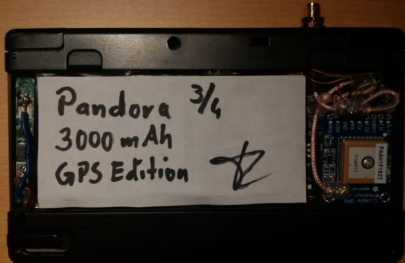

Have made a "GPS Pandora". 2/3-sized Battery and Adafruid GPS inside...
Is working with RISC OS. First try with gpsd and Navid not... no time for more.
P.S. I forget. The black rectangle at the right side is a WiFi antenna for a bit better and stable connection.

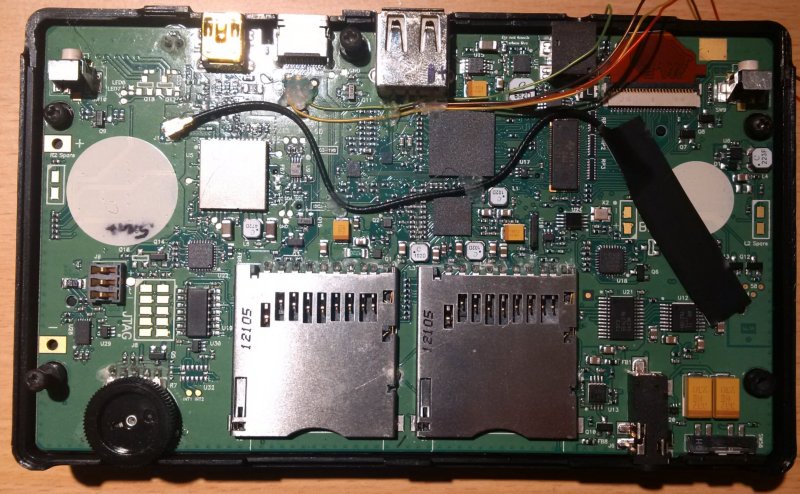

At first I have try outside. Have solder a cable (have any plugs from ED)...
Complete instruction take same time and my English is a shame.
Hey @Raik I am German so if you'd write up something in German I am happy to translate it for everyone else. I love how you wired it internally and would like to attempt that myself
@Raik sorry but no. I have been part of the international forum for over twelve years now, I will not switch to the german forum now ^^. that is exactly why I offered to translate a guide to English: so more people can have access to it.
I'll contact you over the form you linked and we can do this via email!

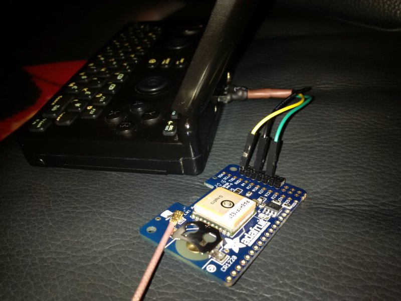

Isn't that putting 3V onto a 1.8V I/O pin? Though in 10 minutes I haven't managed to find out whether the module's TX drives the signal high or only pulls it down. Looks like the module's RX pulls up through a 10k resistor and a diode, which might be enough to stop it frying the Pandora in practice, but not sure if I'd count on it.
Not sure what you mean. I put the Pandoras 3V out to 3,3V breakout in. TX to RX, RX to TX, GND to GND and use it like a serial connection.
Works with my Classic (extern) and my GHz (intern) Pandora since more than one year.
According to the hardware hacking guide, the I/O pins on the Pandora are 1.8V. That note, and the warning, are even in one of the pictures in the document you just published.
As I hinted in my last post, maybe there are good reasons why it's OK in this case. But if you never thought about it, you've been lucky.
Upps, the time is running. Was 2012/2013 as I build...
Sorry, you're right but I thought about it then before I build. The points are highlighted in red in my paper.
I remember I was in contact with ED (?) or Notaz (?). Can not find the mails quickly.
I use a 3-wired solution and only TX on the breakout board. Is enough normally.
Maybe I find my old notes but not sure. I will look at and think about.
