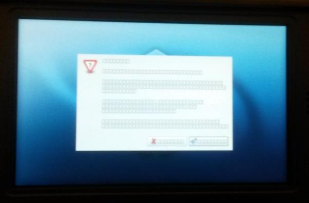

I'm trying to boot SuperZaxxon from SD on my CC unit. I did the following:
Downloaded http://openpandora.org/firmware/pandora-rootfs.tar.bz2
Formatted SD card as EXT2
As root on my Fedora Desktop, extracted the files onto the card (tar -xf /path/to/pandora-rootfs.tar.bz2)
Copied the example boot.txt from http://openpandora.org/firmware/README.txt to the root of the card
Symlinked /boot/uImage to the 2.6 one
When I boot from the card it looks like this and freezes. Where is my mistake?

For one the 2.6 Kernel is ancient, it's very possible there is some incompatibilities in a later firmware image when using the old 2.6 kernel. Maybe @notaz can chime in.
I tried with the other one (uImage-3) and it's still doing the same thing.
8GB Sandisk MicroSD. I tested it with F3 recently.
[doublepost=1457998607,1457995810][/doublepost]I started over using mkfs.ext2 instead of gparted, and added --numeric-owner to the tar command from the Slackware instructions just in case. It worked this time. So maybe it was one of those two things or maybe it was luck.

As TrashyMG suggested, it was actually the kernel (if first-boot fails, I can't expect to change to the other kernel and have it work *facepalm*).
Using the 2.6 kernel for first-boot corrupts the OS.
Changing to the 2.6 kernel after first-boot, it failed to boot up, but didn't break.
