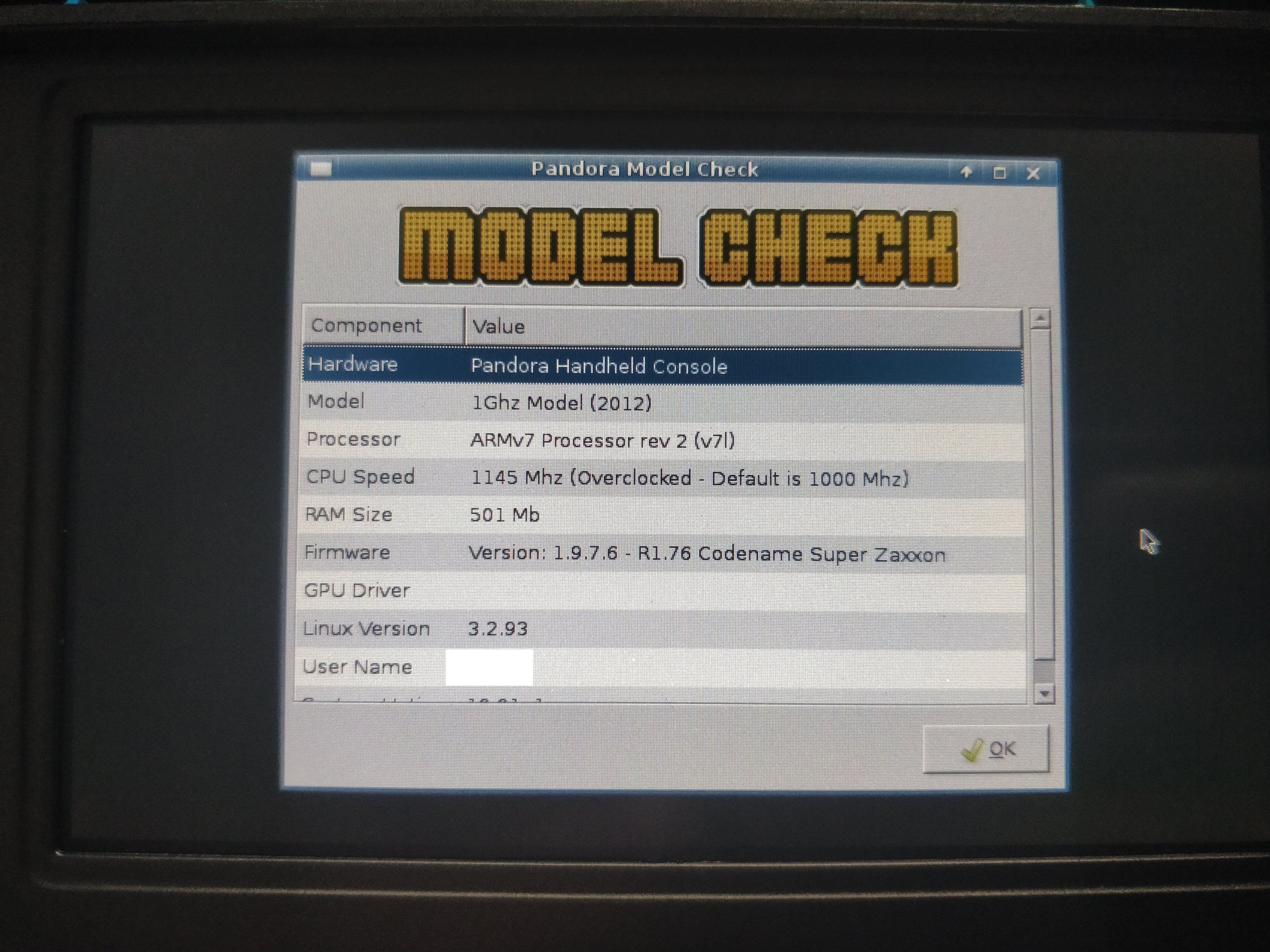

Hey I'm having issues displaying the GPU driver version, it appears to be blank for me.
Running on Super Zaxxon 1.76.
I've Included a photo of my screen.

Probably means you're on the default version that was installed when you upgraded your OS last. I've no idea why the tool can't match that version, but that's always been the way it's worked for me.
That might have been it, I'll check when I get home.
I was using it to add to the PPSSPP compatibility list thing.
I ended up updating my SGX driver to 4.10, so I know now what my driver is.
Still, I'll check that the model check is correctly seeing my driver version.
Mucho thanks levi.
