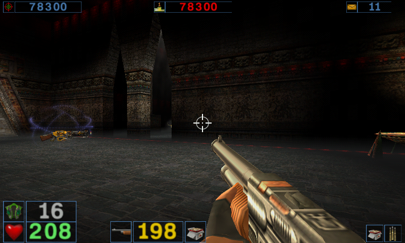

Here is Serious Sam: The Second Encounter (without data)
You'll need to copy the data from the original game (Steam, GoG or original CD version). Copy all the ".gro" files and all folders (but not the Bin one) in apddata/serioussam2 to play.
The game use gl4es, and use the recently opensourced Serious Engine 1.
The game runs ok on Gigahertz model, but is more demanding than the First Encounter. FrameRate are globaly a bit lower, but still playable. It's advised to use the latest SGX Driver for better performance and stability.
Some preconfigured config are there on first run, but fell free to play with the various parameters.
Build 08

Thanks. On build 01, I tried it on my Rebirth with a freshly installed newest SGX driver. It worked fine in the beginning where you walk in the grass towards the temple, but inside the temple the game glitched up entirely, getting stuck in walls etc. Could it be that the SGX driver doesn't work in conjunction with a Rebirth model in this particular game? Played Diablo 2 perfectly afterwards, but maybe that game doesn't rely on the driver.

Same issues here (build 3) on a Rebirth unit, OC @ 1GHz, SGX driver 4.10 :(
That Second Encounter is much slower than the first one, but it's still playable though...

I gave the game another try, this time with @notaz ' Live system info:
- beginning (waterfall): ~15 FPS
- first monsters in the valley: ~10 FPS
- first werebull (depending on where you are and how you play): ~5 FPS --> GLITCHES (screen split in two, etc...)
- temple in sight: ~12 FPS
- monsters in the temple's yard: ~10 FPS
- inside the temple: ~25 FPS and more (the second time I played, the game didn't glitch in the room with the guy and his chainsaw...)
- tunnel and second part of the valley: ~10 FPS (sometimes more, sometimes less...)
So the game appears to glitch randomly, depending on the FPS you get. Most of the time, it will glitch around 5 FPS... Worrying about the framerate makes the game less interesting to play IMHO...:( I hope you'll find a way to improve the performances on CC and Rebirth units, even though I know it's easier said than done :)
