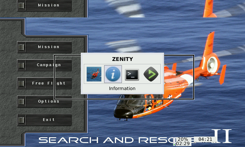

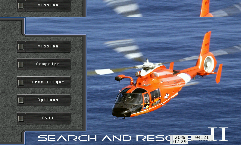

So, I cleared out the appdata and rebooted (the appdata only included an empty home folder anyway)
^ That's what I see when I first launch the game. As you can see, window furniture gets redrawn over the top of it, suggesting I'm still in the desktop.
^ Indeed I can alt-tab to other processes. Quite often when I alt-tab away and then back, that top bit where the screen is repeated, in those screenshots doesn't get redrawn. There's a window titlebar saying 'search and rescue 2' at the top, but between that and the redrawn part of the screen is the existing window from behind it still showing.
