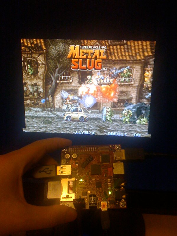

The thing I was most happy with was the way gngeo runs and plays with a PS2 controller. Playing Metal Slug on my beagleboard was quite the moment :)
I took a pic:
