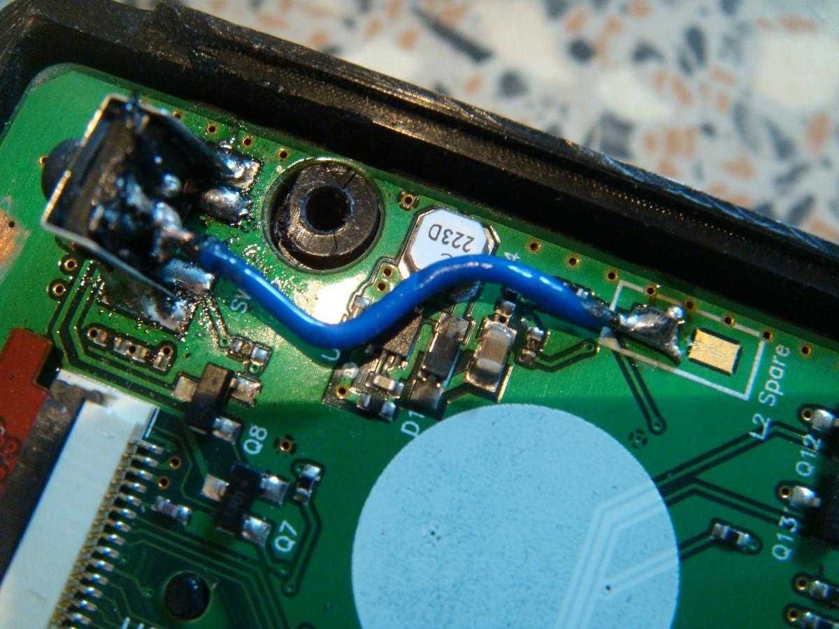

I changed my L1 button, 'cause it was always on.
Unfortunately, it's not related to the switch.
So i resoldered the left L1 pin to the upper L2.
My L button now activates L2.
When i push L, i print the '+' character.
1- How do i disable the still always pushed down L1 ? This is annoying when in pure console, 'cause shift is always on.
2- How do i change the L2 from '+' to 'shift' ?
Yeah they're both the same now.
I read on the manual it's the 97 gpio code, but i don't know how to use this information.

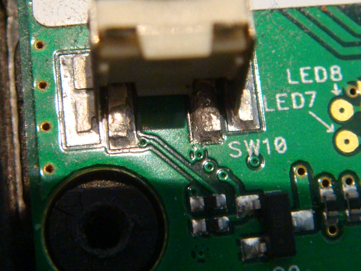

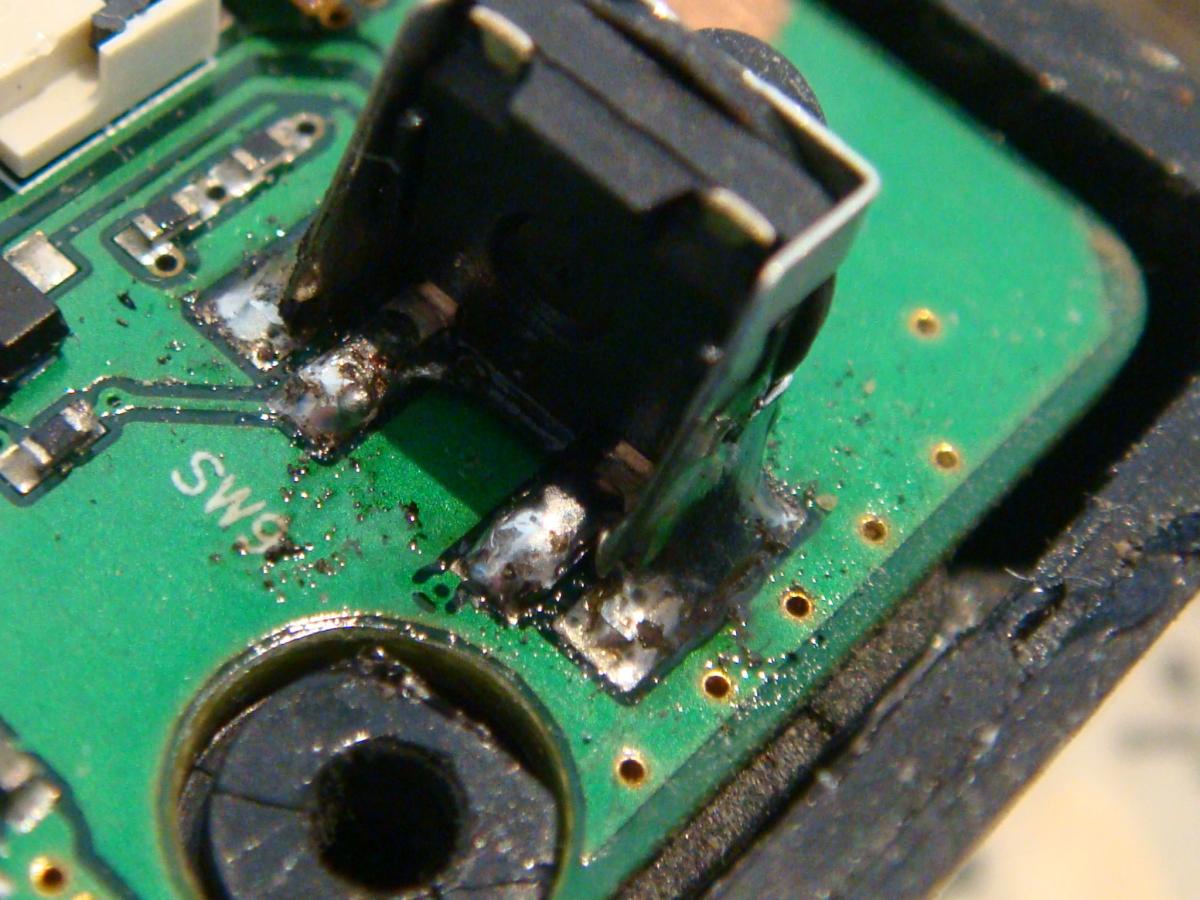

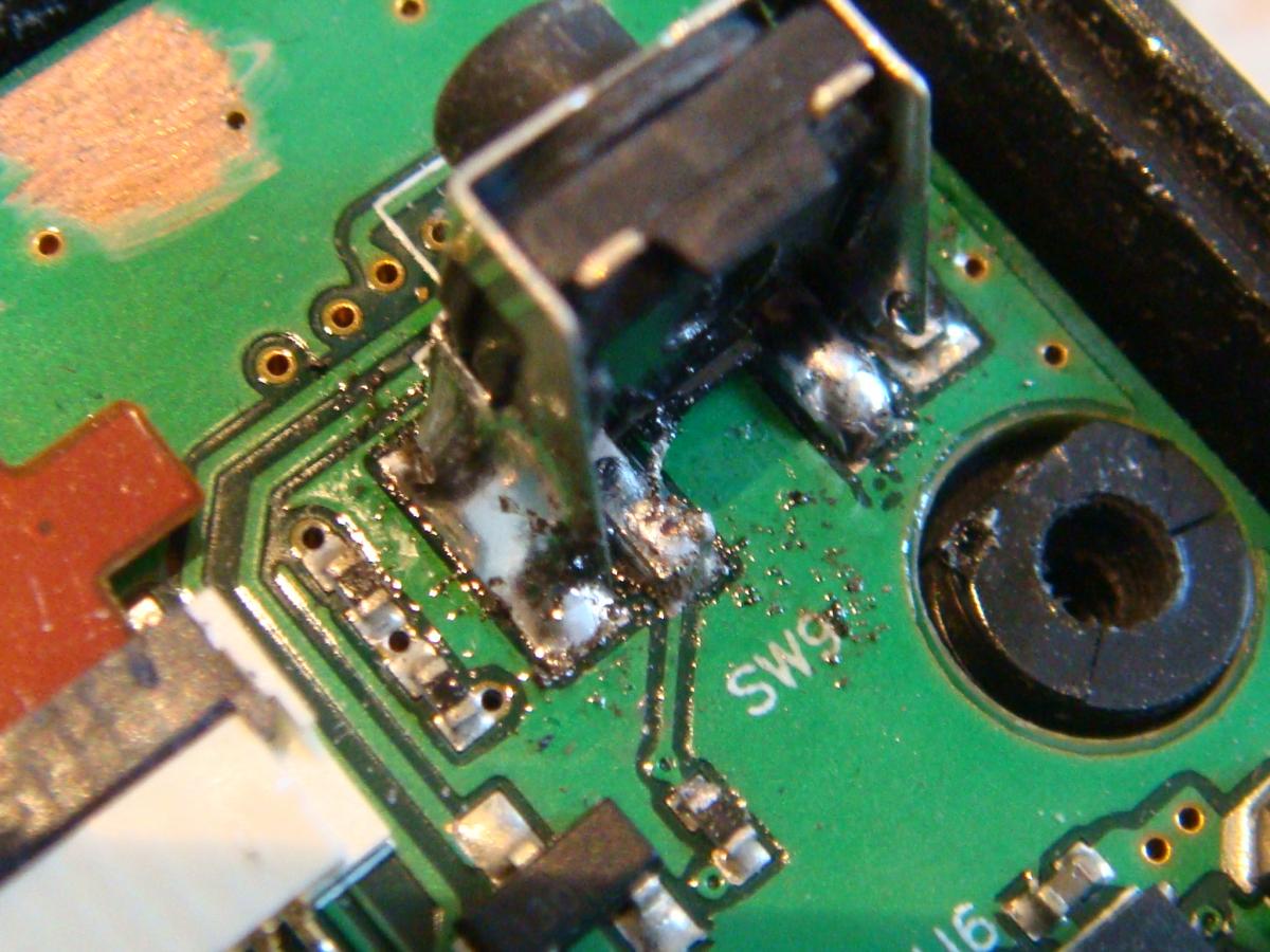

Some pictures:
