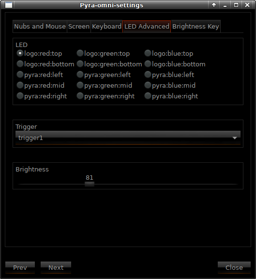

So I've used my semester holidays to learn a little about Linux and GTK programming.
I made a simple settings menu for all the Pyra specific stuff that's not within the MATE settings menu.
It's written in GTK and C.
So far it includes:
- Keyboard and Screen backlight brightness
- LED Trigger and brightness

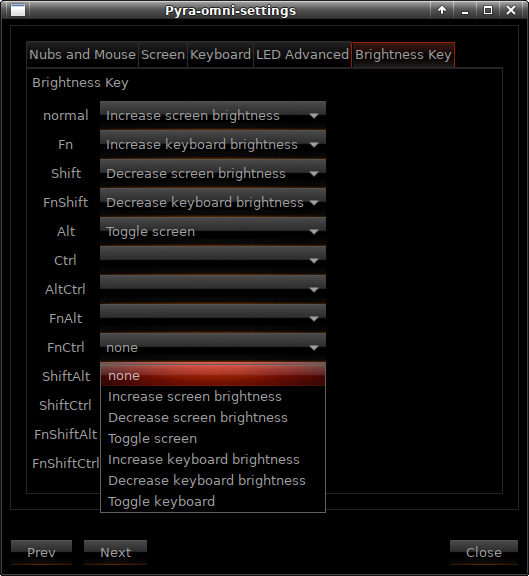

- Brightness Key shortcut customization (needs to add an interface for custom commands)

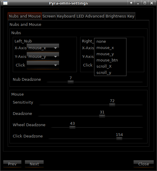

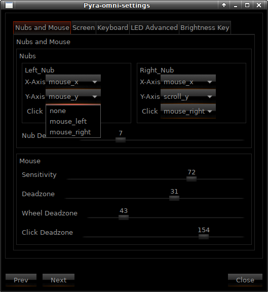

- Nub Settings

Another option class for the Brightness key assignment list: Software volume control
Master volume, headphone volume, speaker volume, hdmi volume, bluetooth volume (did I miss any?)
Another device to govern: The "Volume wheel". It could have the same dropdown options as the brightness button. It could even be subjected to modifiers (Fn, Shift, Alt, Ctrl, Super)
Would there be any interest in having the left/right versions of the modifiers being capable of different results when used in combination with the controls? I.e. keyboard Super + volume doing something different than lidswitch Super + volume.

You'll want to use more and consistent padding, left aligned labels and right aligned controls for the most part.
Related controls should have a consistent look. The lengths of the slider bars on the nub tab are all over the place.

Some of the options are very verbose. The LED selection could be split up in their position and have a color mixer for example.

I did not implement the backend. Nub and Brightkey options simply read and write a file that's loaded by sebt3's pyrainput daemon.
I can see that. This is something I need to improve.
I've read somewhere that GTK can use CSS. All I use now is Boxes and Grids to place the elements.
For me it looks ok. I'm not a designer like you are ;)

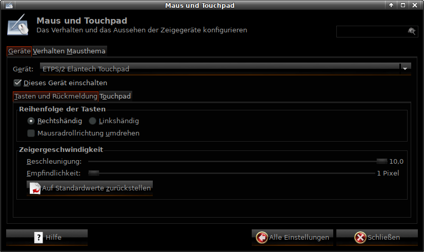

It looks completely different when I use a different theme. On my computer it fits perfectly to the XFCE settings. (See the attached picture.

Unfortunately the LEDs are not nice to control.
You can either set a trigger or a custom brightness for one of the main colors (Red Green Blue).
If a Trigger is set it is always at max brightness. So I cant set a trigger for any color like that needs let's say 255 RED and 100 BLUE. The driver does not allow that...
I've also thought about the color picker to set a brightness. I have to look how it's done.

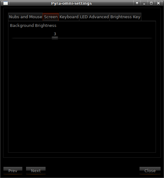

It might be nice also to have to option to set the screen backlight to a specified brightness with a single press - people could use it to set it to minimum brightness (but not off) when using the device in the dark, without blowing out their night vision completely.
I also had that idea. My brightkey.sh script already supports things like "brightnes up 5" so it increases the brightness for 5 levels. Also it can do "screen set x" so it sets it to level x.
I want to add a third column to the brightkey tab to set how much it will increase the brightness and to add an option to set it.
Good you mentioned it. I did forget that I already added the set function ...
Max and Min should be an easy option (set 1 and set 10 or whatever max will be later).
And one option to add a custom command.
Seems like that menu will keep me busy for some time.
I wanted to add the most important features first. More can always be added later even after release.
I was referring to the border around the tab control. You know, that line you can see right below the title bar.
The LED driver seems weird to me then. I thought the point was to be able to set different colors for different events.
I only did simple brightness settings when playing around with the logo LED at last year's Gamescom, so I wasn't quite aware of that. Color picker for that? ;)
A color picker for the just the brightness would be kinda weird, though.
Yeah That should be the case. The /etc/defaults/leds config file you should be able to specify the LED color of the RGB LEDS. It looks like he's parsing the lines from that config file. It looks like the RGB LEDS are broken up so you can control each color & brightness individually.
Exactly.
It is like having one Red, one Green and one Blue LED.
I can add the same trigger for Blue and Red to get a very bluish purple but that's it.
