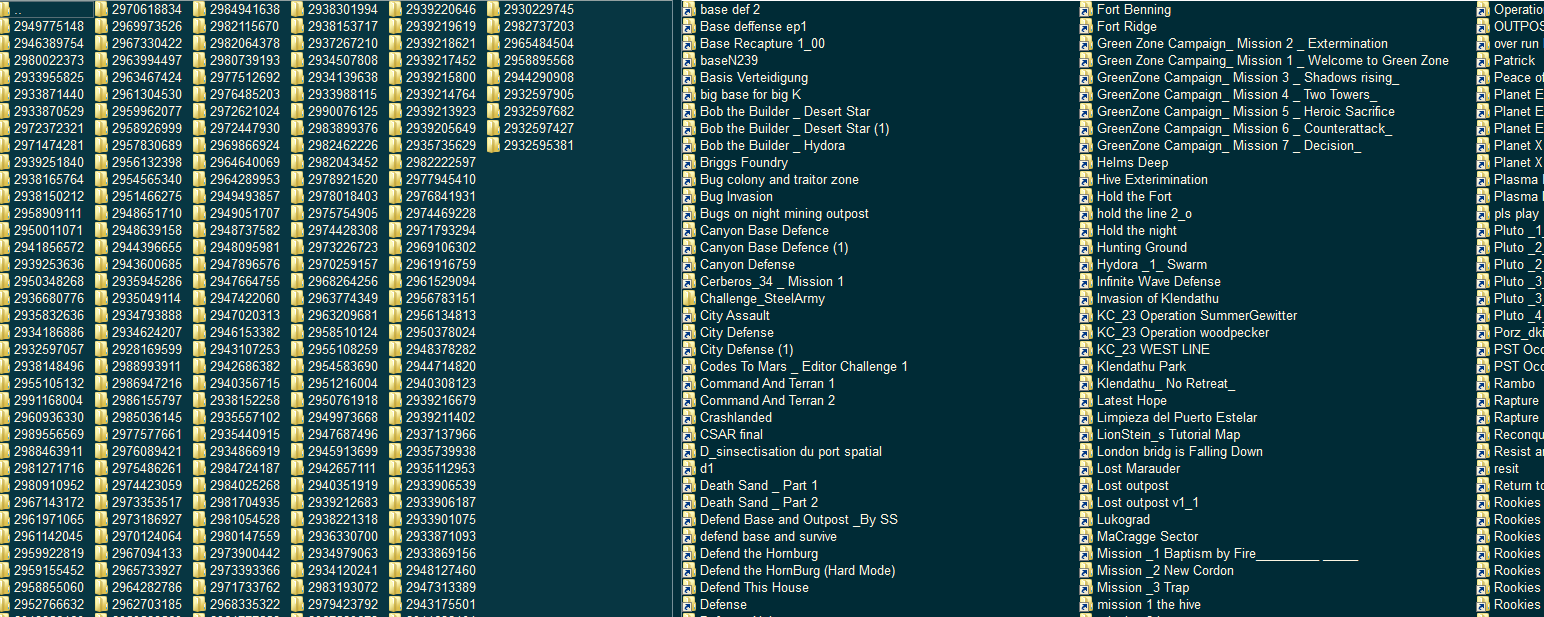

About the second issue, the Steam Archive format, I made a PowerShell script to:
This is a comparison between the SteamCMD folder structure (left) and the respective junction links (right) created in the game folder (this was a run with hundreds of MODs !!!
- launch SteamCMD with the script you choose (like the one in the previous example), to download/update all the MODs of a game
- massively create junction links of all the MODs, into the game folder, naming every link with the MOD title (instead of the SteamID)
- you don't have to physically copy folders from the SteamCMD repository to the game directory
- SteamCMD will be always able to massively update all the MODs
- while inside a game, browsing for the MOD to use, you will see folders with understandable names
