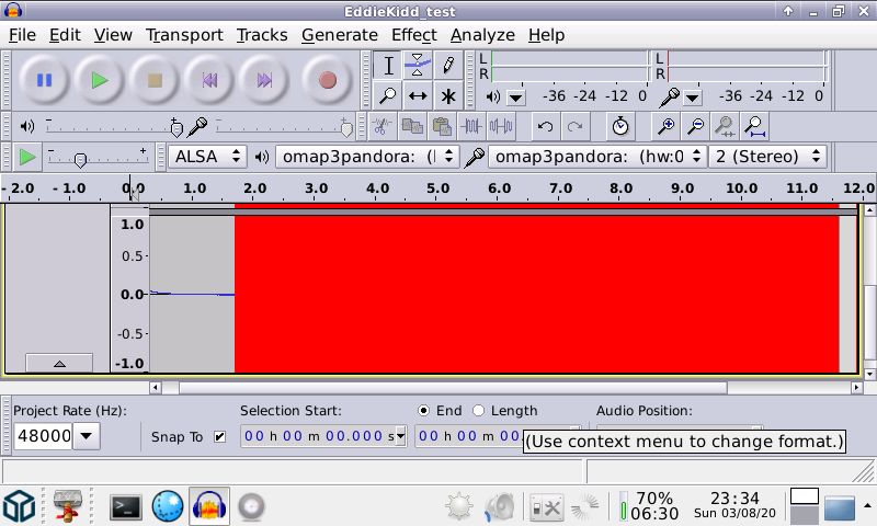

In Audacity, the signal is clipping. The red is Audacity's "show clipping" view.

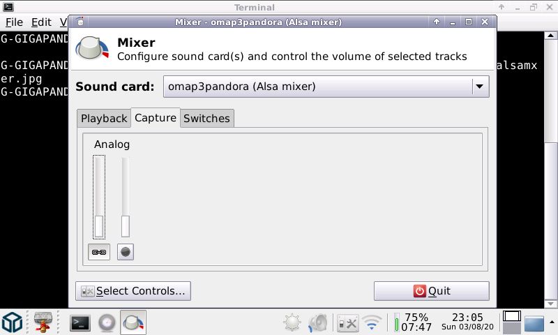

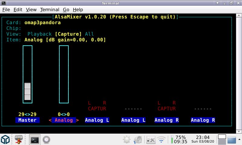

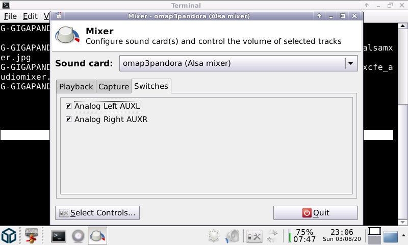

As pictures speak a 1000 words, etc., I have attached shots of alsamixer that shows that volume controls for the line in are not available. The mics I have disabled.
It seems to me that there is input gain on the hardware, that is configured somewhere in Alsa on the pandora.

Ah okay. Sorry, I was thinking it was an output problem. I've recorded radio programmes off an old PVR and on to my Pandora back in the day, and I heard no clipping on those. I think the problem may be due to the signal recorded on the C64 tape. I don't think I've ever heard one of those, but I've heard plenty of ZX Spectrum and BBC Micro tapes so I assume they all use two tones (apparently known as FSK) and they're recorded pretty damn loud, for reproducibility's sake.
