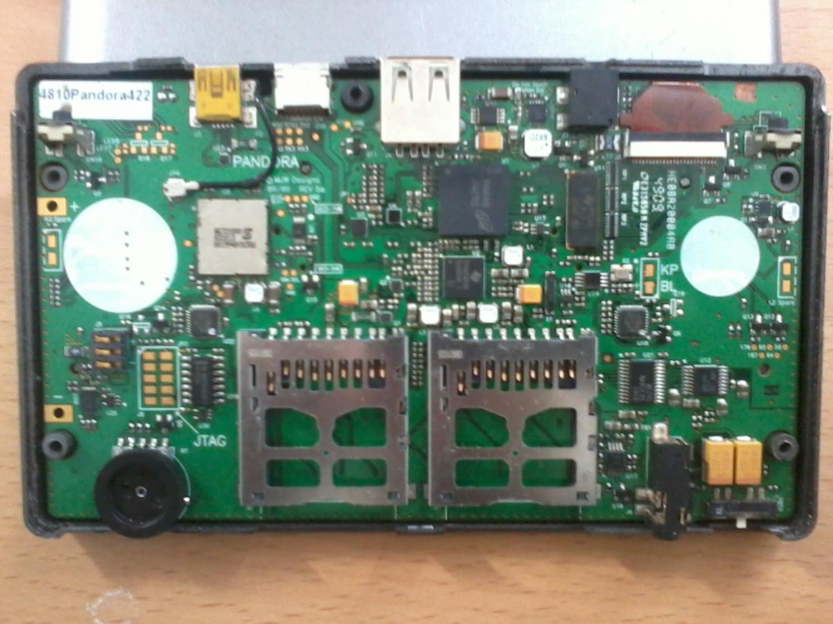

Opened my Pandora and there doesn't seem to be anything loose - pushed the coil and other objects on the board but everything seems firmly attached. Attached a picture of the board, sorry for the bad quality.,
Behaviour is now pretty consistent. After a cold boot (not playing with it for >24 hours) it works fine for a few minutes, but then the problems start with flickering / hanging and automatic rebooting. Test program squared.
It's rebooting as well? Battery alignment is the usual culprit when it does that in isolation, but as it's also hanging and causing visual artifacts, and it only seems to happen when the system is warm, I suspect a dry joint somewhere.
Your photo is a little blurry, but I think it says that board is a rev. 3a. I think my Ghz unit has a rev 5 board (although I haven't had it open recently - I might be getting mixed up with the LCD cable revision), so I suspect yours is a CC unit - is that right?
Yes it is a CC unit. I doubt the battery has anything to do with it. I have also played it while continiously pressing the back, same thing happened. It also happens if I just let it stand and not touch it at all. Pressing the back while it is flickering does seem to do something though (makes it worse or temporarily better), so indeed a dry joint / bad connection on the board could very well be the root cause.
