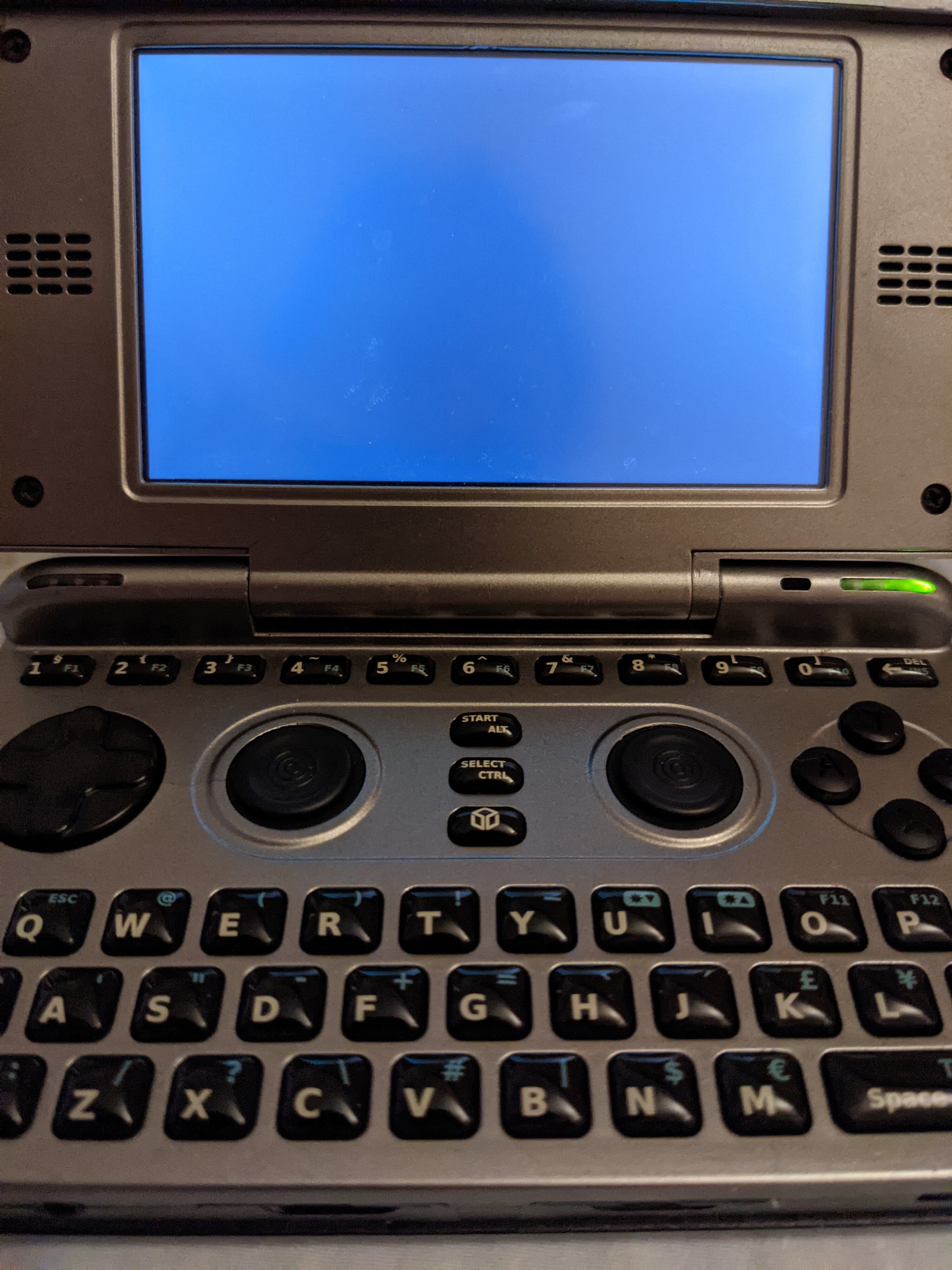

Hi all,
After a period of no use I decided to boot up my good old pandora, but sadly I was met with a black screen.( A lot black screen, if you know what mean) green light is on. I've tried fn and brightness and moving the lid back and forth bring no changes.
Any advice suggestions would be greatly appreciated.
Edit - the screen looks blue in the photo but it is black in reality.

That's like the opposite of the common problem (backlight failed but there is actually stuff on the screen). Try powering it on holding the R trigger and see if you get the boot menu?
Its hard to describe but it turns on to a black but lit screen that goes completely black after sometime of inactivity.
