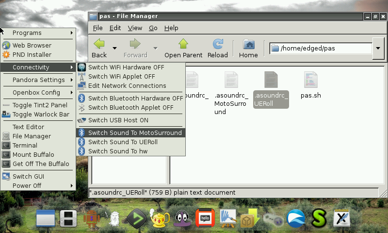

  • Switch your system's default audio output with ease and almost zero config work
  • Have as many bluetooth or hardware based audio devices as you like
  • Have a simple menubar toggle to click-switch audio output
  • Entirely "onboard" ALSA based (no further dependencies)

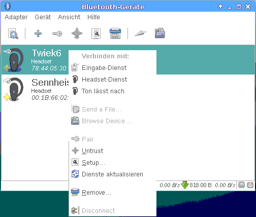

  • Find your device's MAC address:
    Enable bluetooth on the pandora and activate your bluetooth device (e.g. your headset) so it can be found.
    On the pandora a window should pop up, the bluetooth device manager:
    If it doesn't pop up, open it manually with:
    Code:
    blueman-manager
    You can also use:
    Code:
    hcitool scan
    Code:
    hcitool con
    Search for devices and write down their MAC addresses -> XX:XX:XX:XX:XX:XX
    Do not pair with them yet!

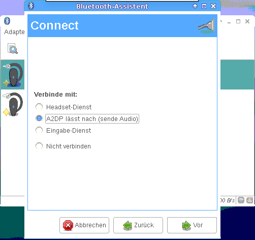

Pair your devices
Open the bluetooth device manager again.
Right-click on your device. Click on "Setup":
Connect using the A2DP protocol.
If you're asked to enter the PIN code, try: 0000
If that doesn't work go study your device's user manual.
Hopefully your device gets connected. Click the star button to "trust" that device.

I've not tried this tool yet, but as far as finding MAC addresses, the bluetooth GUI in SuperZaxxon doesn't show them for long enough to copy them down, and I don't see a way to get them back. (Is your screenshot from Slackware?)
Anyway, the easiest thing is to enable Bluetooth and then type "hcitool scan" in a terminal. This lists all the MAC addresses and names of pairable bluetooth devices nearby.
Also, "hcitool scan" sometimes does not return devices you are in an active connection with. If you already connected to your headset and "hcitool scan" does not show you what you want, "hcitool con" will list your active connection types along with their MAC address.
[doublepost=1459121320,1459094877][/doublepost]Does anybody else run Openbox?
Since kickass was so great in providing the script/framework that everyone can use for switching asound config files, I decided to integrate the script into my openbox menu configuration. My configuration checks if you have the script installed to "~/pas/pas.sh" and if you do, it reads all the .asoundrc_* files you have saved there, and lists them as options in the Connectivity section of the menu.
Simply replace the togglemenu function in /usr/bin/openbox-functions script with the following:

    if [ -f ~/pas/pas.sh ]
    then
    echo "<separator />"
    for asiter in ${asoundoptionarray[@]}
    do
    echo "<item label=\"Switch Sound To $asiter\" icon=\"/usr/share/icons/hicolor/32x32/apps/bluetooth.png\">"
        echo "<action name=\"Execute\">"
            echo "<command>~/pas/pas.sh -o $asiter</command>"
        echo "</action>"
    echo "</item>"
    done
    fi
