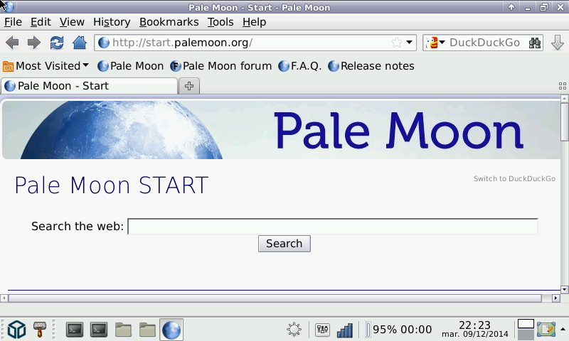

Here is Pale Moon, a browser based on Firefox, but removing less used function to gain as much speed as possible.
You will need a recent version of the Firmware for it to work (like 1.62RC minimum).
Note that, on a Fat32 SDCard, the creation of the Profile will have an error, but the profile should be created. fixed on build 02
Note2: WebGL doesn't work for now, I'm working on it.: fixed on build 02

Pale Moon is featured on Pandoralive: http://pandoralive.info/?p=4396
Source code is here: http://ptitseb.openpandora.org/palemoon.tgz (outdated) and the diff over official git is here: http://ptitseb.openpandora.org/palemoon_pandora.diff (up-to-date)

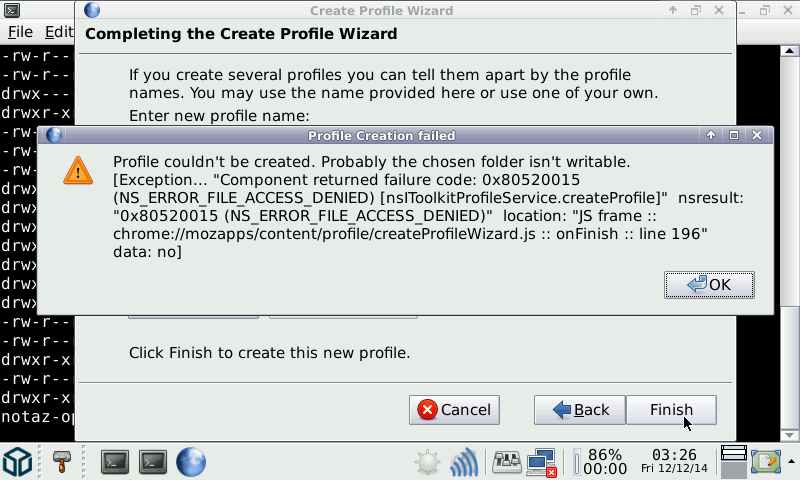

There seems to be an option to import existing firefox profiles, would be very handy, especialy when it also means to import the plugins from existing FF installation. Anyone successfuly tested this on the Pandora yet?
For whatever reason it fails to create a profile for me. I think I saw somebody reporting this issue for firefox, but firefox works fine for me. I've checked my card (fsck and all) and it seems fine (normal FAT32), files can be written without problems.
^ did it actually create a profile correctly despite having the error?, one of Ptitseb's notes in the first post makes mention of this.
I will look at that creation profile error.
In the code, I found this:
        if (NS_FAILED(rv) || !profileDefaultsDir) {
            // if copying failed, lets just ensure that the profile directory exists.
            rv = rootDir->Create(nsIFile::DIRECTORY_TYPE, 0700);
            NS_ENSURE_SUCCESS(rv, rv);
        rv = rootDir->SetPermissions(0700);
#ifndef ANDROID
        // If the profile is on the sdcard, this will fail but its non-fatal
#endif
So I guess I will use ANDROID path just here (just change to #if 0) and it should solve the issue :P
